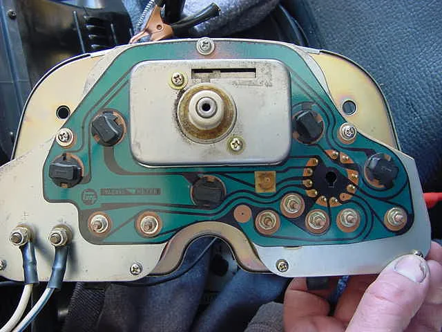

Question(s) for the electrical guru's out there??
My fuel gauge and coolant gauge are still not working. I was playing around with it today, but not getting it and struggling.
From the wiring schematic I have oil, fuel and coolannt gauges are fed off of the blue/red wire coming into the speedo head. I have power on one of the threaded posts on back of the speedo head for the oil presure gauge. I have power to one of the threaded posts for the fuel gauge. I have no power to the either of the threaded post's for the coolant gauge.
Oil presure works, fuel and coolant do not. I have the yellow/green wire hooked upto the coolant temp gauge. I have the yellow/red wire hooked upto the fuel sending unit. On the area of the wiring harness there are 2 white/black wires coming out of the harness next to the yellow/red for the fuel gauge...I have both of those together running to ground on the fuel sender. I also tried running a ground wire from the negative post on the battery to both of those white/black wires on the sending unit.....nothing.
On the back of the speedo head, if I bring the hot threaded post for the fuel gauge to the threaded post across from it, the fuel gauge works..but, not the coolant gauge. I also tried making a jumper wire from the hot threaded post on the fuel gauge to the threaded post directly above and between the 2 post on the fuel gauge....I believe that threaded post runs to one of the other threaded posts on the coolant gauge. Both coolant and fuel will rise, but they are not accurate and are basicly spiking the needle to the top.
I am assuming the 2 gauges are some how connected, just not sure how. Maybe has something to do with those 2 - white/black wires coming out of the hareness with the yellow/red for the fuel sending unit in the tank???
Anyone....bueller.....????
Thanks, Matt
attachment.php
In this pic look at the terminal at 6 o clock....the torquoise shade is current path, the 2 terminals inside this are tied together..the black lines on the back of the cluster are open sections that isolate the copper layer that transmits voltage......or if you understood this, disregard
I keep a spare cluster at the shop I know works, first thing I always do is plug it in....
Matt,
Sounds like a bad fuel gauge or sending unit if you have power to the post. Continuity checked OK on these two?
No power to coolant post -->...may want to check for continuity from female pins on the harness connector with the other end of the harness wire to check for a brake on the solder inside the connector, if you haven't yet done so.
Not sure I helped any. Good luck,
Ricardo
