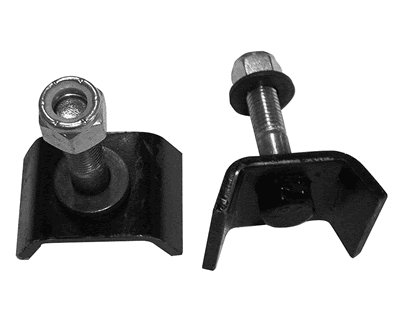

Something like this for the lower mount?
