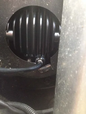

May not add to the HP, but Installed some new 7" round replacement LED headlights on the shop FJ 40. Soldered in some H4 plugs to allow for plug n play type harness. Then cleaned up the rings and buckets before applying some fresh black paint. Also had to notch the bib section some to allow the wiring from the light to pass without being in a bind, which could possibly lead to cut wire. Finished up with some new stainless hardware and dielectric grease.
