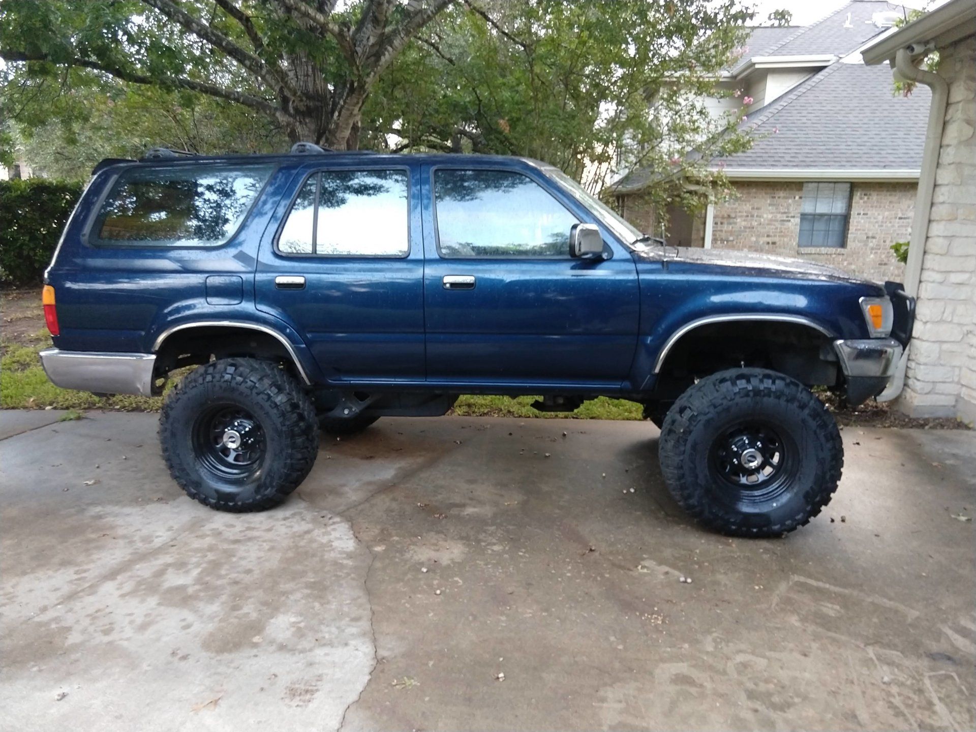

Hello, i just recently picked up a 93' 4runner and it is built up with the exeption of diff lockers and body armor. and it has proven hard to find any information on 2nd gen 4runners let alone about the diff lockers. i was wondering what any of you guys had done in regards to diff lockers. or some brands that you would recomend, or maybe a ballpark price range for front and rear selectable lockers. thanks!
No 2nd gen Toyota pickup/4Runner ever came with a factory locker AFAIK. I think the first ones came out around 96 on the limited model 4Runners and some Tacomas.
You can fit an e-locker that's out of any Toyota with an 8" 3rd member. To make it fit you will have to notch the axle housing and then run the wiring and a switch to engage it. Expect to pay a pretty penny for an e-locker setup and they usually go pretty quick. Your truck has the 7.5" front diff and there are a few lockers online for those, a quick google search will show you some.

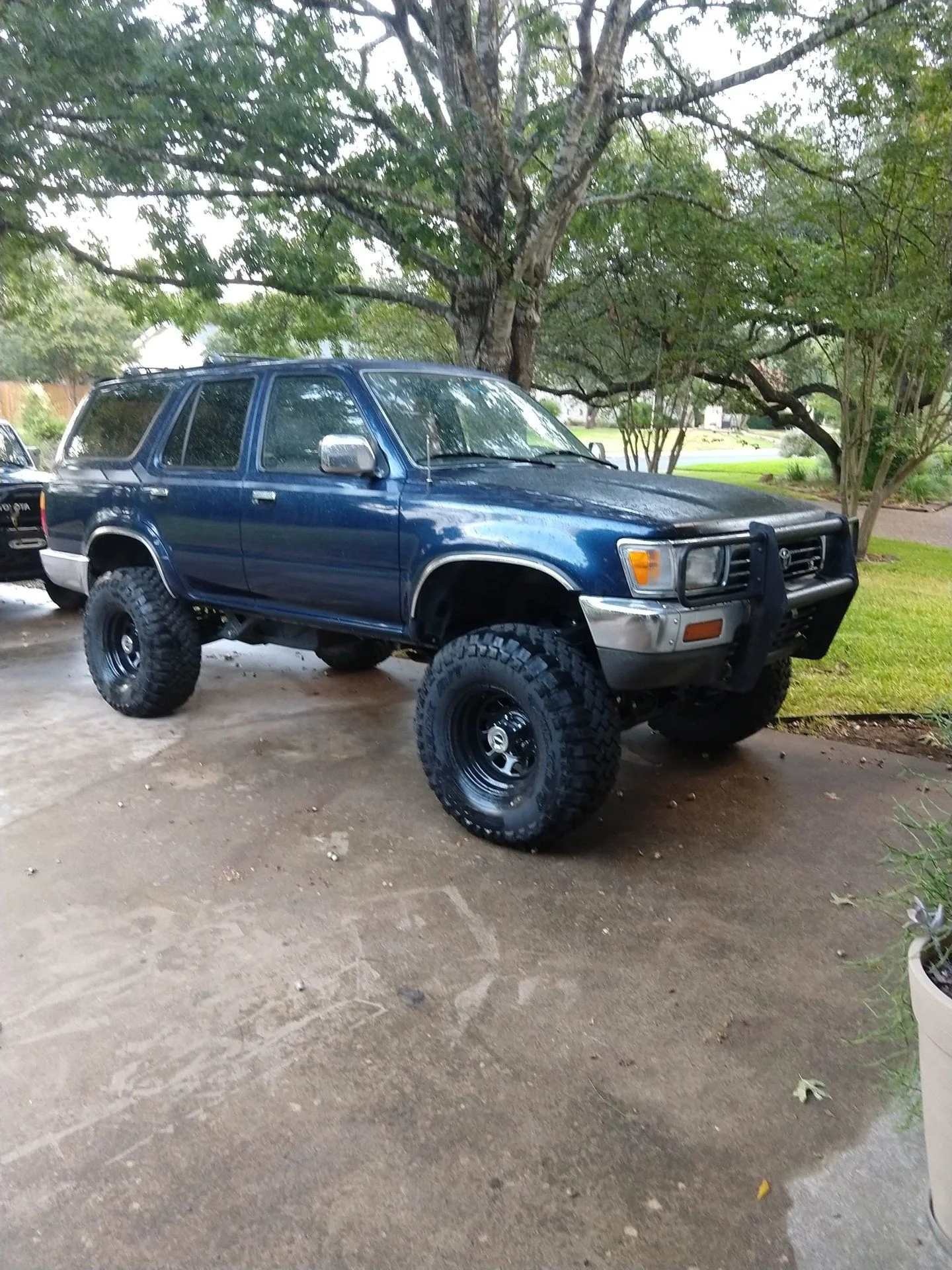

I know you could sell your brush gaurd to this guy Brush guard
There are a lot of options for lockers at least for the rear axle. I wouldn't waist my time or money putting in a full locker in the front with the ifs setup and weak 7.5 front diff/axle combo, maybe some kind of limited slip. You may also want to consider regearing the diffs unless it's already been done or came with 4.88s originally.
I would be interested in the brush guard, if You are planning on selling? Send me a PM with a price, and if are are willing to ship? Thank you.
