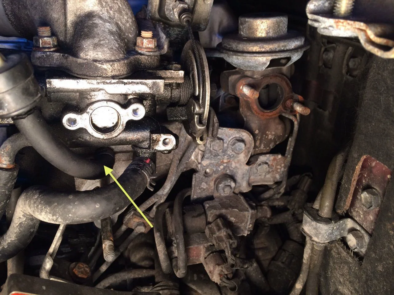

Any chance any of you have a pic or description of where the other end attaches to the boost sensor?
Thanks so much. Working perfectly now. Couldn't have done it without the help. What about this open end? Problem?
Nope, not a problem. The hose on the other end of that probably doesn't need to be there either. Here is a vacuum diagram; if I remember correctly, all of the hoses and related components can be removed, with the exception of 90999-92003, and that needs to be plugged.
Bingo Airhead nut. Everything comes off pretty much. Another thing to check is that you make your block off plates thick and strong, then get them locked down tight with a manifold sealant. Lots of power to be lost if that's not done. Now that I've got it all done right, and with a new seal kit installed on my fuel pump, I'm getting considerably more power and better mileage. About 23mpg on the highway and 20 driving around town, and 18 crawling around in the woods. What's that? About 10L/100km on the highway? If anyone wants pictures of what my vacuum lines, I'll post them.
