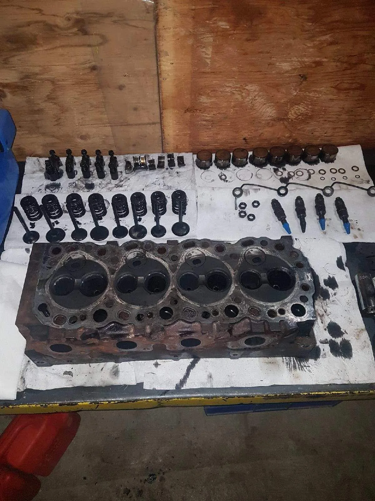

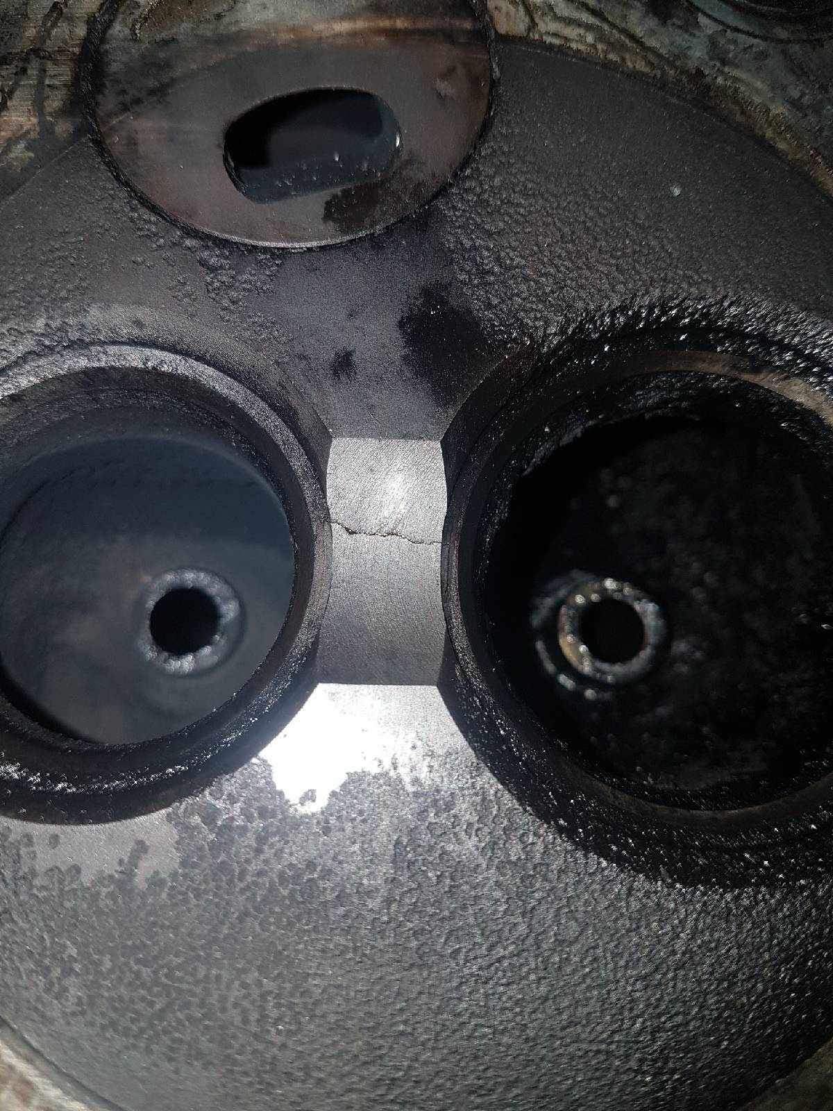

Working on this 2l-TE engine. Just started. The seals on the turbo are done, cooked, toast and faulty. Would this lead to overheating? Other weird symptoms are: The oil fill hole has exhaust flowing out of it in a big way. I filled the radiator and started the motor and coolant spewed forth violently. Could all this be as a result of the turbo having shot seals?
Failed turbo seals will not cause all those other problems.
If you have a lot of blow-by (worn cylinder/piston-rings) you will get exhaust coming out of the oil fill hole. An engine rebuild is really the only way to fix this. That said, all these L series get some air movement when you revmove the oil fill cap. Do the tea kettle lid test: unscrew the oil fill cap and let it sit in the oil fill hole with the engine running. See how much it dances around. No dance = no blow-by. A bit of dance is a bit of blow-by. If the cap gets blown right out of the hole you definitely have too much blow-by.
Sadly the coolant overflow is a sure sign of a cracked cylinder head.
You have a lot of work ahead of you. Could rebuild that motor, or find another one in better shape to swap in. Or upgrade to a better engine.
Take some videos and post them if you want more ideas.

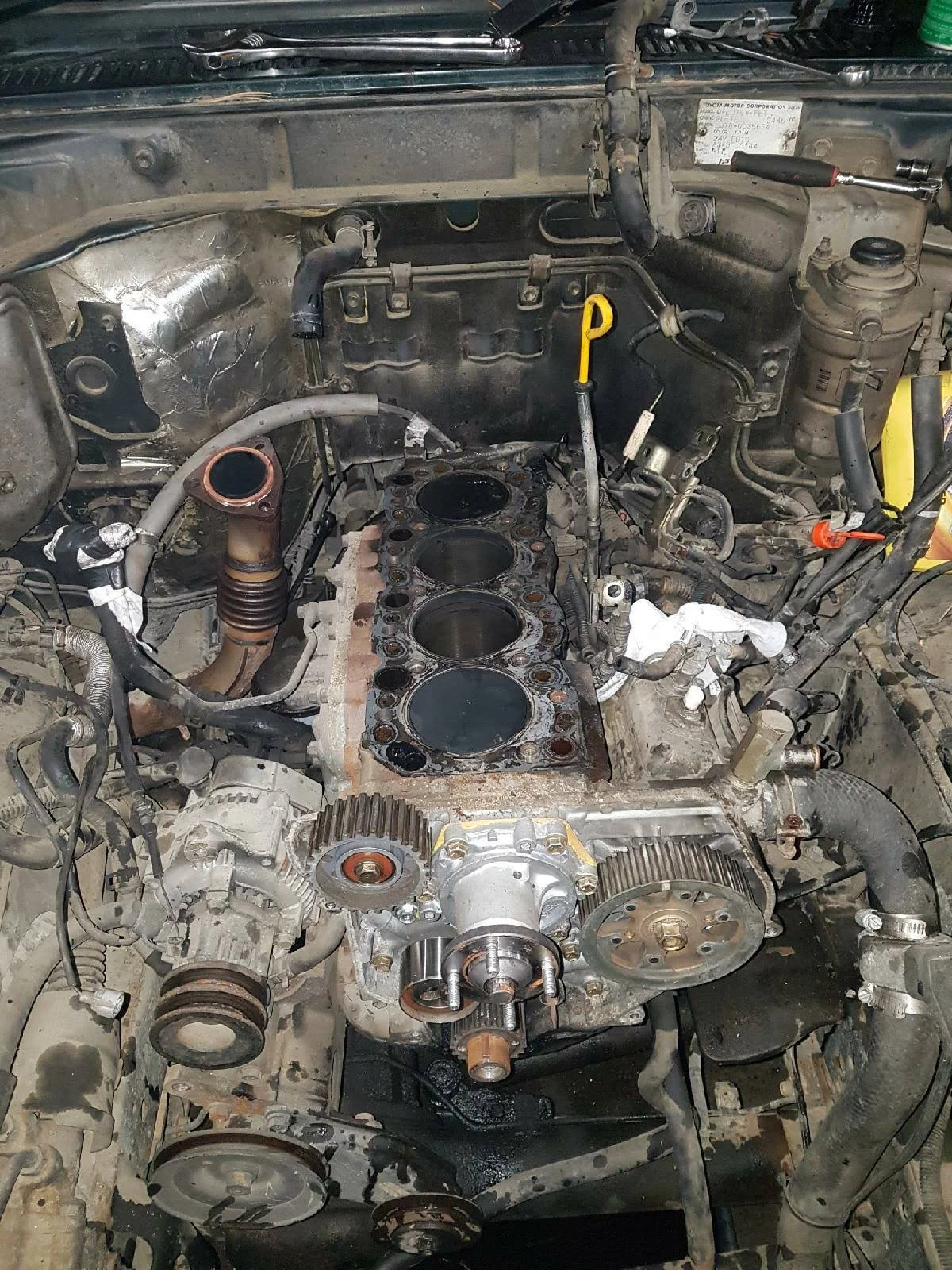

There is no exhaust coming out of the oil fill tube, so I think that the rings are fine. That being said, you got me thinking that maybe it is better to get a newer motor instead of repairing this one? Another question I have is whether the gasket kit for the head will have new turbo seals? Where would the best place be to start looking for another engine?
Turbo seals can be pretty easy to take care of with a new turbo or CHRA, or if you’re ambitious a seal kit.

I agree with the guys above. ALL pre 1995 2LT-II and 2LTE's WILL need a new cylinder head within the first 150,000km or so. No if ands or buts. So, if your engine is decent shape, and it's just the original head that has gone, just spend the money and put the new revision head on. The new revision head lasts much longer (more like 200,000-300,000km), and you'll have peace of mind that you're good to go for a long time.

So If I understand you correctly, once I get the head replaced, there should be less blowby, therefore all I have to do is clean the turbo?
Basically, yes.
I wouldn't automatically assume the worst about the turbo with all the other issues you have going on. Clean your existing turbo up and give it a try. Turbos are actually pretty tough. Don't vent your engine back into the intake when you reassemble. That is the cause of a lot of the oil people see in their turbo, not actually any leaking of the turbo itself.
