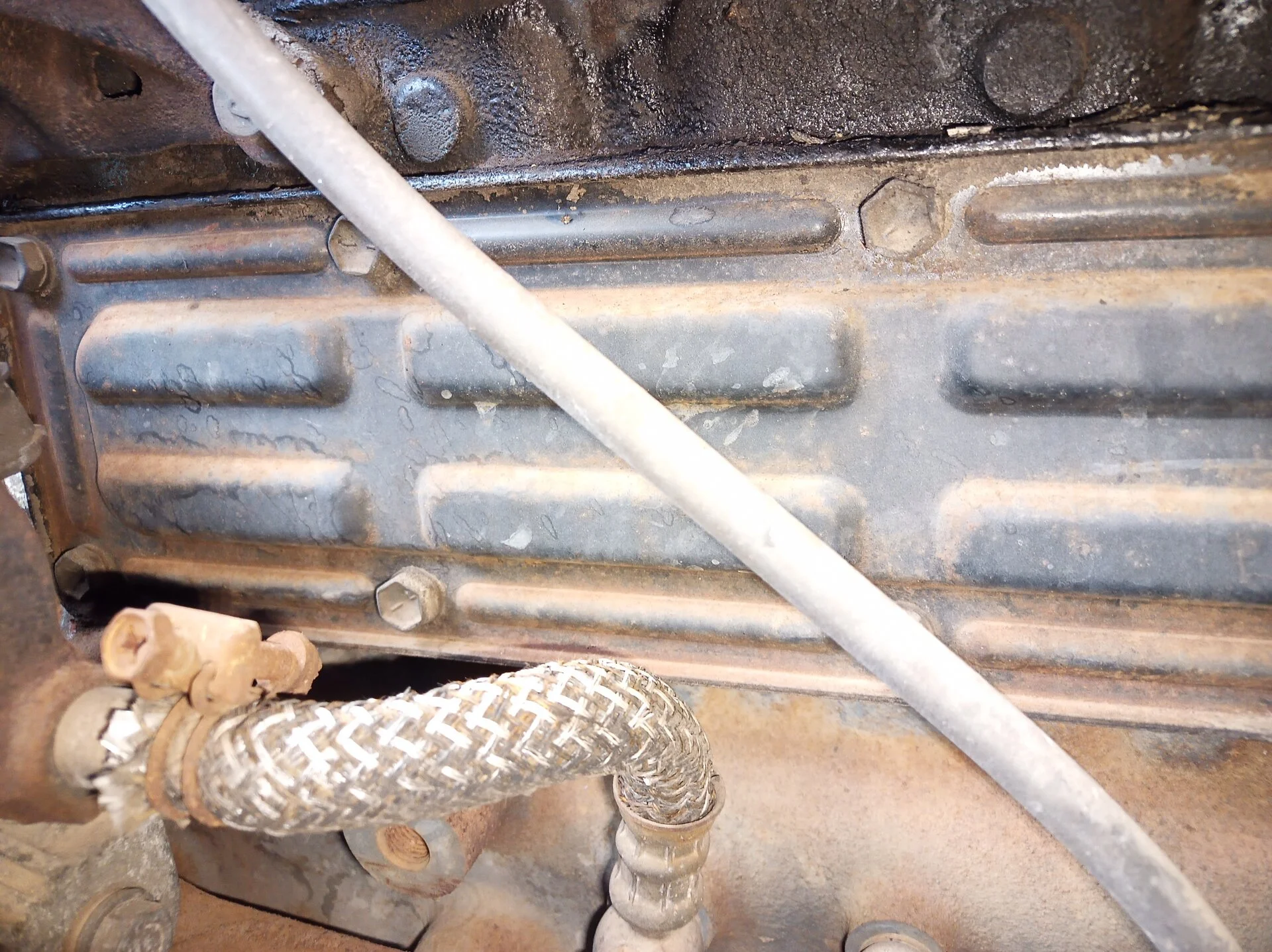

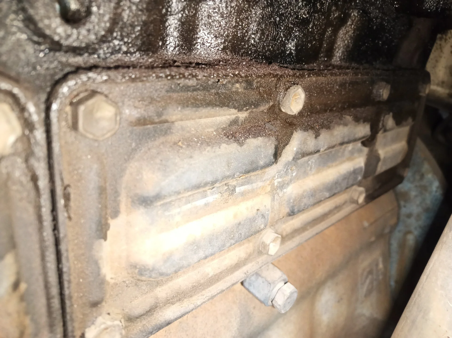

Thank you for the reply and picture.
The reason i suspect freeze plugs and not the head is because of how fast the coolant drained when i tried to top it up, there must be a pretty big hole somewhere and if it was the top it would probably only happen with the engine running?.

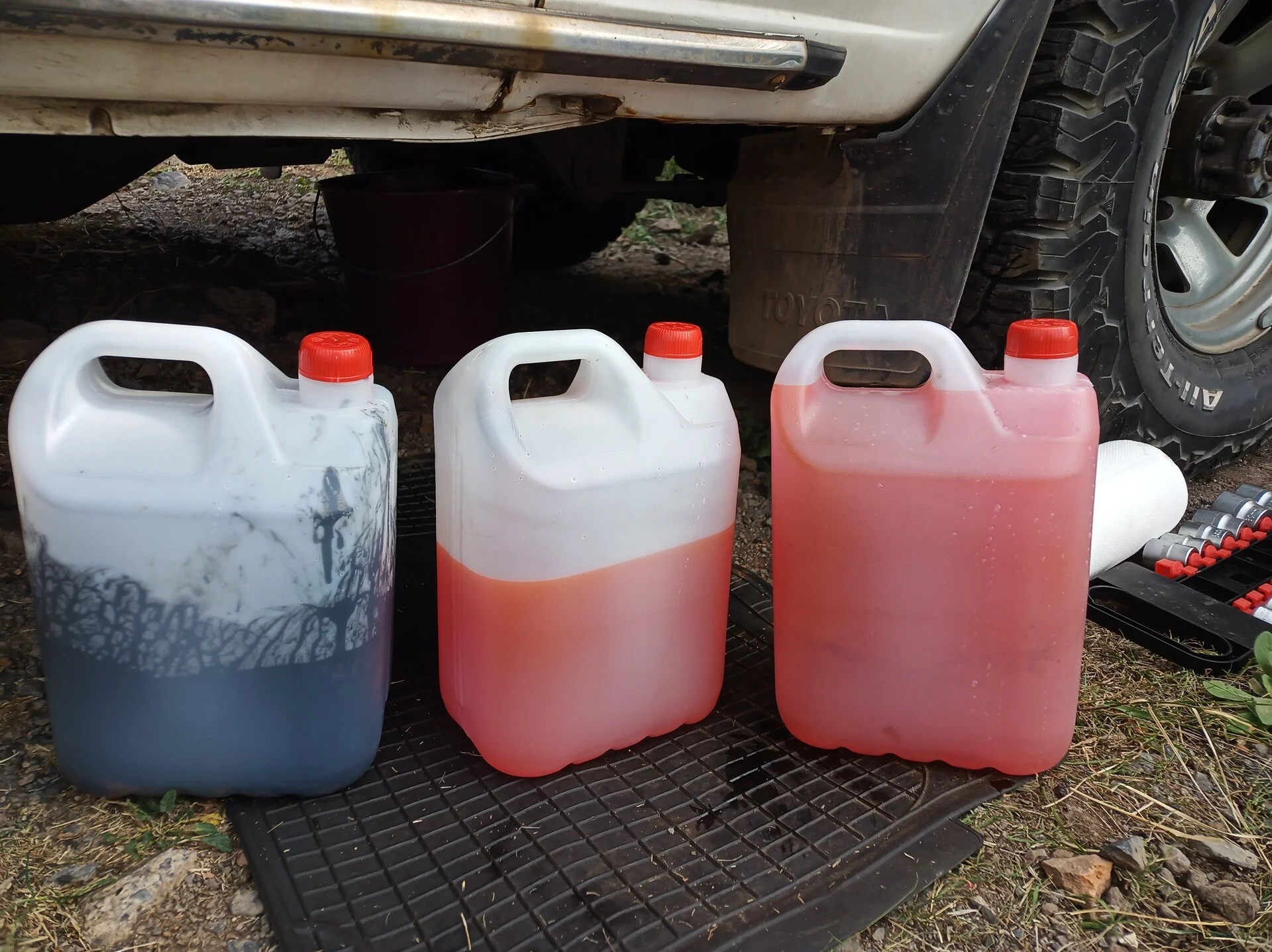

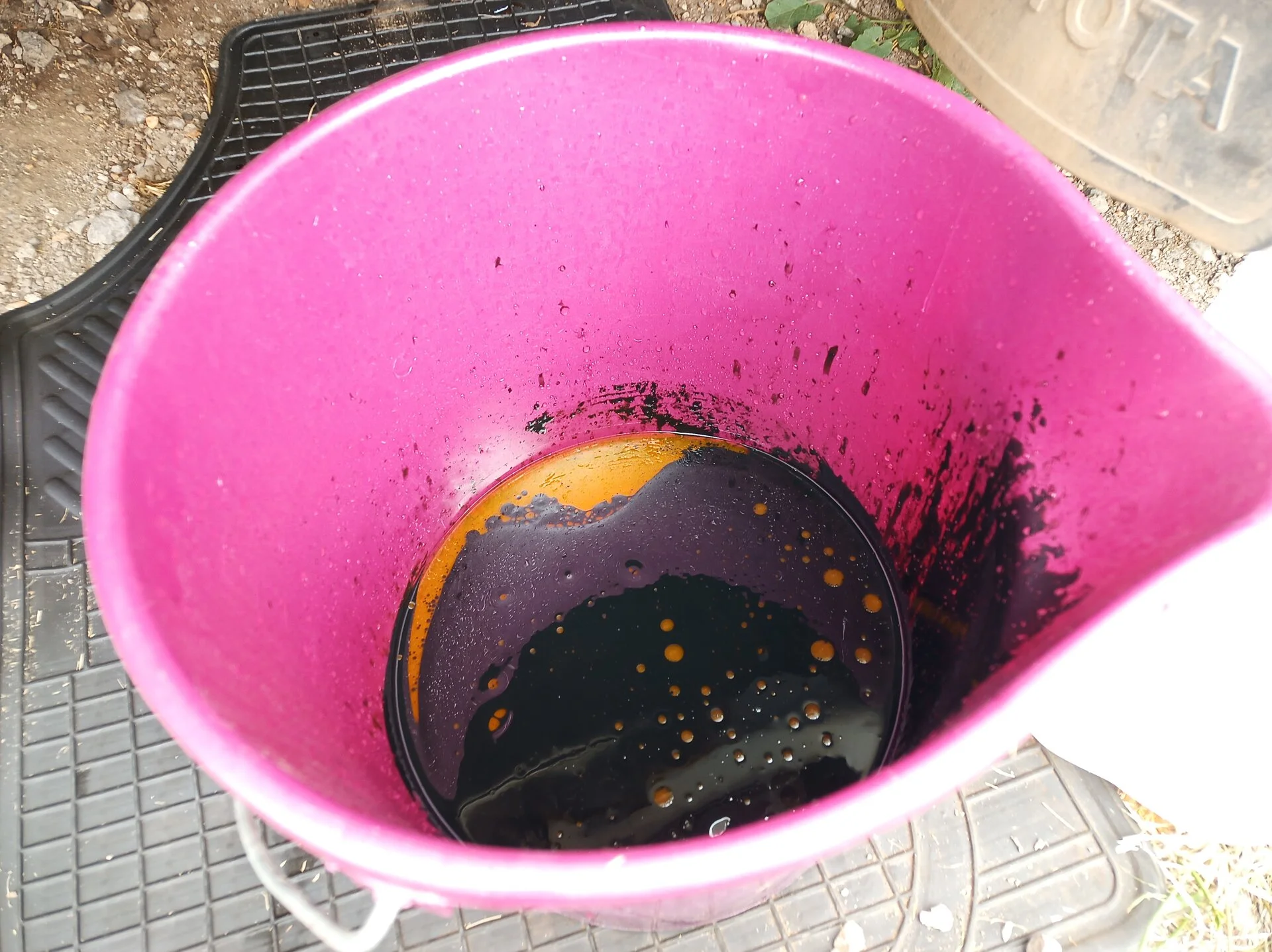

Here are pictures of what came out of the oil sump when i drained the coolant yesterday, the coolant looks very clean and not a lot of sludge but that is probably because the engine was not running?. Yes it's over 10 litres!.
Wow yes.. it would seem unlikely to be a head issue.
