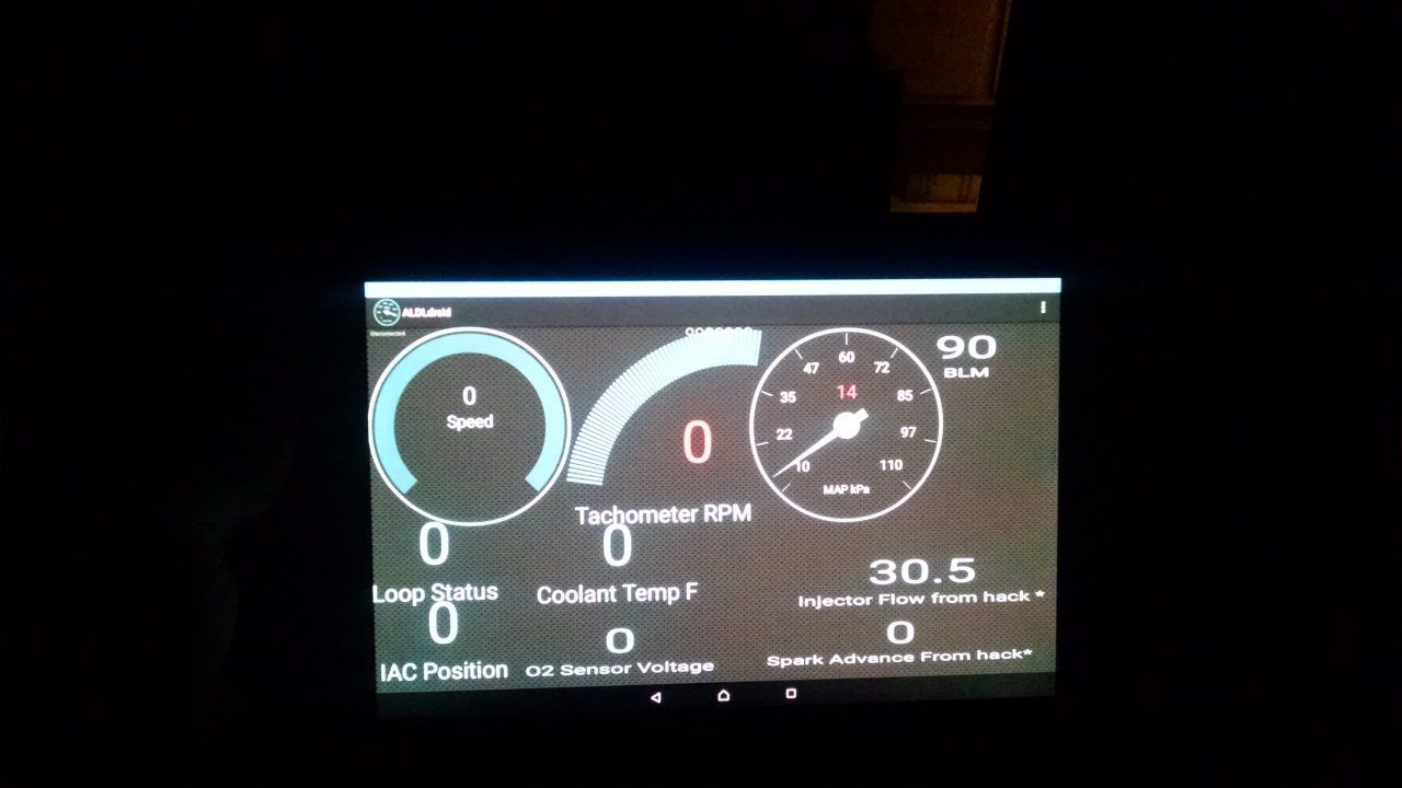

Here is the live data app. No need for additional gauges, I have my tablet or phone.
