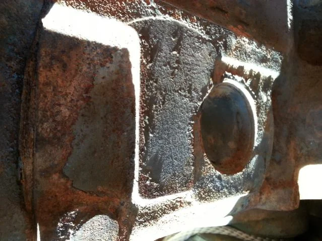

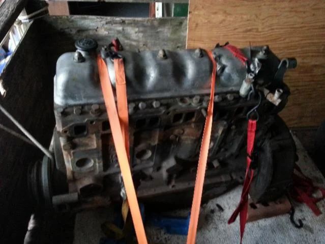

I just purchased a 2f motor with the casting number of 80116 any thoughts if its original origin or if its a domed or flat piston configuration the person I got it from said it was running good one removed but its a 2 F and he said it was out of a 74 it was not the original motor to the truck . Any information would be wonderful greatly appreciated.
I should also include it has been decent and I will try to attach a picture.
Here it is.
80116
Casting number is Y / MM / DD
1978 / January / 16 th ... or... 1988 / January / 16 th

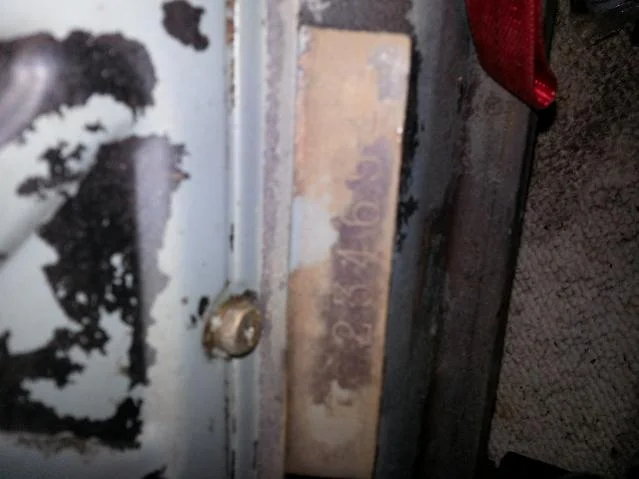

what is the vin number on the starter side of block? it will say 2F???????
The 1st I heard of the date cast stamp was by FJ40jim here on mud... Great resource
I would have included that number, but that's part of my confusion the original gray paint is still on it and there's no number stamped in the front of the engine runs expecting to find a number. Any comments on this odd phenomenon?
I really love you this forum, educating and teaching everyone because obviously I have a lot to learn. Attached is the picture again thank you the numbers are 2 f space 234 694
