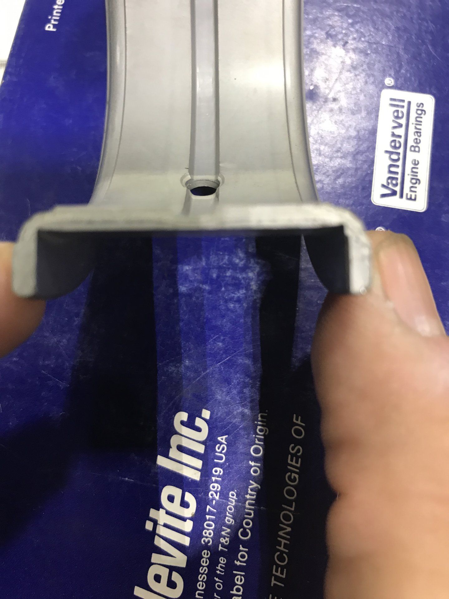

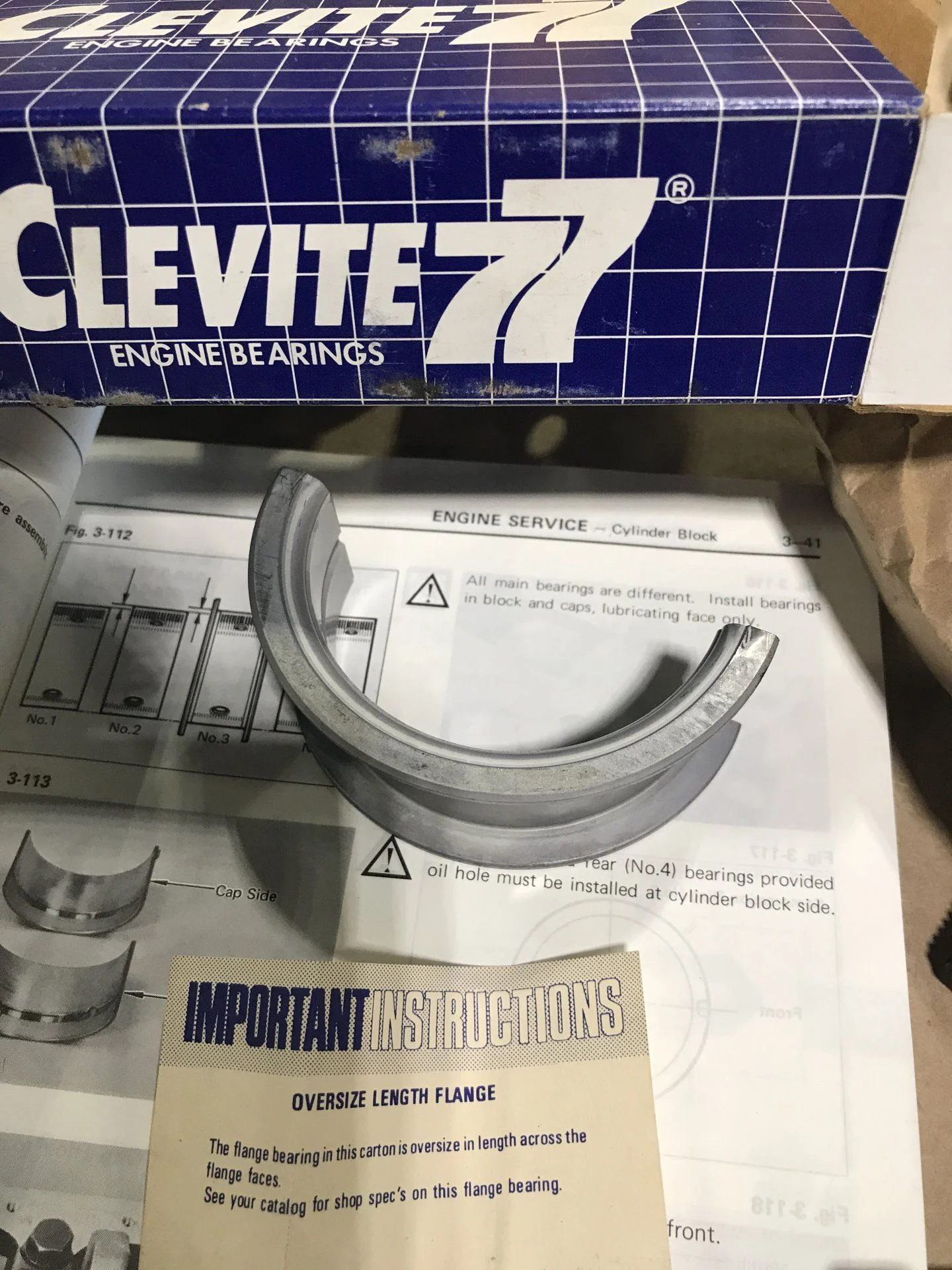

I was assembling my 2F rebuild today using a set of .25mm undersized mains from cevite . I put the bearings in the block and when I lowered the crank in the #3 bearing was tight (would not fit at all). Upon removing the crank I realized the issue was the side walls of the bearing (thrust side) were wider than the journal. Here is a picture of the bearing and the packaging.
When I looked at the box I realized there was little note in it stating that the bearing had a wider width flange.
Looks like this bearing set will not work, or I will have to get my crank ground again on the thrust faces. Anyone run into this before?? Suggestions? @FJ40Jim or anyone else?

It is possible. The tolerances I have seen over the last four decades vary quite a bit.
When I wore out the thrust on my crank in the Karma Cruiser, everyone seemed to think I would need to either weld my crank or replace it. With diligence I was able to source a set of bearings with enough meat to secure the crank after it was simply turned back to smooth with a wider thrust face.
I have gently sanded the outer faces of the thrust bearing to get correct clearance. I would rather remove meat from the thrust face of the bearing than turn the crank thrust faces. As long as you don't go through the outer tin surface of the bearing it should be fine. This exact issue has been discussed in another thread.
I’ve also seen this before. I’ve even seen it from a retailer that sells a crankshaft and bearing kit that is supposed to be ready to bolt up.
Don’t try to sand that much material off the bearing unless you like to hear knocks.
Either have the crank thrust surfaces turned to match the bearing or try to find an oversized bearing set with standard sized thrust measurements. It’s inexpensive to have just the thrust surfaces on the crank turned to the proper size for the bearings.

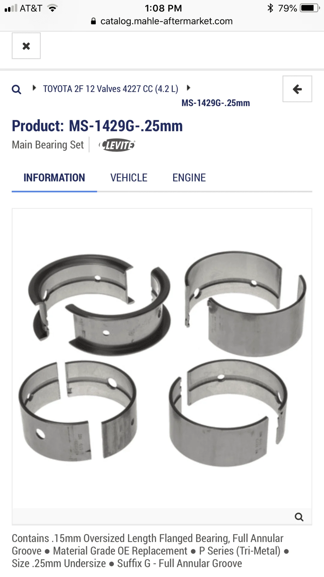

More info Incase someone is following along or needs the info in the future.
The pn for the clevite bearing with .25mm undersized diameter and stock thrust width is MS-2087 P-.25mm. Thx goes to Shively Speed and Machine in Louisville Ky for the pn. Great guy.
I will be ordering a set....
