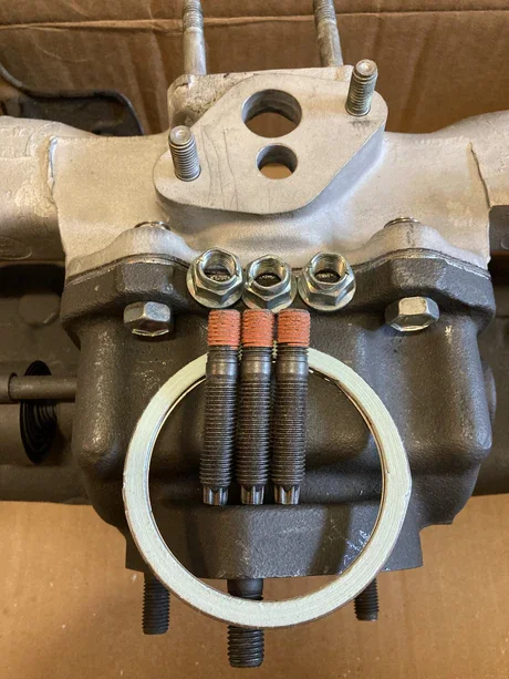

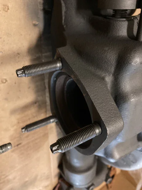

Are these studs longer than the original OEM studs? Thanks!
YES ,
both with the additional male threads of 21mm /
and the extra hex-lobular hand drive area no threads
this allows for a nice line-up and up-set of the down pipe flange
these are the best DAM Toyota oem M8 exhaust studs ever produces , and the matching correct new modern 2023 flange / anti-come loose nuts are A+ bench mark TOUOTA still in use today ....
thanks for asking this , i need to take a side by photo ,
also
these are perfect for the far end one 2F
you hang manifolds on the ctr ones
then TORX hand drive these after the fact , EAZY PEEZY step by FSM steps .../
