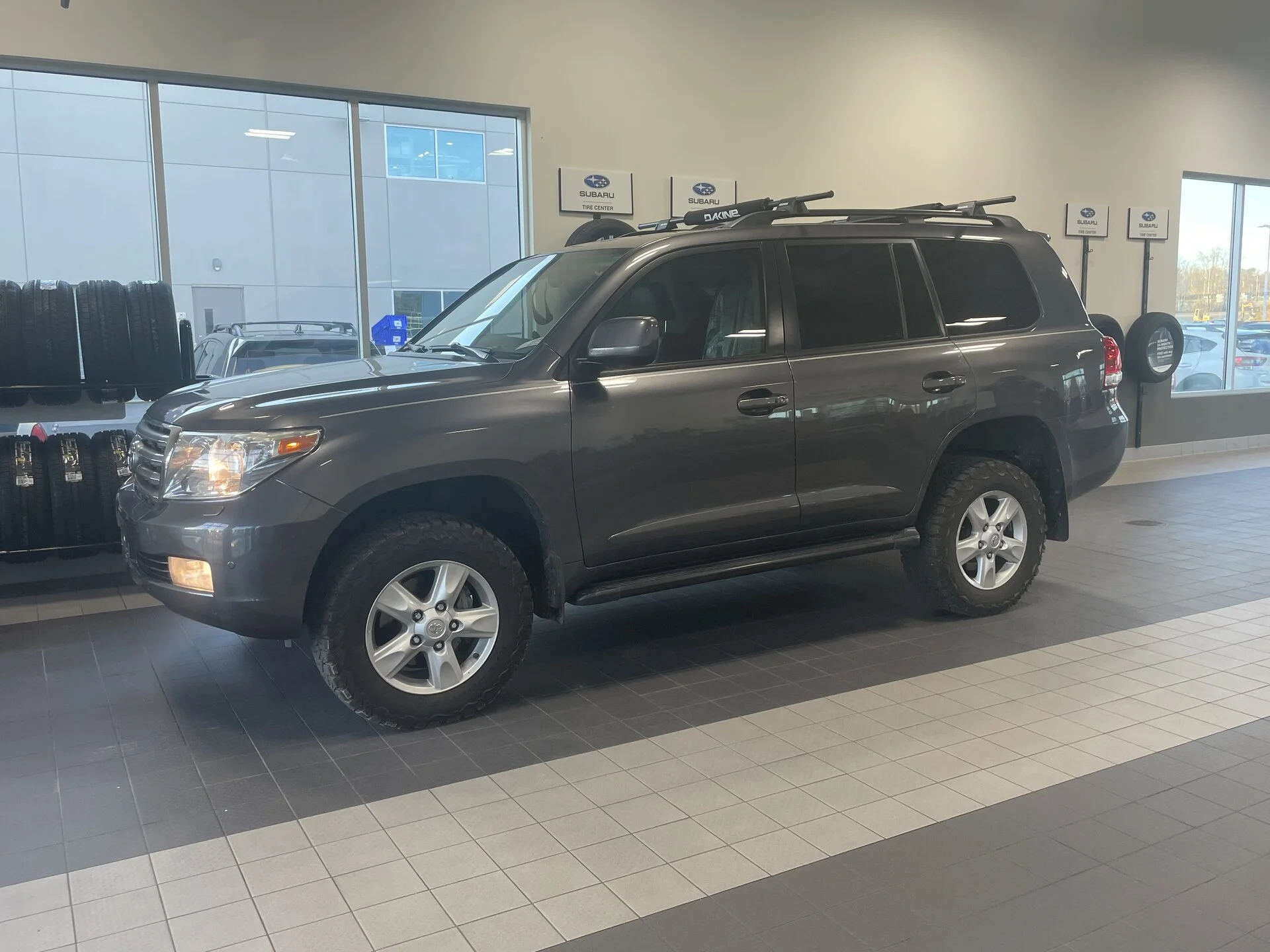

I have been running 275/70/18's on the factory wheels with no lift other than the OEM 10mm front coil spacer for nearly two years now. I did add 1.25" wheel spacers but that was more for stance looks than necessity. You will have to loose the mud flaps and possibly do some trimming but nothing major is needed and these fit with ease with a proper lift.

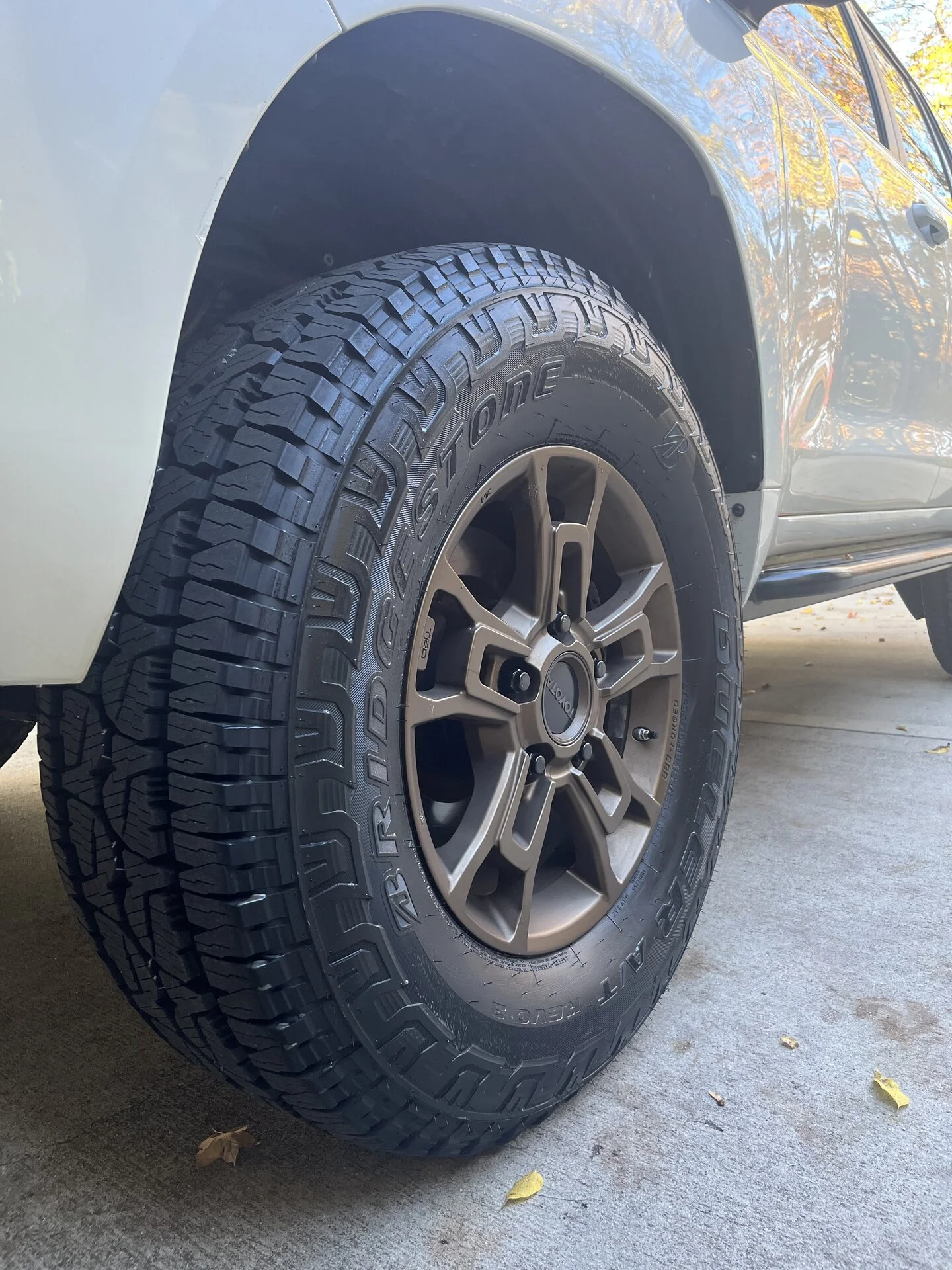

I had 275/70/18 on mine with just wheel spacers and had no rub after some very light reshaping of the fender liner with a heat gun.
Now running 285/75/17 with +25 offset wheels and have very slight rub on the mud flap when turning left. Should probably take the front mud flaps off but it’s not bad enough for me to really worry about.

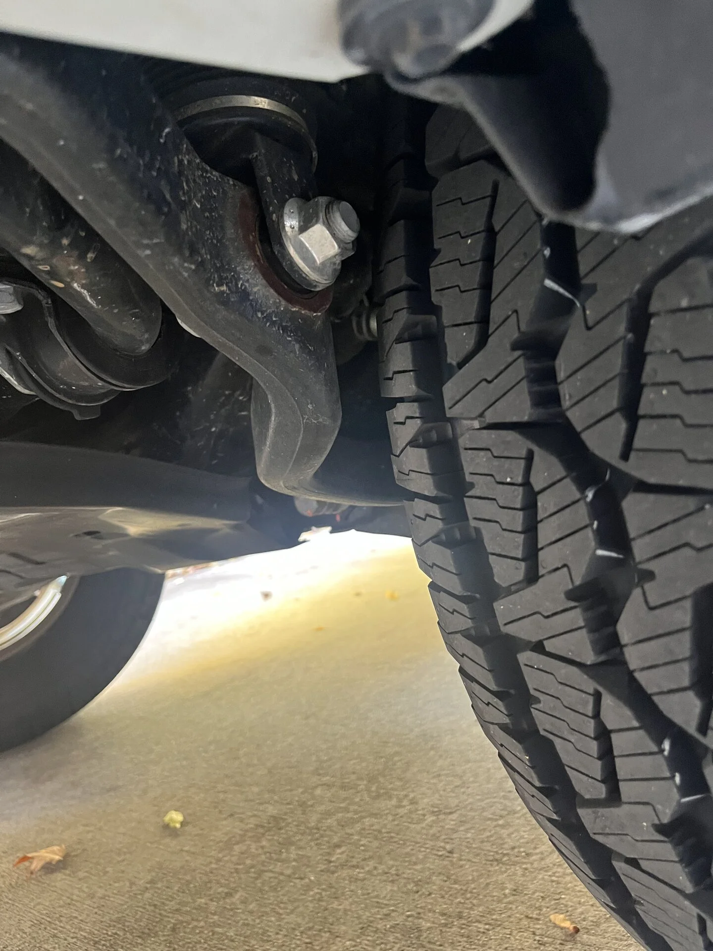

275/70R18 will work for sure but you may have very slight rubbing on the UCA that you will only notice from a small shiny spot on the UCA. I ran this for a while and it was fine. Wheel Spacers might keep from rubbing the UCA but will almost ensure some slight trimming elsewhere.
285/70/R18 will need some trimming, and likely other stuff. This is essentially a 34" Tire.
285/65R18 should work fine, and are essentially the same size as the recommended 285/70R17 size for Rock Warriors.
295/70R18 is a big tire, as big as some brands 35s. In addition to trimming, you will very likely have to do something about KDSS rub, which takes you down a whole rabbit hole of things that are certainly more difficult than trimming. Certainly doable, but if you're concerned about trimming, I don't think you'll want this path.

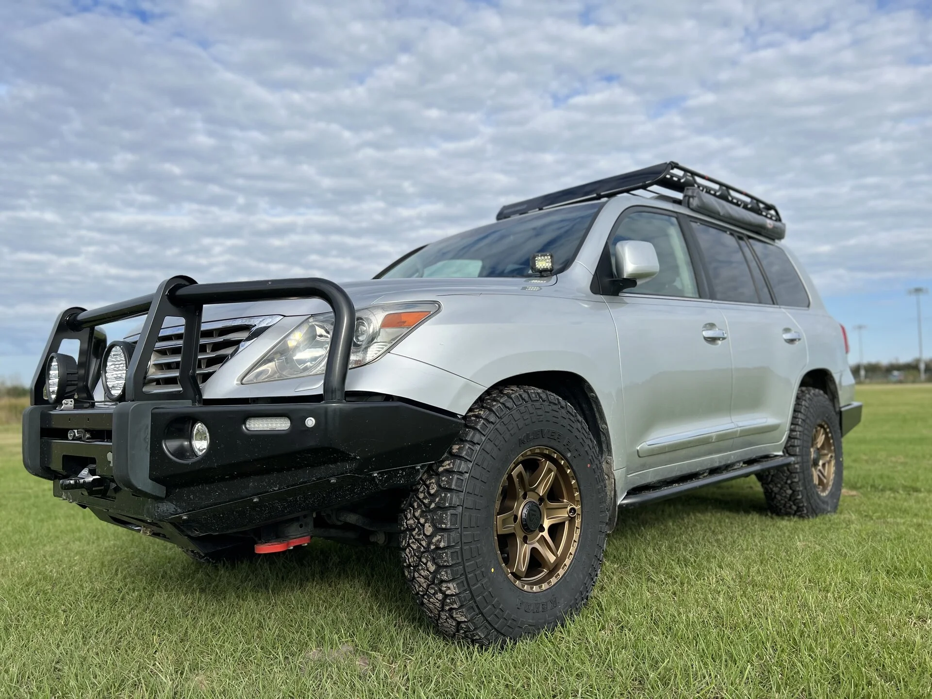

I’m running 295/70r18 on my Heritage wheels with 1.25” spacer, 2” lift, SPC UCA and trimmed the front liner and removed the front mud flaps, then an alignment. No rubbing
