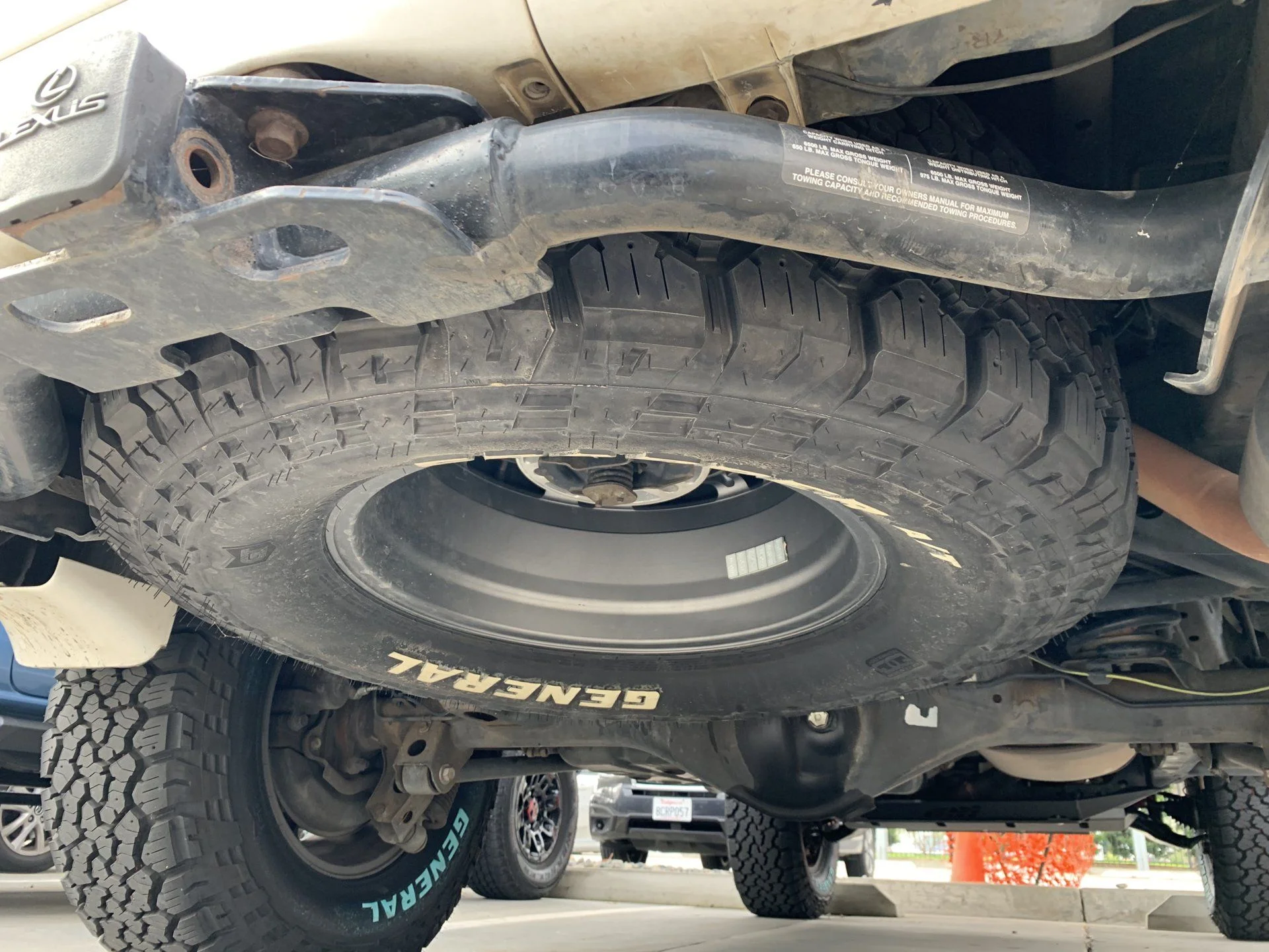

My 285 ko2 wont fit the factory spare location when deflated with no factory hitch. I run a metaltech high clearance hitch which doesn't interfere with spare but still mounting the spare in factory location was a no go.
I bought worn but not bald 285/70-17 KO that fits in the spare location. I do have a frame rail hitch. Odd
Hmm I was able to fit a new fully deflated 285/70 ko2 underneath with the full size towing hitch, its tight but it goes. Im running the 285/70 General ATX now which is a notch larger and they fit as well.

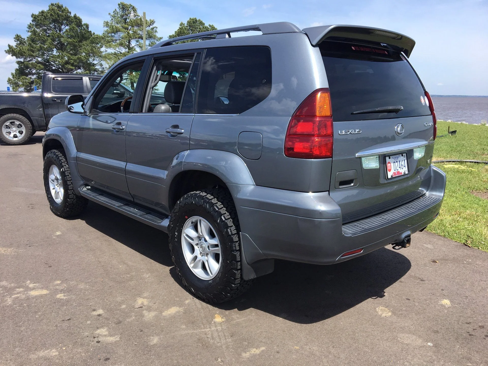

I have been doing a lot of reading and research. Assuming a 2-2.5" lift with Bilstein 6112s in front and 5160s in back while retaining airbags.
285/70R17 ~ 32.7"
Pro:
Beefier
Con:
Rubbing - have to trim
Won't fit in stock spare location (probably use a Wilco Hitchgate)
Lose backup cam if on Hitchgate
A bit more expensive
255/75R17 ~ 32.1"
Pro:
No rubbing
Should fit in stock spare location
Con:
Not quite as big
Don't get to look cool with the Hitchgate and a Trasharoo?
It seems like more people talk about the 285s. Why is that and what am I missing or not considering?
I have OME 2 inch lift with metal tech stage 2 spring conversion rear with 1.25 spacers, 285/70/17 BFG KO2's on stock rims, mild inner fender trim with no other rubbing. Full 285/70 spare will not fit with receiver mounted to stock cross member. Have Wilco high-clearance Hitchgate ordered from Jegs and should ship this week. I'll post pics of spare on hitchgate once it's in.

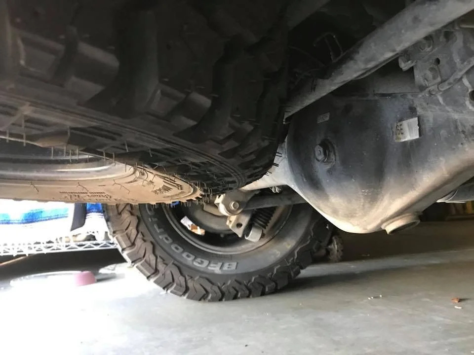

Besides the restriction of the tow hitch or cross member on the outer side, there’s another bar in the inner side. Maybe some people have that inner bar bent more than others. Just guessing
Here is my attempt with a new ST Maxx 255/80-17. 3/4” SSO spacers, full factory hitch. Squarely on the panhard
Are some of you ‘muscling’ the deflated 285/70 into the spare tire location underneath? Or using something to help lift it?
