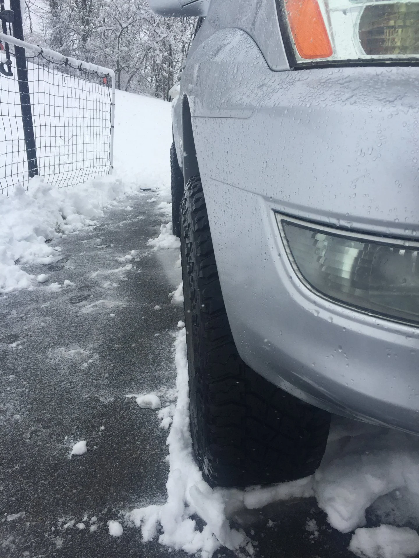

I'm running 255/75 cooper stmaxx LR C on 17x8.5 wheels w/-6 backspacing and i like them. the backspacing gives them a nice amount of poke and they have taken me everywhere i've wanted to go..They handle exceptionally well on the road and seem quiet but that might be the lexus soundproofing ....Only time i think they look kinda small is right beside a vehicle with bigger tires :) other wise i think they fit the proportions of the truck ok and it didnt hurt my feelings to not have to do a body mount chop and chase rubbing issues around.... I actually prefer having the spare underneath.... my back isnt getting any younger and the stock cable lift makes my regular 5 tire rotations just that little bit easier.
