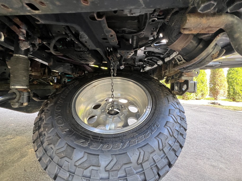

255/80/17 Toyo Open Country R/T Trail deflated to 15 PSI
Curt hitch
Ironman KDSS spacers
Tried angling it down towards the front, down toward the back, slotting it in at every angle conceivable
Not a chance in hell
Am I trippin or what?
I dont see KDSS spacers on yours.
Maybe it would fit with the spacers?
