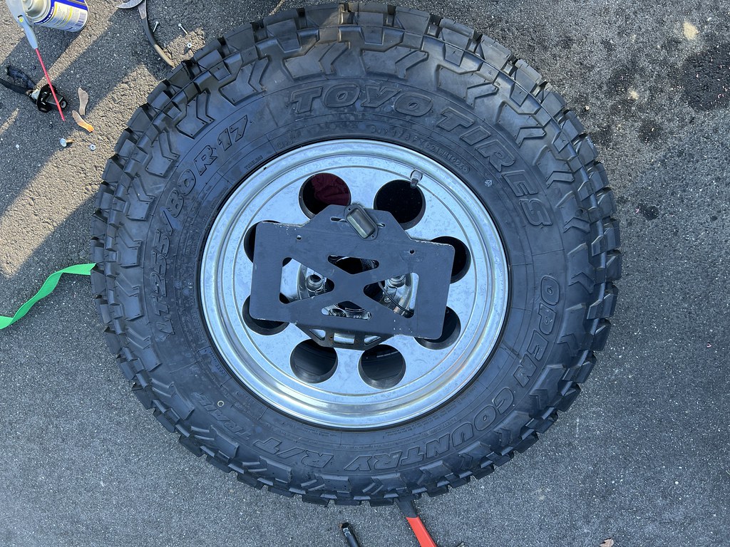

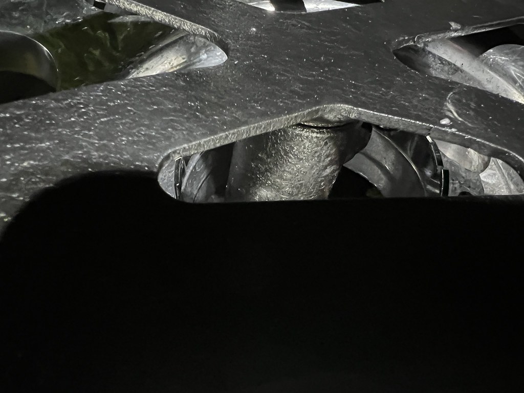

So I actually set out to give this a shot yesterday but ran into some trouble, the JWOffroad license plate mount is stuck...
It's basically a slip joint so one piece slides into the other but I'm getting nowhere. Tried a tow strap and even the winch. Let is soak in WD40 overnight so hopefully some luck today.
good thing you didn’t actually need to use your spare! if wd40 doesn’t work, pb blaster has worked well for me. stuff stinks so spray it outdoors.
Glad I found out this way and not on the trail haha
Edit: License plate mount is separated, will try to fit the tire under the truck tomorrow
