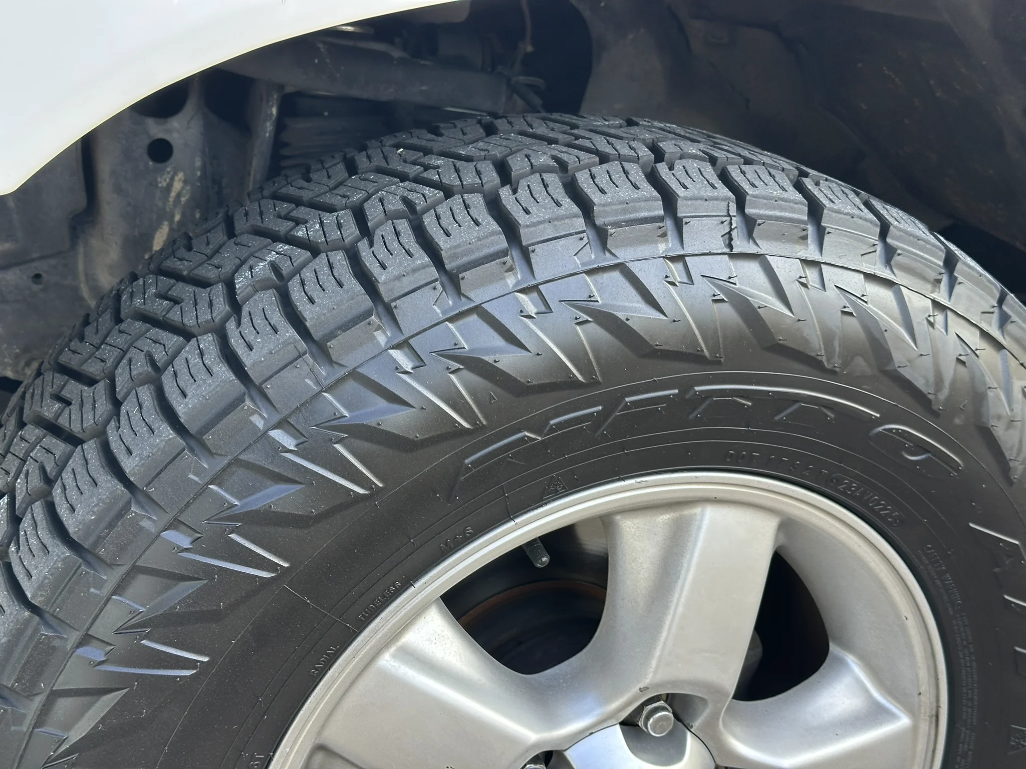

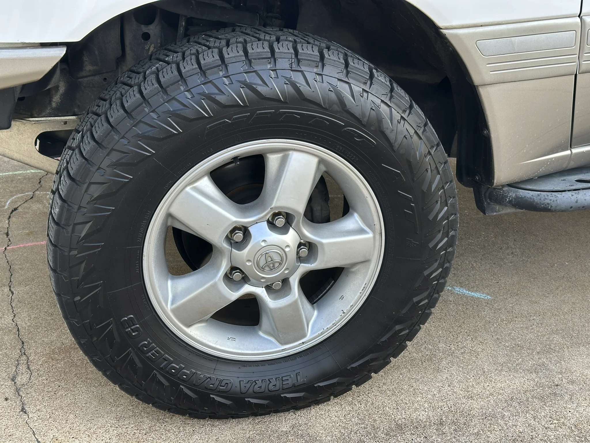

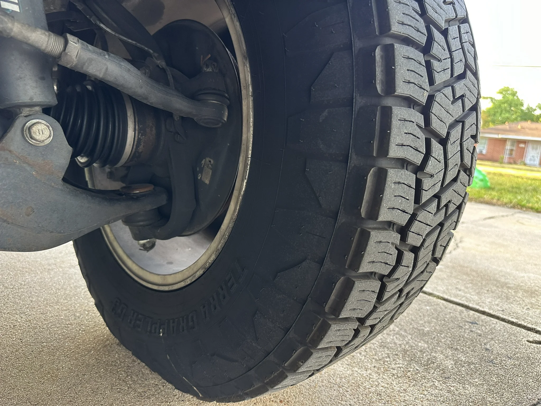

Sorry for the delay. The tire has two different sidewall designs.
tbh, the only downside i noticed driving these tires is the loss of some stability because of the softer sidewall compared to an E load. a fair price to pay for all the good things they offer.

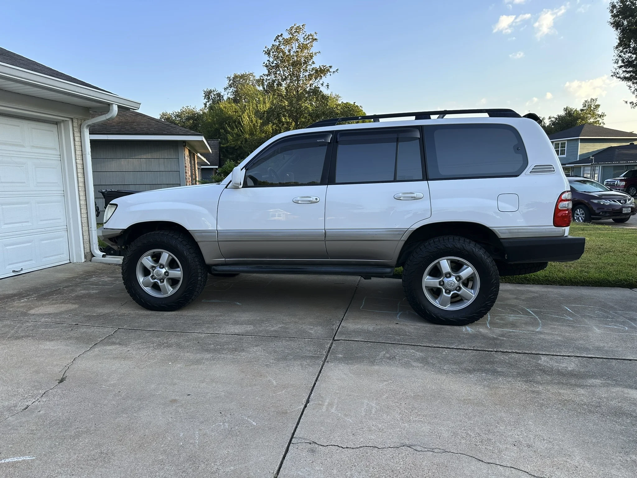

Newly installed 265/70/18 Duratrac RTs on my LX just in case anyone on this thread is contemplating this size as well. I like a good bit of fender gap so this size is absolutely perfect for me. They ride nice too since they’re SL rated.
AHC in neutral position, slight incline toward the building.

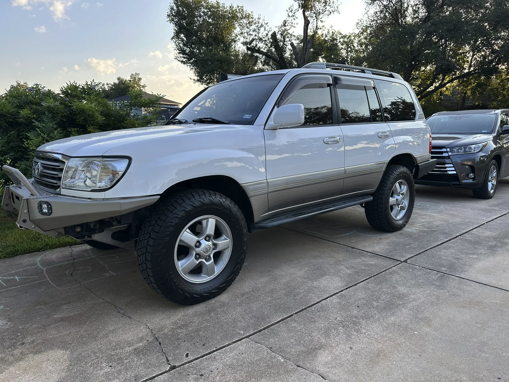

I'd have a hard time going with SL-rated tires, when my LTX MS2 are a "superior" rated XL, ride great on the hwy, and did well in the little bit of snow last weekend outside of Mammoth, and pretty good on another less-traveled rockier FS road in that same area before the snowfall, much more rock than in the 3rd photo but I was busy drving as I had zero recovery/boards/shovel/etc and was too busy trying to avoid damaging my 6 yr old LTX MS2s at 35PSI. ALso had zero cargo, 3rd row seats removed, and just me in the car, so probably couldn't get it any lighter.
