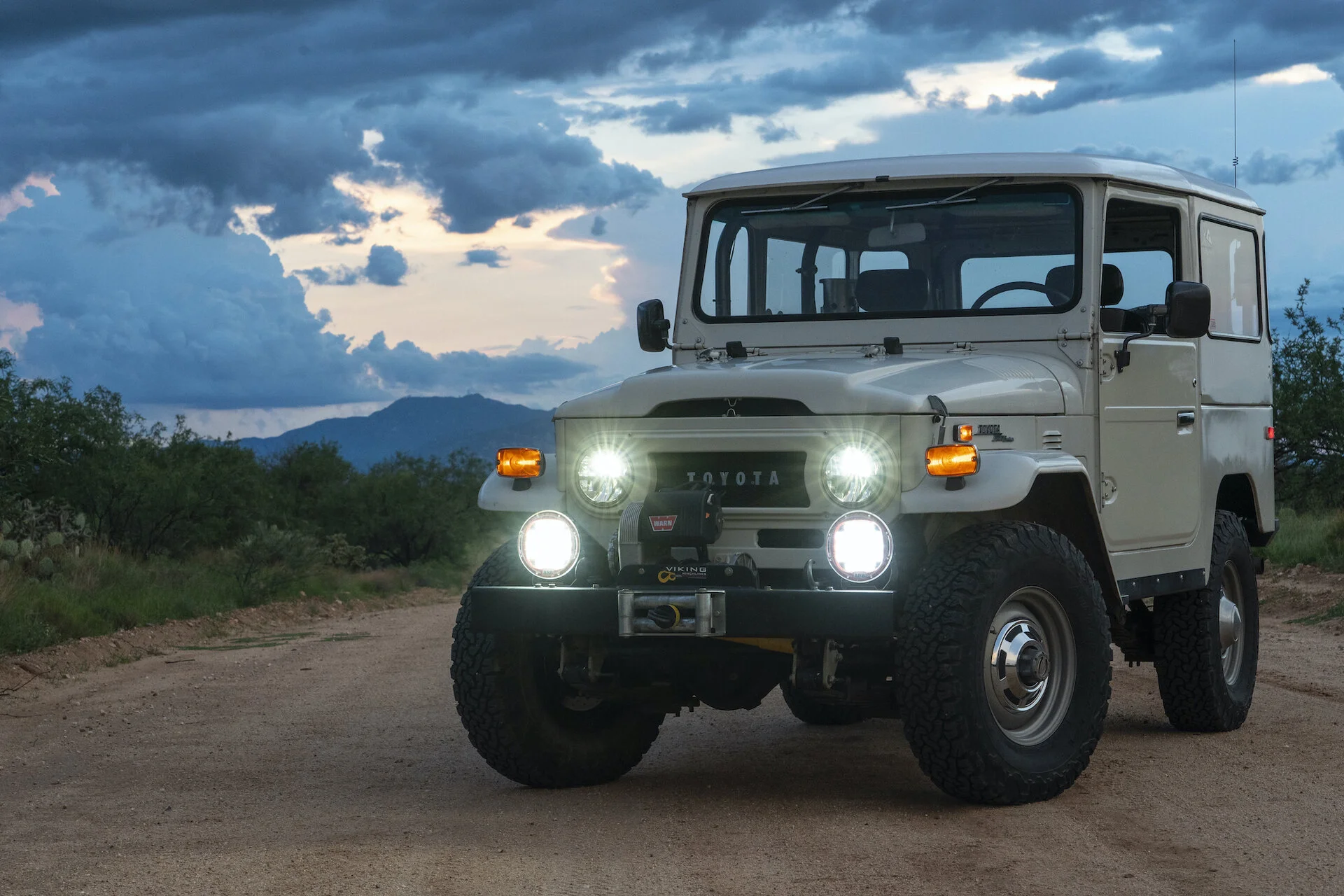

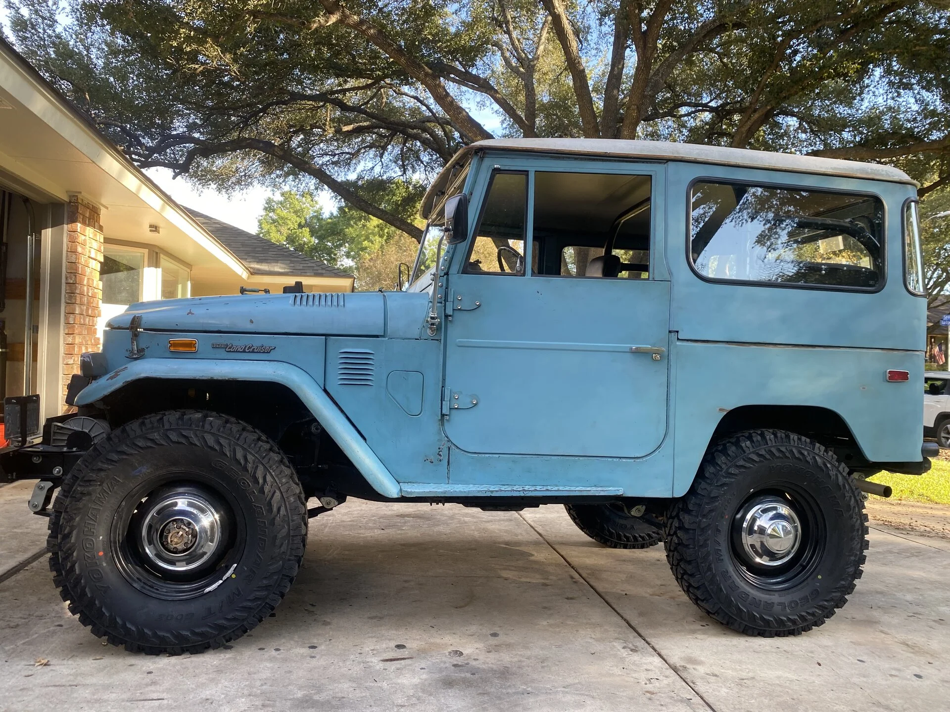

Here you go: Yokohama Geolandar M/T (LT255/85R16) (tirebuyer.com)(x5)(06/06/2023)($1,487.10) on City Racer 16" rims.

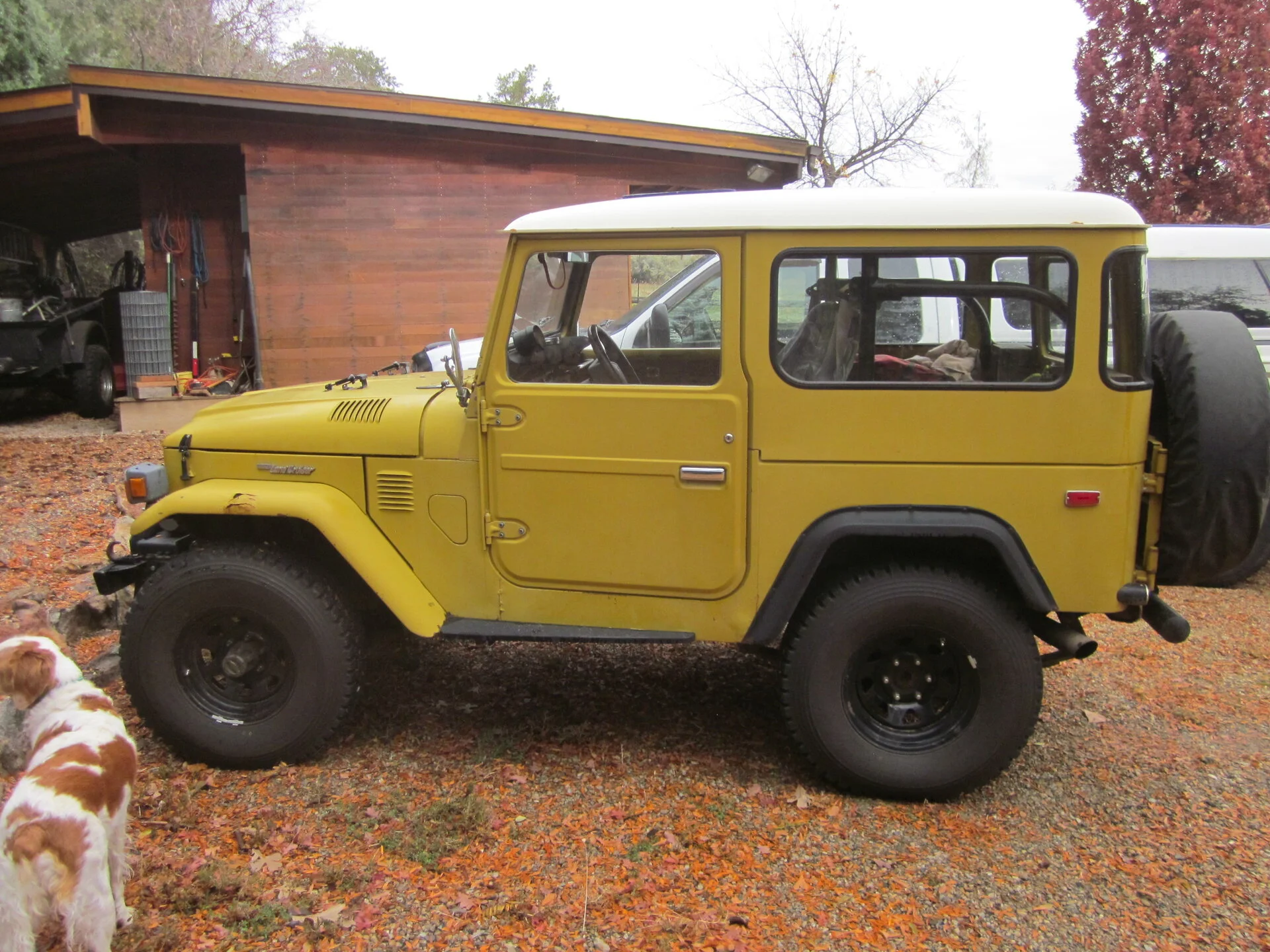

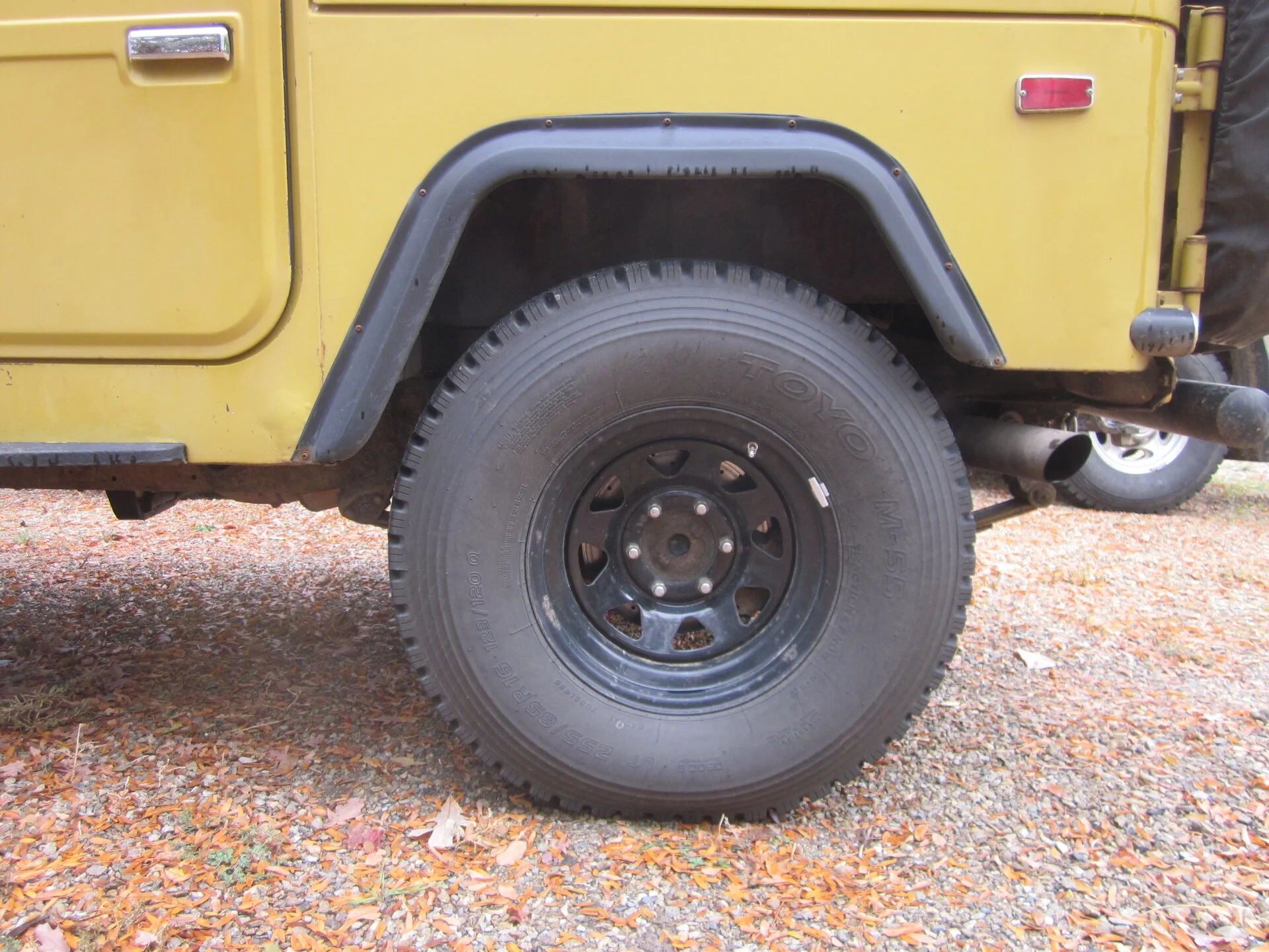

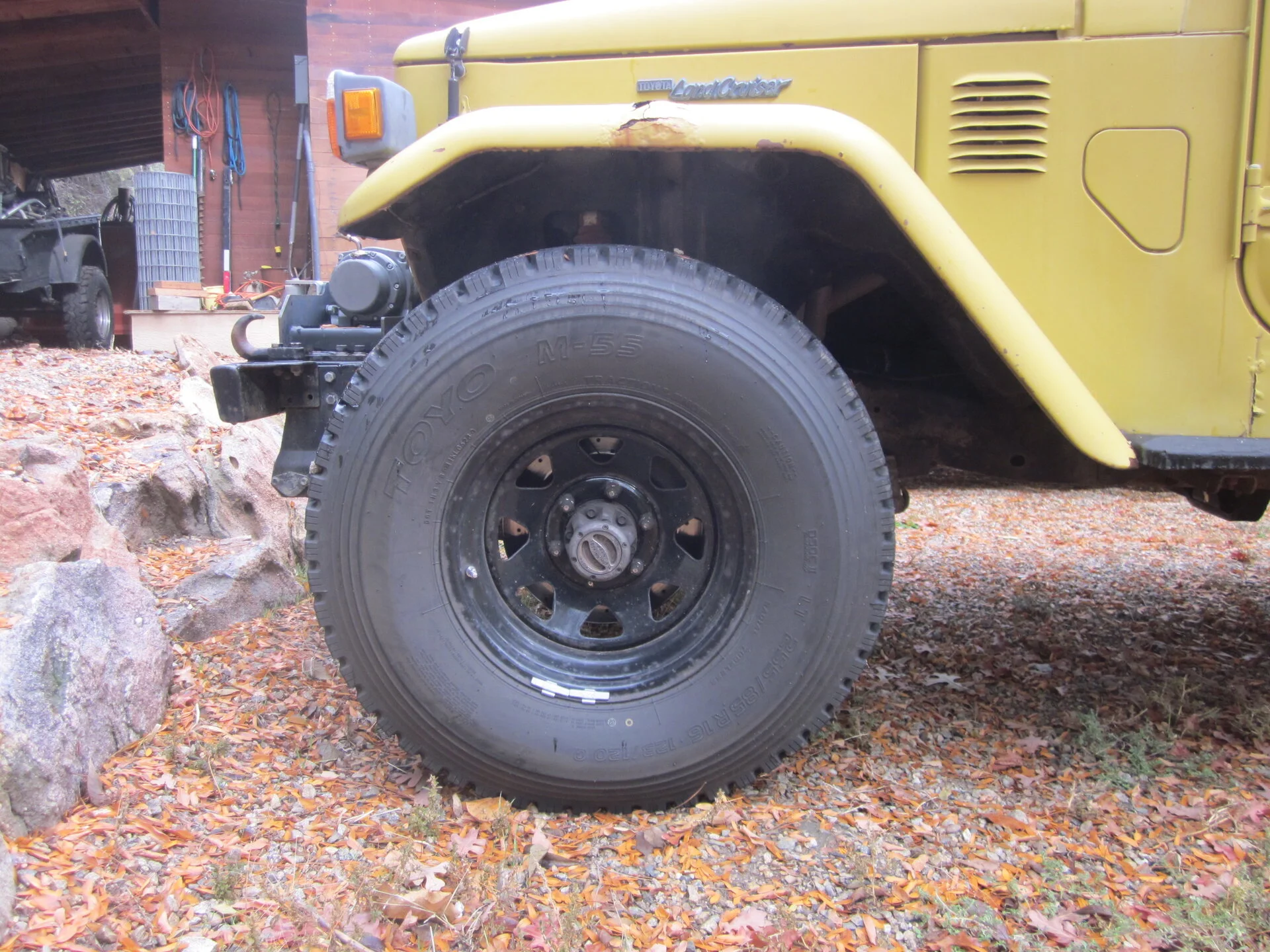

Not City Racer, but 16" wheels ala Mr. Manny's specs.
Toyo M-55s, 255/85/r16
2-1/2" Alcan lift in rear, 200-300 lbs in back.
PO installed shackle reversal in front, ... unknown lift.

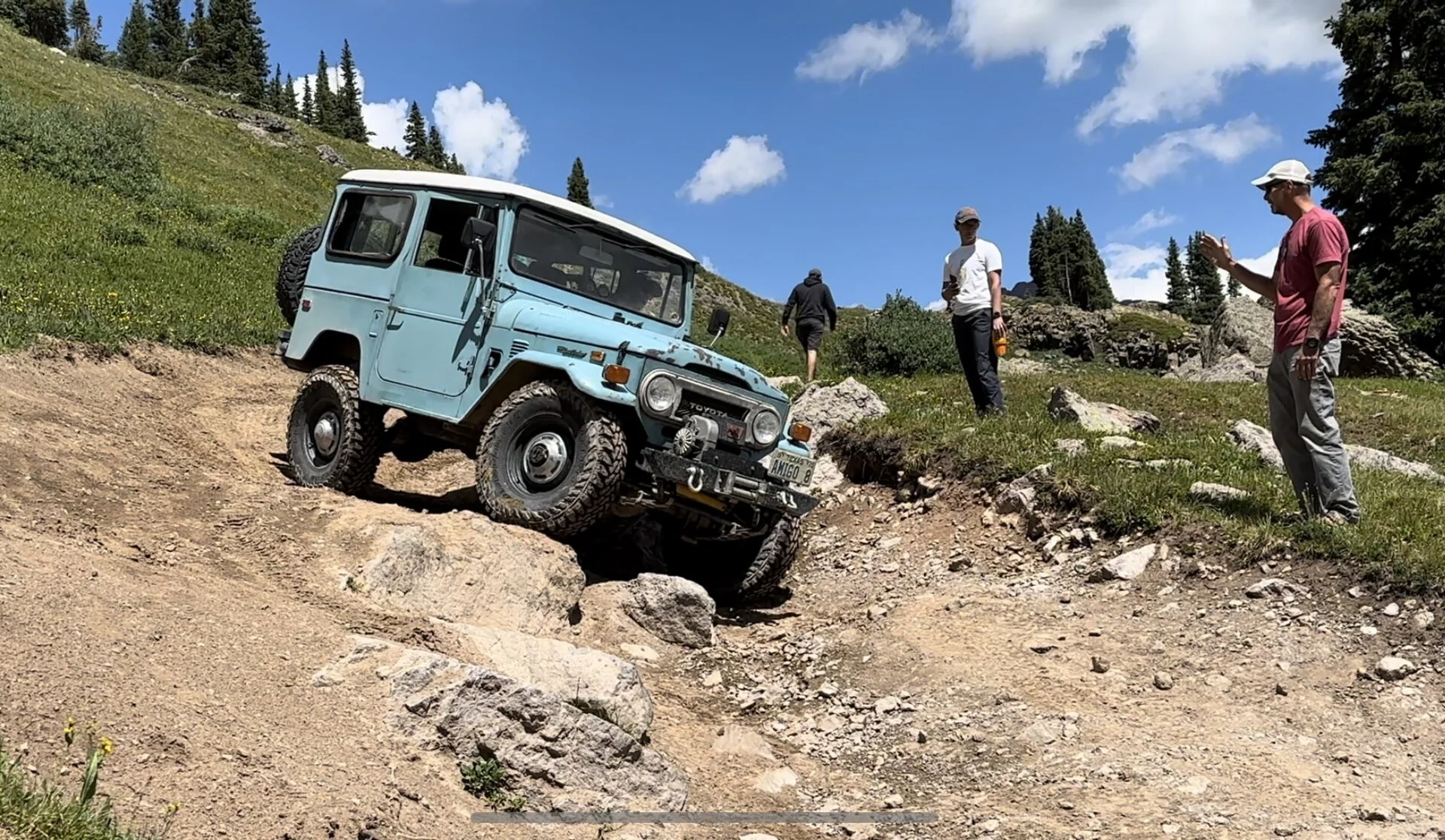

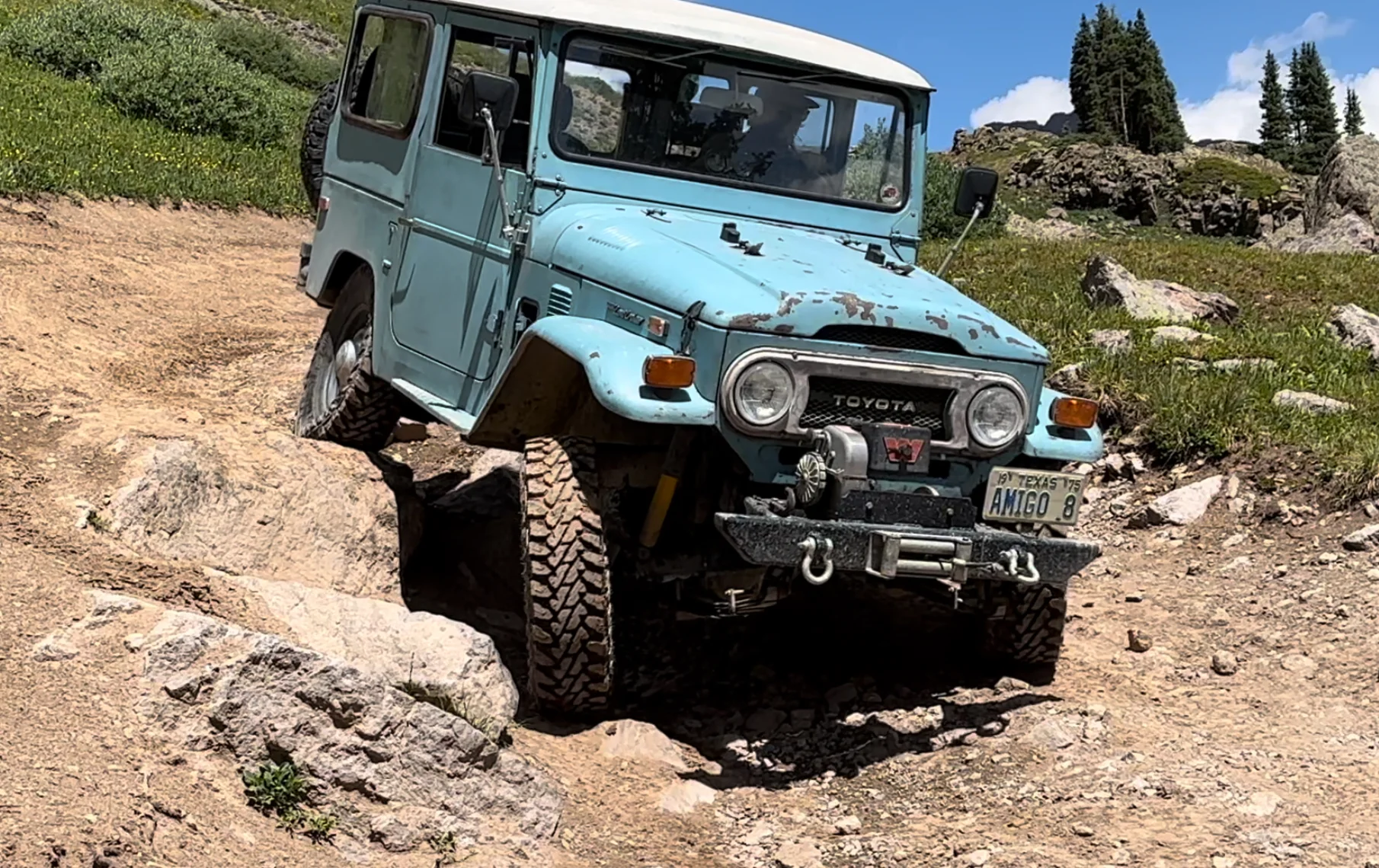

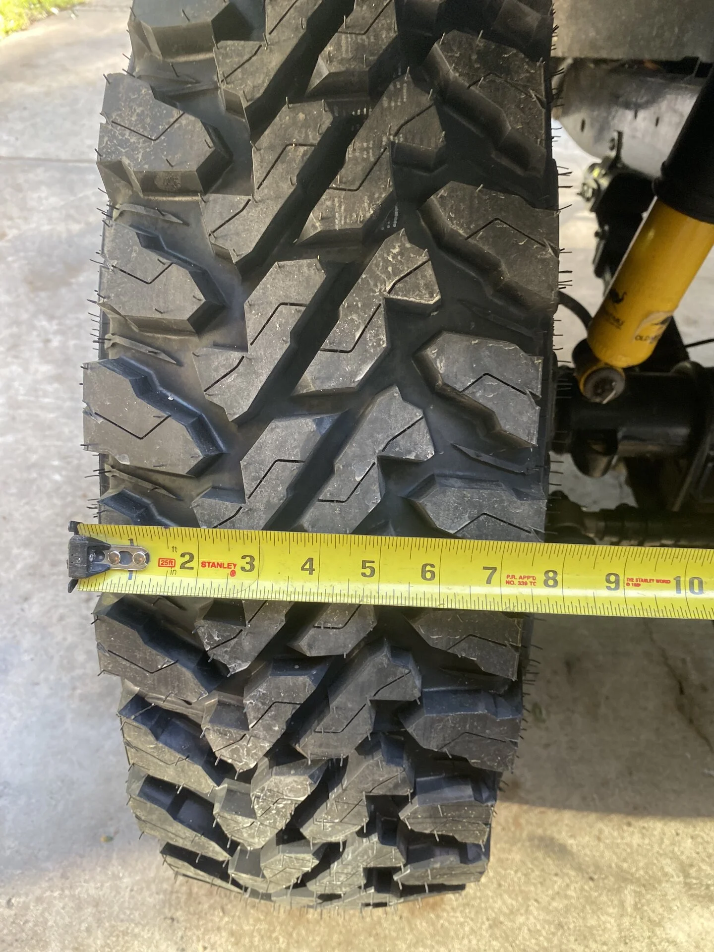

Truck has an old man emu lift. I think it's 2".
They are sub 8" wide. Did great on the trails. Not too noisy on the road.
Some inner fender rubbing.
They do rub tie rod at the end of the drag link and the pitman arm. Going to try a 1" wheel spacer on the drivers side this weekend.

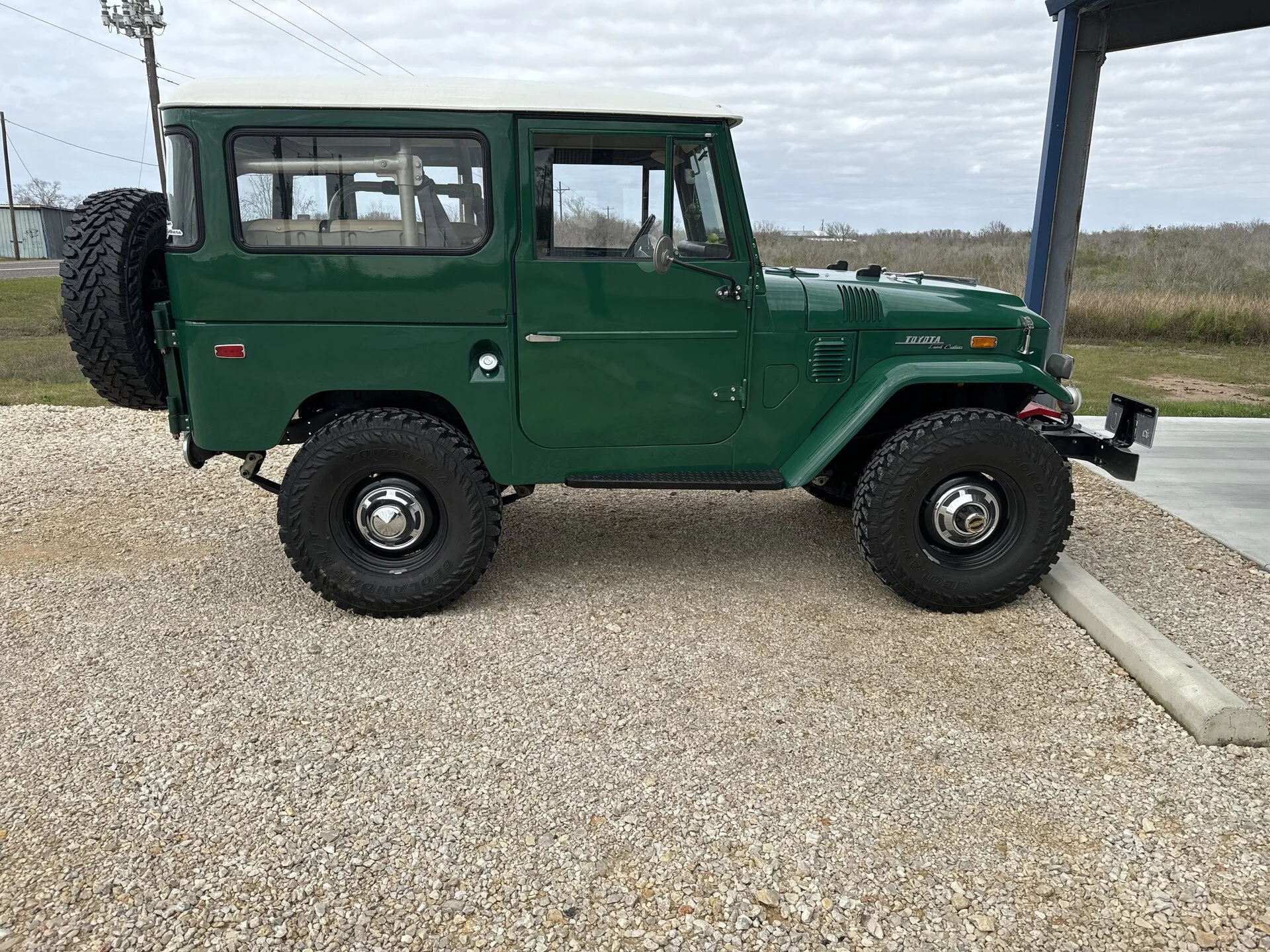

255/85 is pretty wide for the City Racer wheels. I'm sure people run the size with no issues, but I doubt a tire manufacturer would endorse it. I like my 235/85x16 on City Racer wheels.

Regarding the pretty wide statement. The tread is sub 8” wide on a 5.5” rim. Thats not much of a stretch IMO.
They rub on the drag link and the pitman arm on flat ground at full lock on my 40. I do have FJ60 knuckles on the stock axles, but that can’t make that much difference.
If you don’t wheel your rig they might not rub, but if you wheel your rig these will rub the inner fender, both front and rear. Especially up front if turning the wheel.
