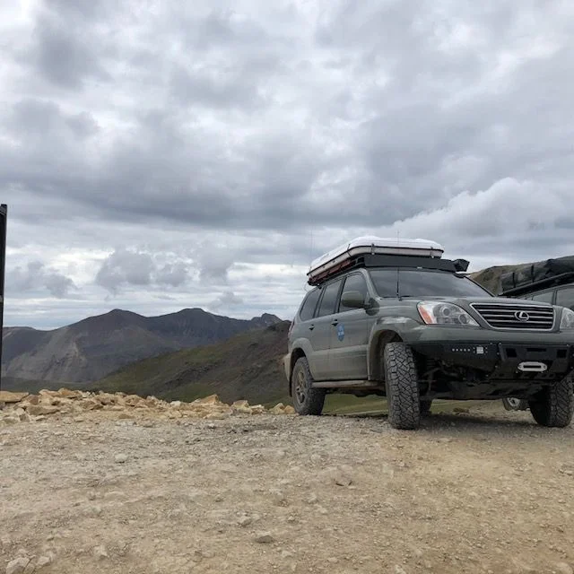

I have Cooper ST Maxx 255/80/17 on 4Runner rims with a 2.5-3” lift from MetalTech with RadFlo Shocks and Dobinson rear HD Springs, Demello front bumper and a MetalTech rear with spare tire carrier and I have zero rubbing. I really like this tire size and will stay with the tall and skinny

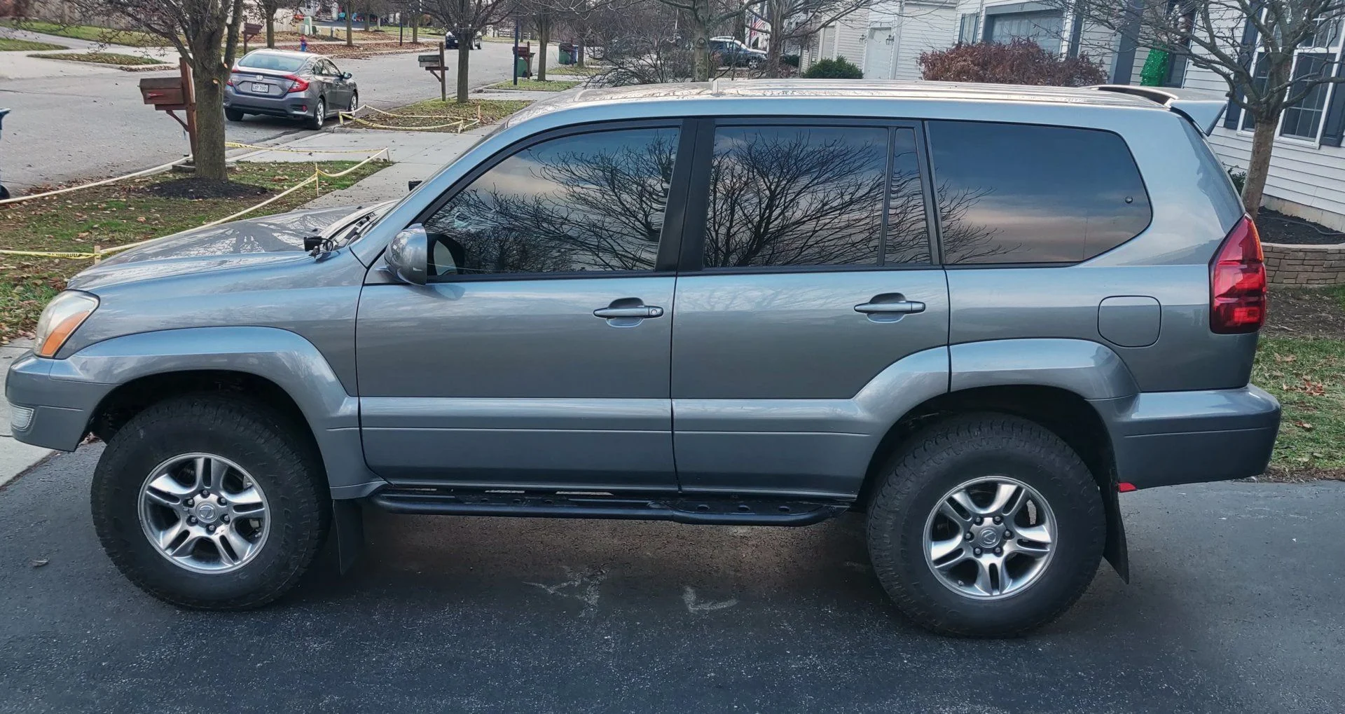

I have Nitto Ridge Grappler 255 85 r17's on stock rims. Spare fits in the stock location, if aired down, and it will rub on the panhard rod, but it fits. It looks cool, but it's not practical IMO. With stock gearing it's tough to get into 5th very much in the hills, particularly pulling any type of trailer. So performance suffers, mileage suffers, acceleration is slower and stopping distance is longer, just more strain on the truck for not much more clearance. It rubs the front frame, grinds some plastic when stuffed, I have a few zip ties holding the remaining bits back... but it looks cool.
@nakman looks very nice with that front bumper!

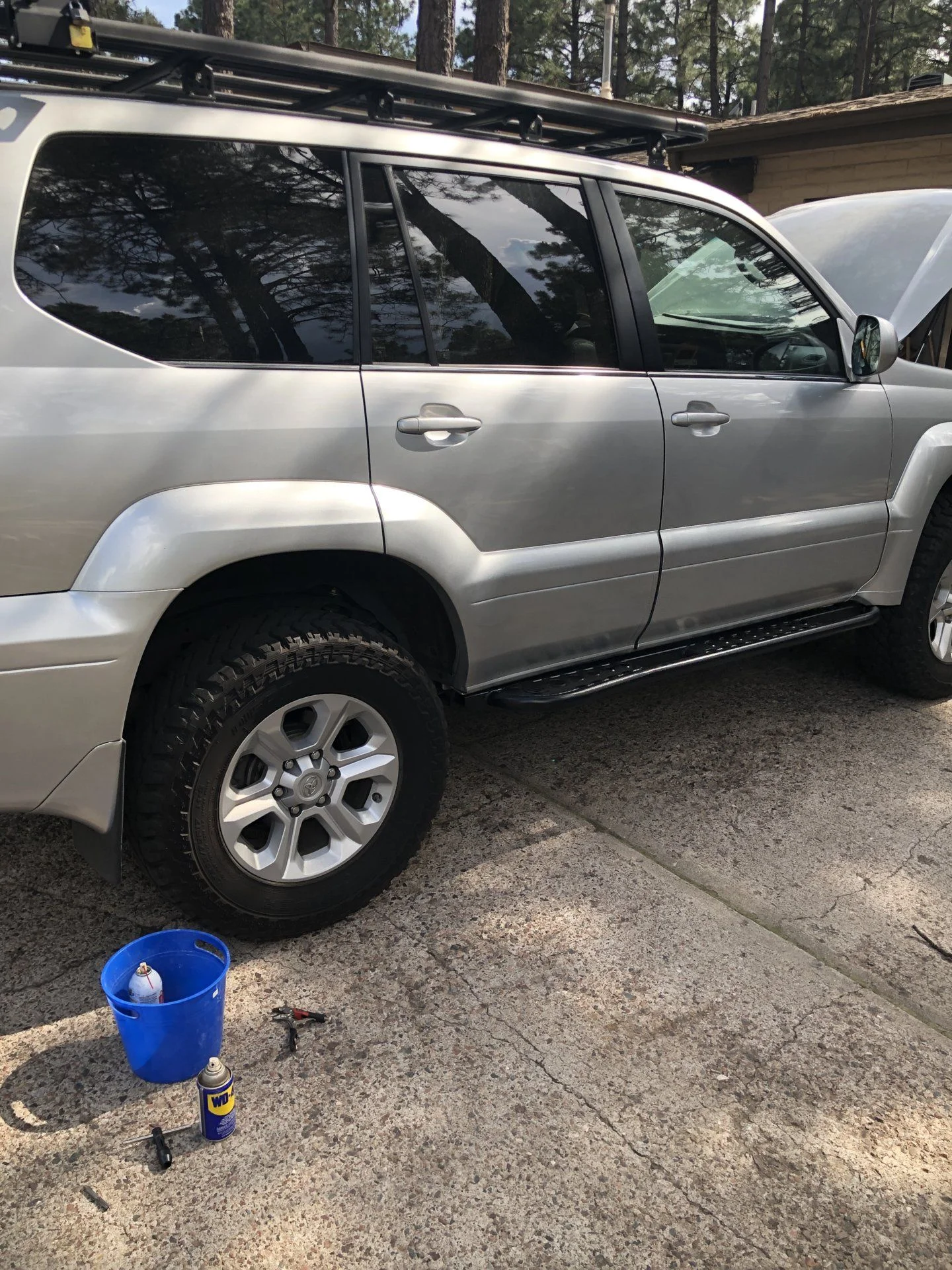

Update: Glad I made the move. Really glad. Gained about 2.5 inches in height (no more head hitting upon entry and better clearance overall, and this is also due to prog springs and adjusting front shocks), WAY smoother ride (new upper and lower arms were the key here, as lowers were rusted tight/ ineffective alignments), and I don’t notice the E rated over the Cs with the l/uca upgrade. Tad tighter feel, but that’s it. Only wheel rub is in reverse at left lock (fender mod is next), and no rubbing in Drive at full lock. In a couple of weeks, I ll be selling my low mileage 255/75s, as I can’t really justify keeping them for summer use anymore (same tread pattern). VERY appreciative of everyone’s feedback! Pics to come.
