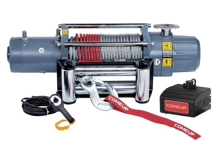

So got to thinking, so starting looking. This is the only reasonable option which is affordable
and rational for our midsize trucks. Warn only seems to have military grade, read HUGE, and
the ComeUp winches that get above 9000 are into the 150 lb weight category and I don't think
my BJ74 let alone a 24V HJ60 would want that much weight on the front bumper.
The good news, these are priced below $1000 US so with the rep as being as good a winch as
WARN which I've owned so many I'm brand loyal but they got nothing that makes sense

So like I said, the extra weight is something to consider. I'm surprised the Comeup winches
are as light as they are.
