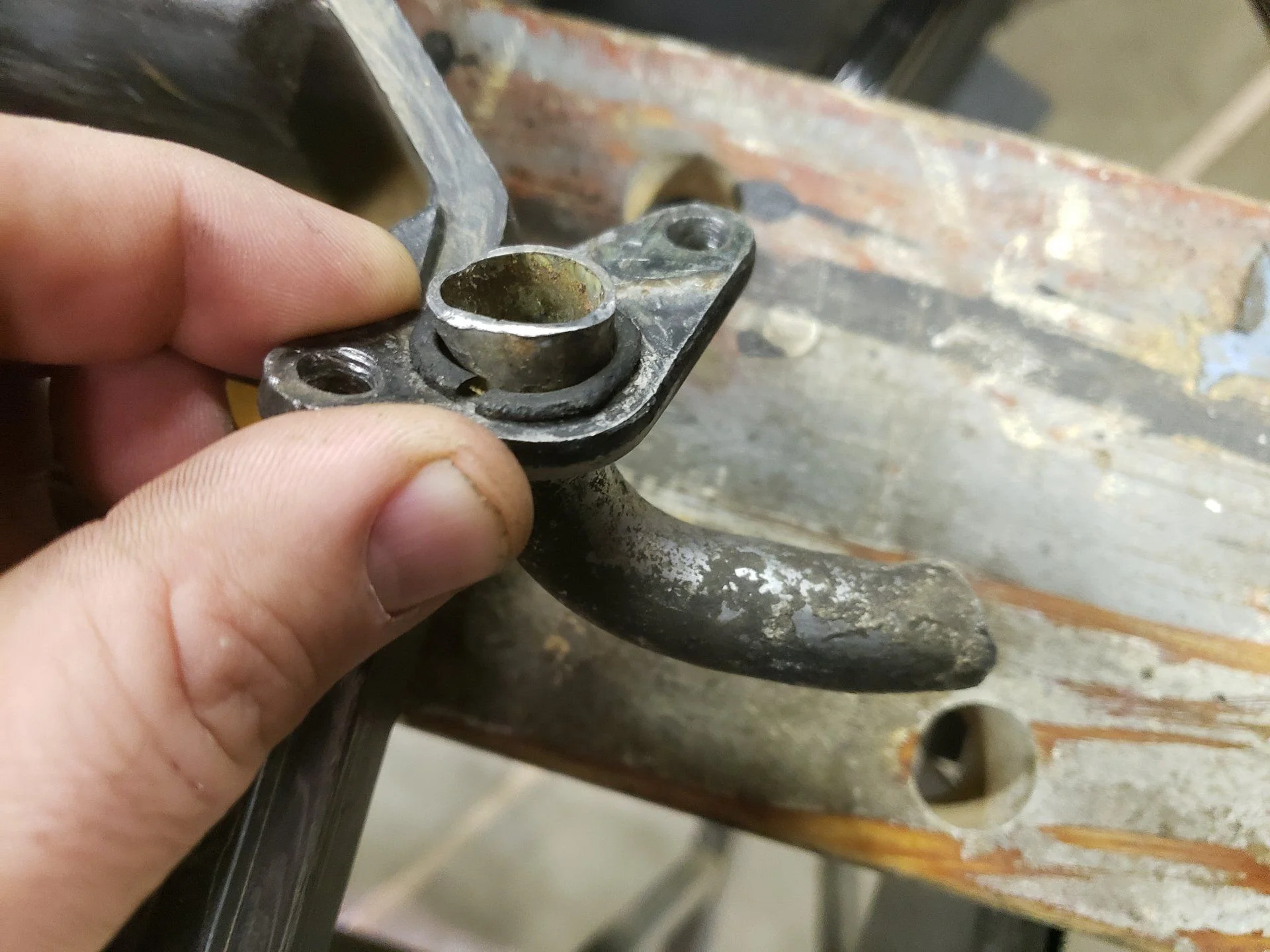

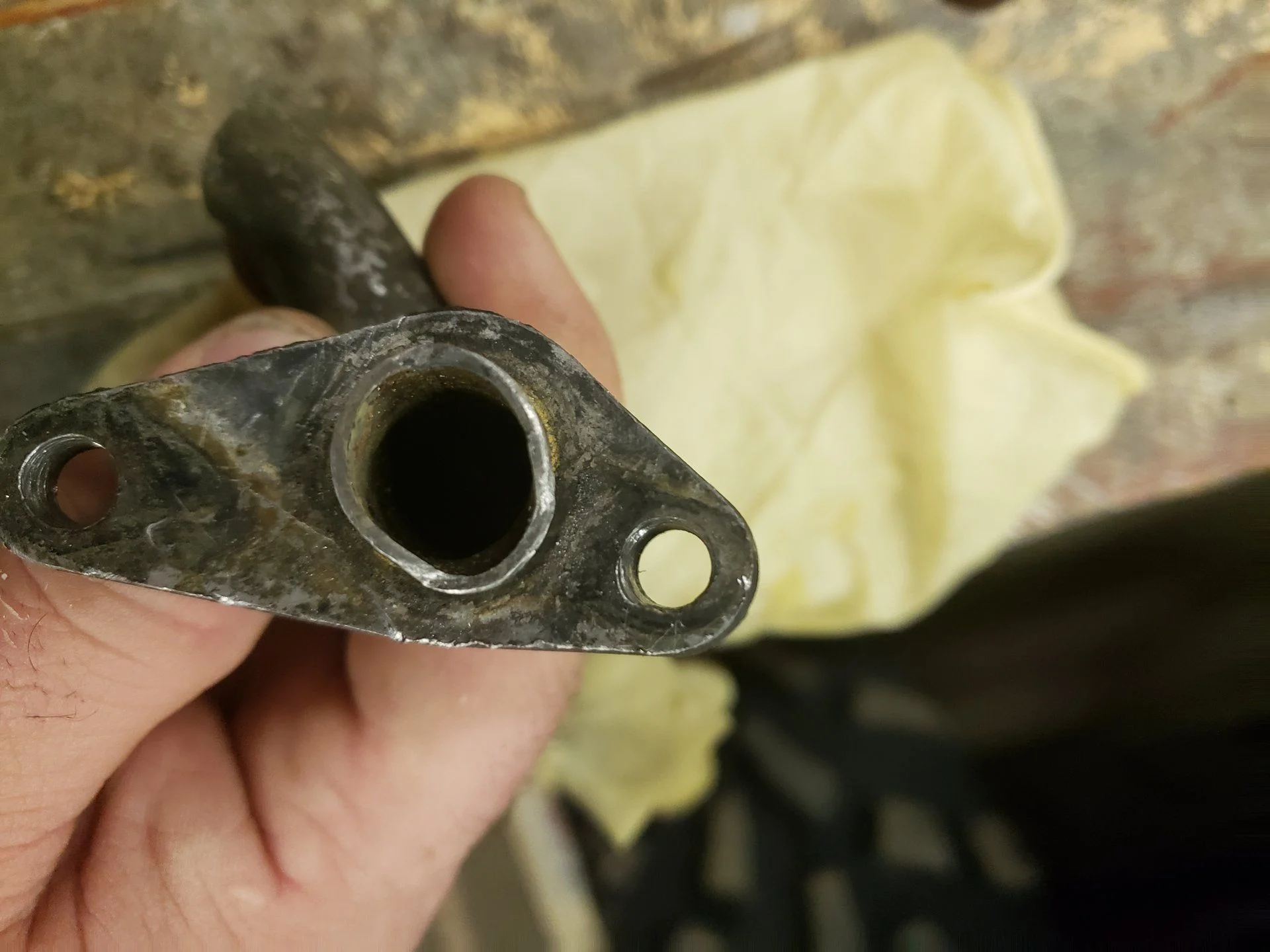

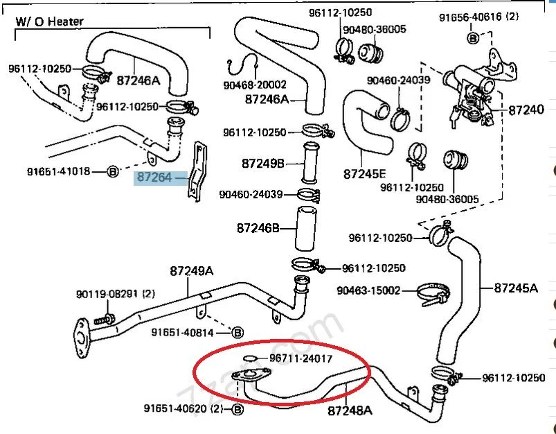

Sleeping on this. One of the heater pipes bolts up under the intake manifold. There is an o-ring that is impossible to replace with the engine in the bay. Anyway, that heater tube needs to be installed BEFORE the engine goes back in. Do the o-ring at the same time. 96711-24017, $4.88 list. It's a common hidden leak point.

Yes, I forgot about the little O-ring under the intake. I replaced it once when it was on the engine. Very slow and challenging, and the PO had used a plumbing washer. Much easier to do with the engine out. There are a couple of disassembly tips when you start rebuilding as well. Allen head bolt under the intake. Bolt through head into timing cover is usually hidden by oil.
I put in a new engine and did not do this. Mine started to leak. I hate leaks.
I thought, how hard could it be. I have done every repair to a 22re. This one kicked my ass. I won't even get into how I had to fix it.
This can not be emphasized enough...do this while the engine is out.
