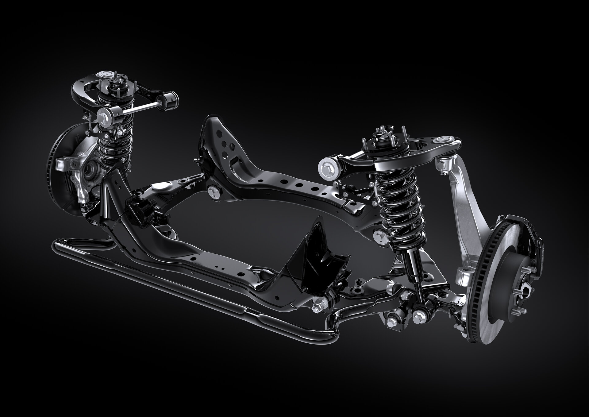

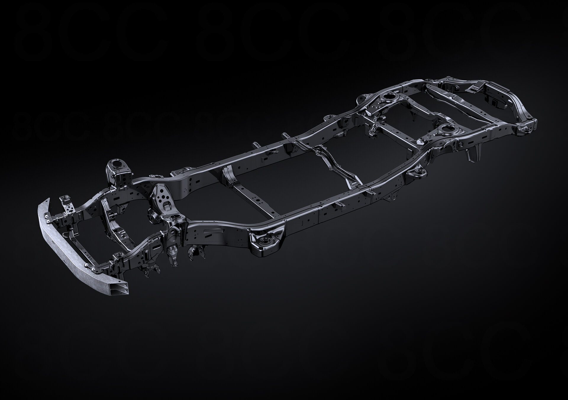

Looking at the chassis comparison, the 300-series is still larger and built to a higher standard with more robust cross sections, larger brackets, and more substantial elements. There's quite a bit but I'll just point out a few. Maybe others can as well.
1) Front bump stops - the GX has a single stop, the LX utilizes two as does todays 200-series
2) Body mounts - the two largest ones in the mid section, the 300-series brackets are larger and tie into a longer section of frame
3) Front LCA pickup points - 300-series pickups are tighter in to the frame and would be geometrically stronger/stiffer''

I think you're drinking the cool aid here. The two are 50lbs different. And the GX has significant body structure additions the 300 doesn't. I think the variations between them we can see so far are immaterial.
They are not 100% identical as everyone seems to point out. I am sure more there are more differences that we probably won't know until we see in real life.

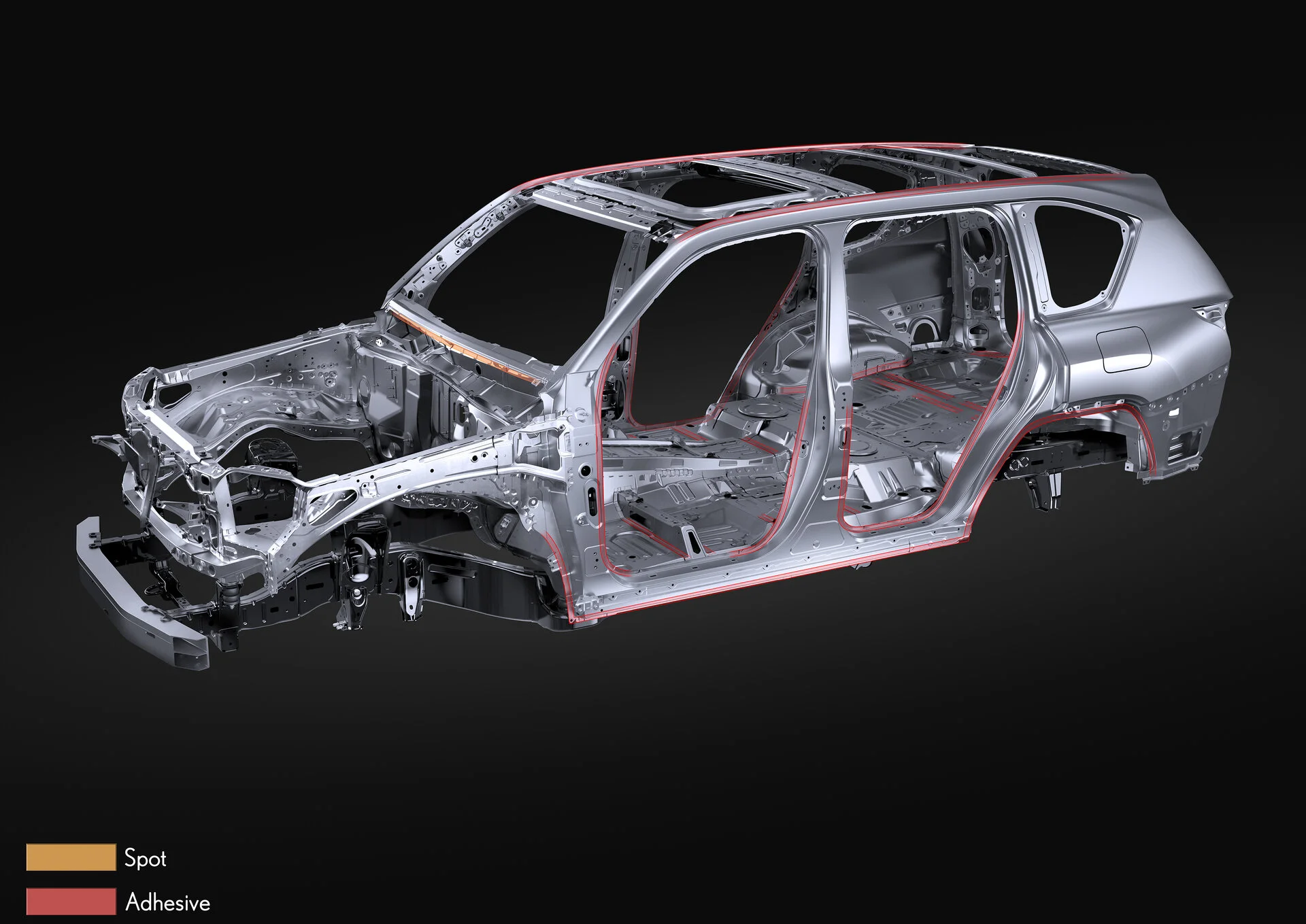

Also @Jetboy I will be fair here and share
these two photos since you mentioned body structure additions.
maybe someone can chime in and tell us a reason for the differences? I would assume obviously different bodies. different use of material would cause a difference in what we are seeing in these photos, but also natural cycle of product development and updates.
