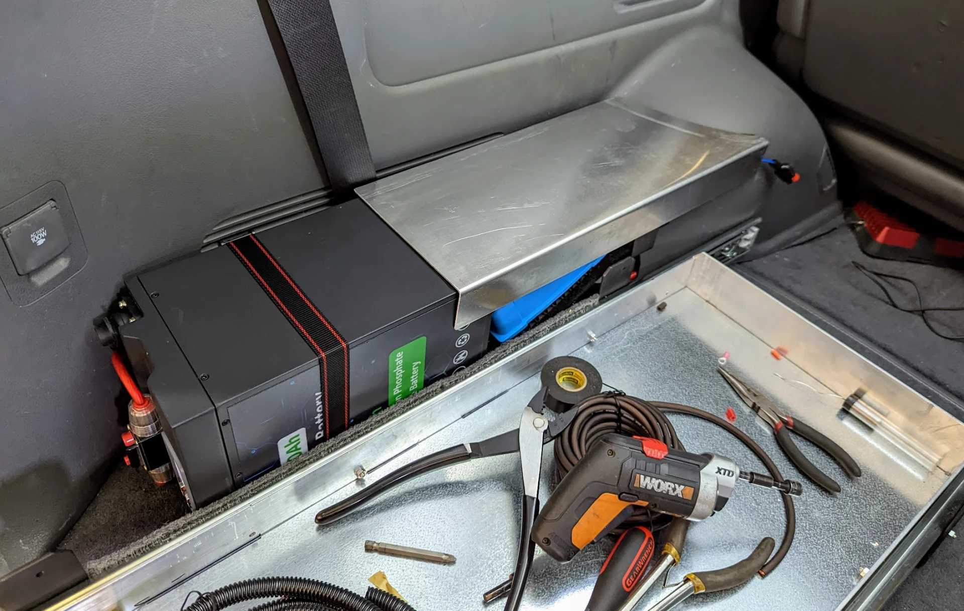

Here's some detail pics.
I'm in agreement with others that SOC for a LiFePO4 battery can't reliably be monitored from a voltage readout. Off Grid Garage has proven that. After spending the money on a nice battery, I don't want to ruin it by not having accurate charge numbers. As to the wire gauge to be ran from the main battery to the DCDC charger, that will depend on a couple things. First, the Blue Sea wire gauge chart. Second, the manual for the DCDC Charger. I'm putting in a Victron Orion 30A non-isolated charger. The manual (page 7) states at 5 meters, you need 16mm squared cable (about 6 gauge). The other thing is that the terminal block on the charger won't take any larger gauged wire, so you're pretty much stuck at 6 gauge.

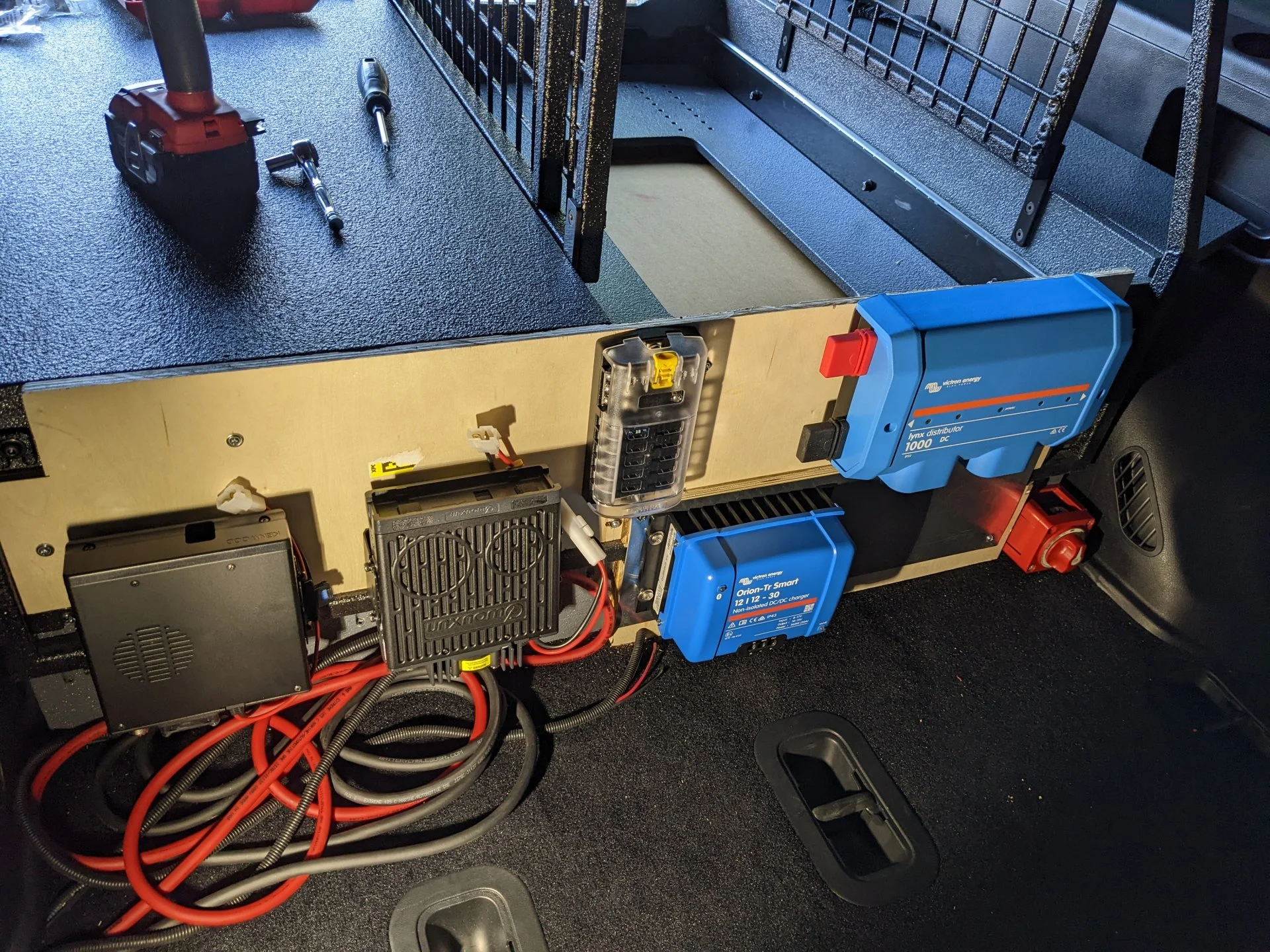

Here you can see my in-progress build.
Yesterday, I was able to complete the wiring to the Lynx distributor from the Orion. I used ferrules and lugs to connect it all together and heat shrink to clean up the ends. Today, I will finish wiring up the fuse block and get the radio power ran to the fuse block.
The Orion will be pulling it's power from a Blue Sea SafetyHub 150 under the hood on the Slee Accessory Tray. It will have the manual recommended 60A fuse. However, I need to find the best path to run my 1/0 positive/negative wires from that location (passenger side) to the main battery. I am hoping others that see this thread can show their preferred wiring path for the main battery hookup.
The nice thing about the Orion charger is that it can run in a couple modes. Charger mode (of which it can charge multiple battery chemistries) and power supply mode. Until I get the battery, I will be using power supply mode.

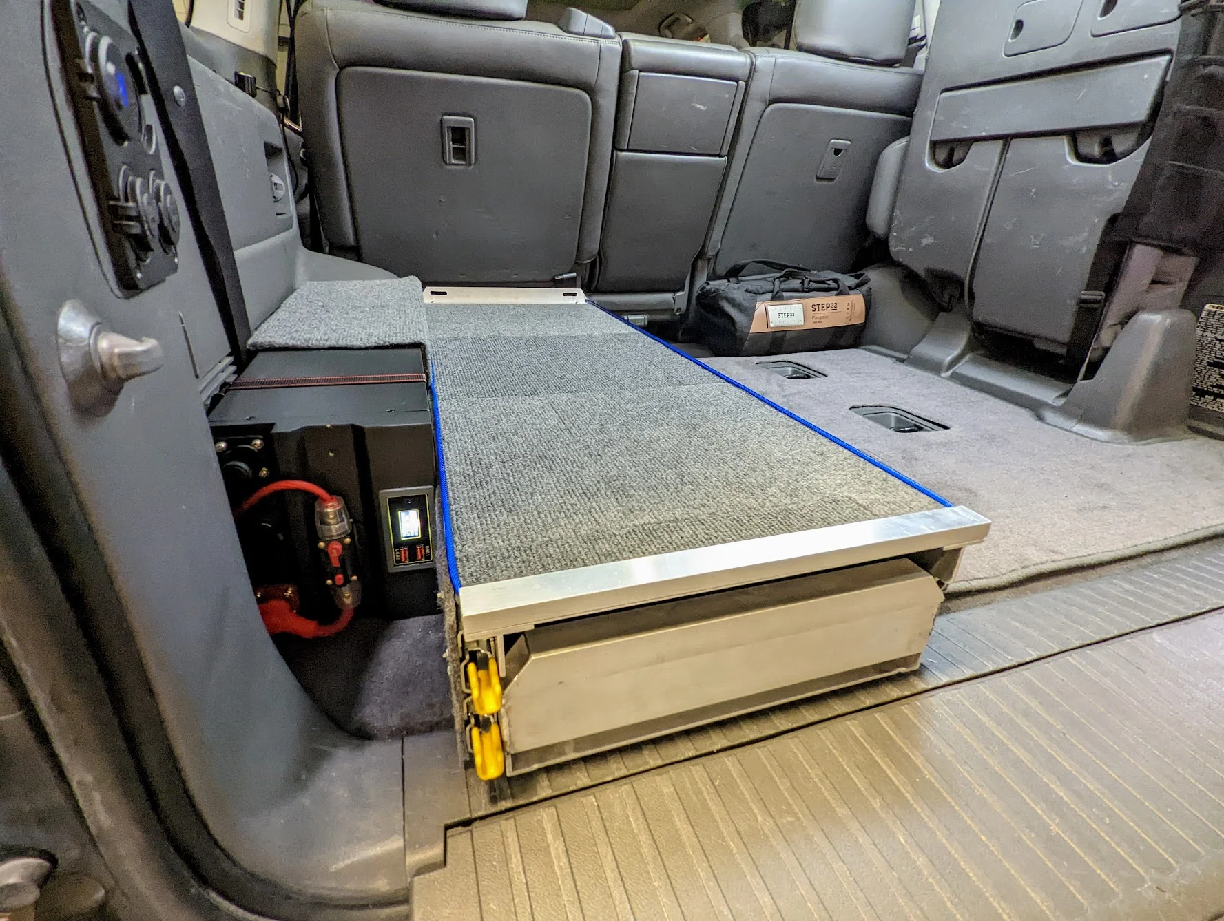

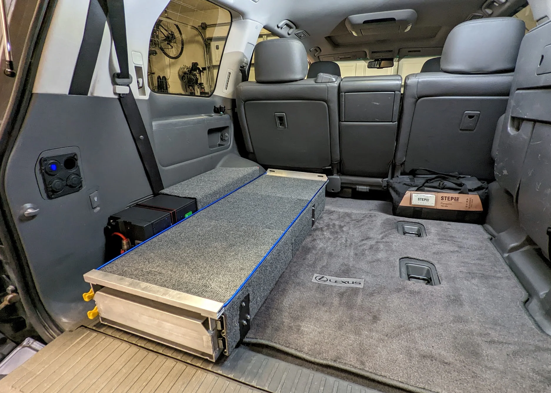

As compact as the GZ is, it still takes up space. I have to position it in a way that protects the things plugged into its face, taking up more space.
This is a really big problem that none of the battery-in-a-box are realizing. Recessed plug in panels would be a gamechanger. It's the main reason I built my own so I can create those flexible leads or recessed outlets.....
