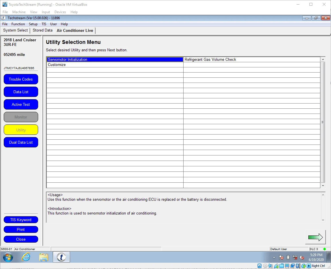

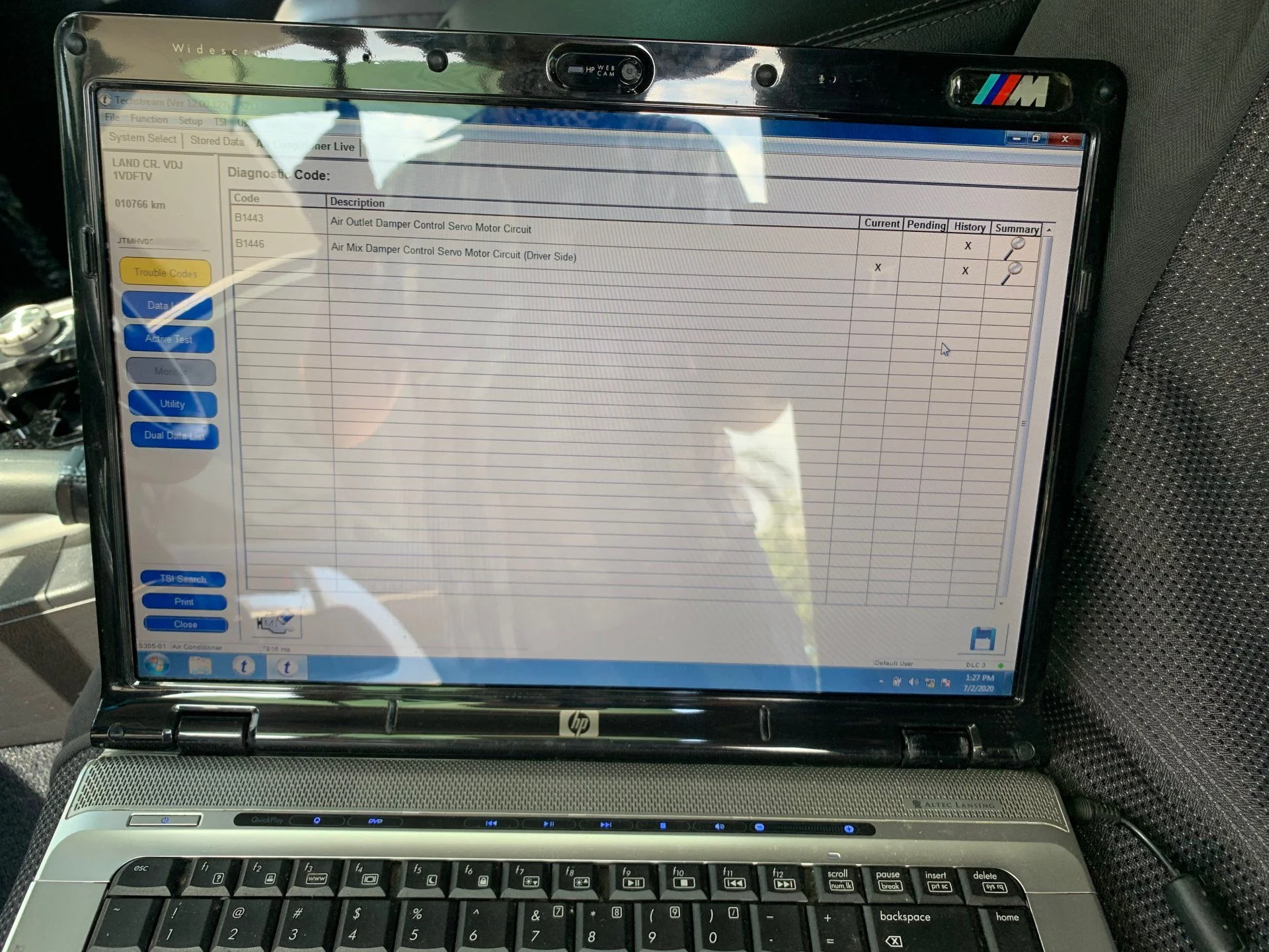

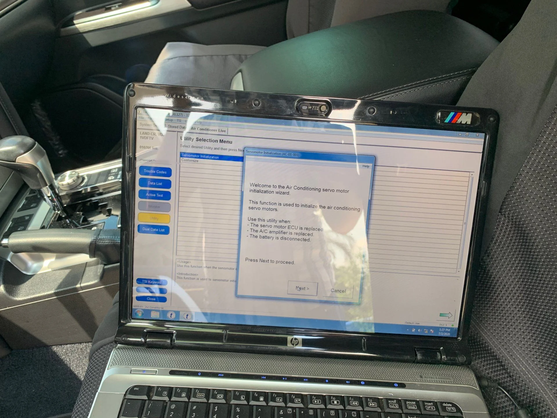

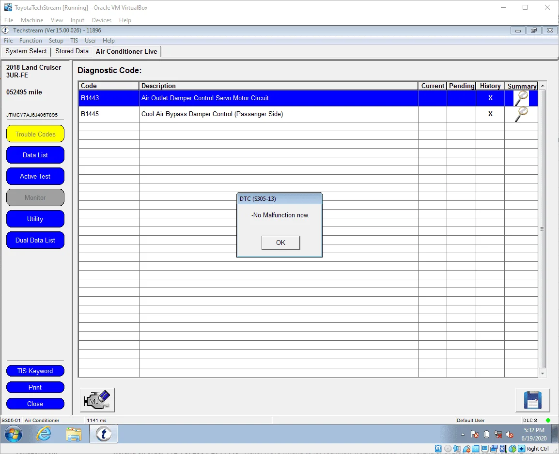

Conveniently, mine started working again all by themselves after a couple days. I did go ahead and buy VXDIAG VCX Nano w/ Techstream V15.00.026. Was able to connect up and peruse around all the diagnostics - pretty awesome tool. There were actually DTCs for both the servos, but also said they were no longer malfunctioning. I went ahead and did a servo initialization anyway.

Okay so I re-initialized the servo today using Techstream. Let’s see how long it will last before I have to do it again.

Ugh. 2019 LC 200 here. I'm experiencing this problem. I found this thread, bought a vxdiag thing and techstream. I've reset it but it is only working for a couple days before it reverts back to the problem. Anything more I can do other than the servomotor initialization?

Does anyone with Techstream know how long the codes stay stored for after there has been an issue? I have has the no vent flow condition previously and the dealer reinitialzed the servo which it sounds like is just a temporary fix and maybe for not all the possible failure modes. The TSB says the condition has to currently exist or there has to be a stored code to get it performed under warranty. Im at 33k so only 3k of warranty left. So after they would have done the servo reinitialization previously would that have reset the codes? Or will they still be there in the history so I can get the new calibration to prevent this from reoccurring?
When I reinitialized the servos in mine, it did not reset the error codes that existed. There is a different function that clears the codes. I would assume the dealer would have cleared all the codes while they had the vehicle, though.
This past Thursday I brought my 2018 Land Cruiser into the dealer along with a copy of the TSB dated May 27, 2020. The existing symptom was that only one vent was blowing air. When the tech checked for ECU trouble codes, it showed B1486, which is a malfunction in the driver side air outlet damper control servo motor unit. He reflashed the air conditioning amplifier with the new calibration file update. This update applies to 2017-2019 Land Cruisers with an effective VIN of JTMCY7AJ#H4059943 or later and it fixed my problem.
