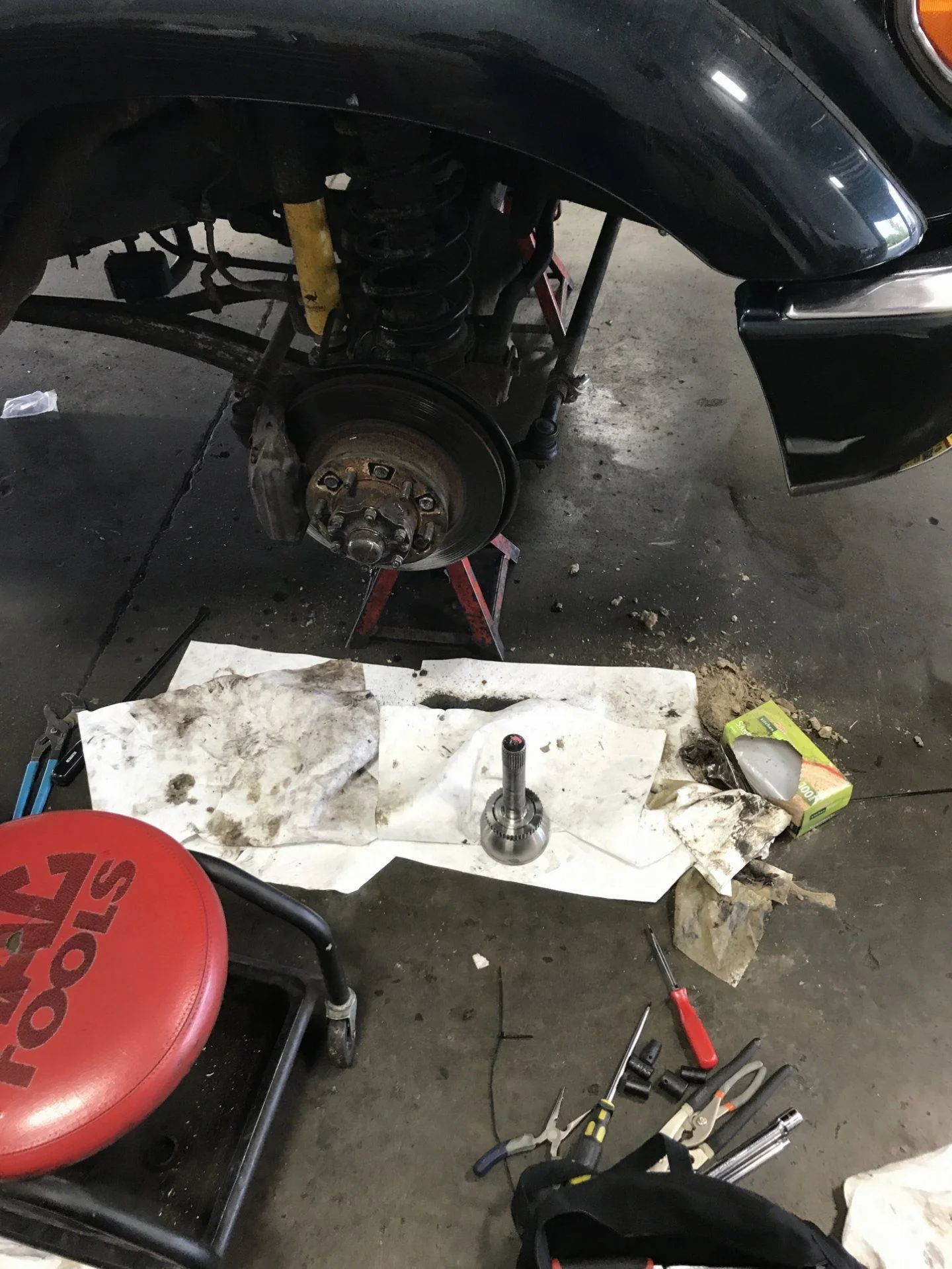

New birfield and sway bar drop brackets. Getting ready for flat nasty.

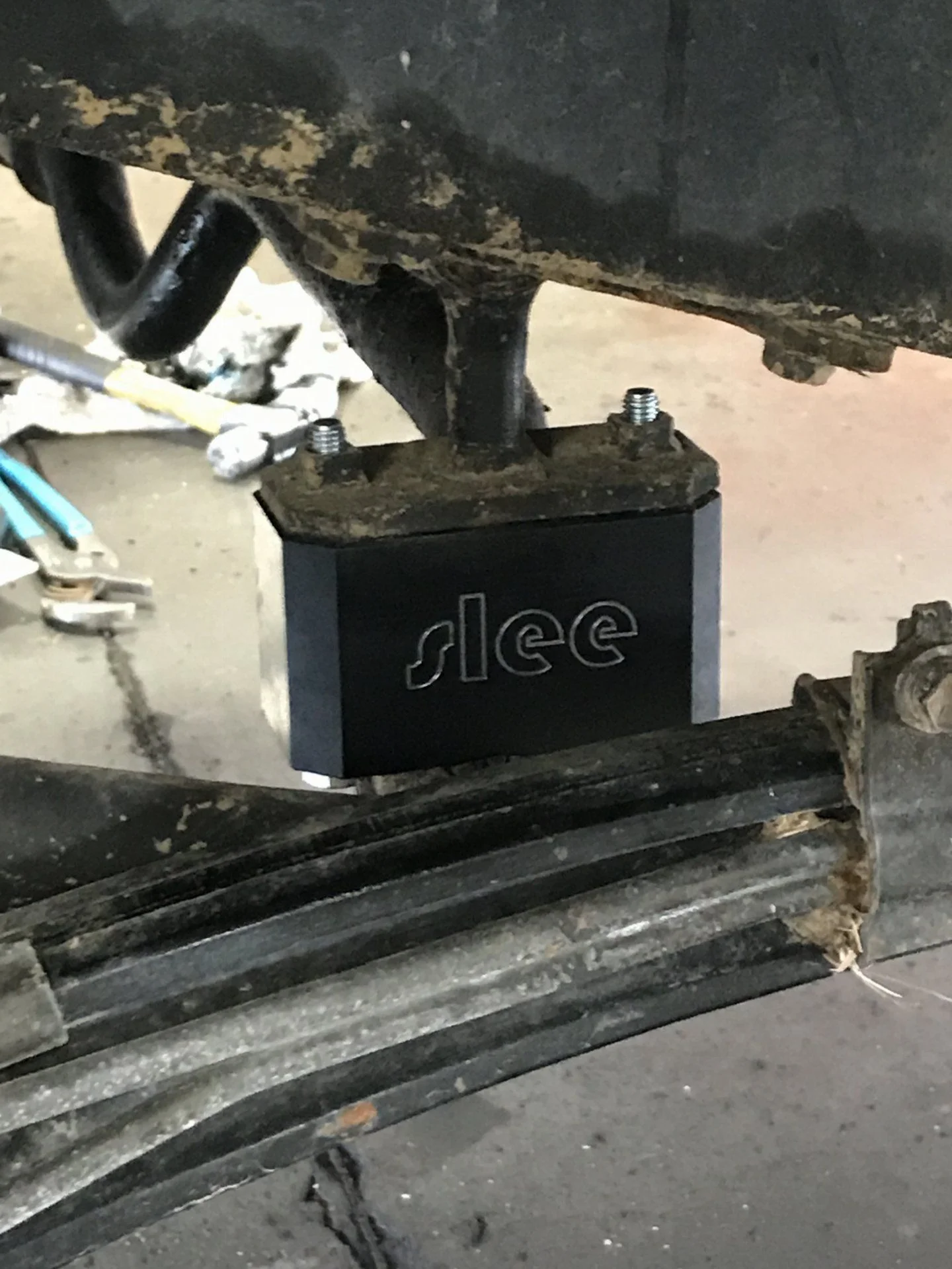

Nice! I just threw a set of those on Saturday as well, along with 1"spacers and Slee's castor correction plates for 4" of lift.

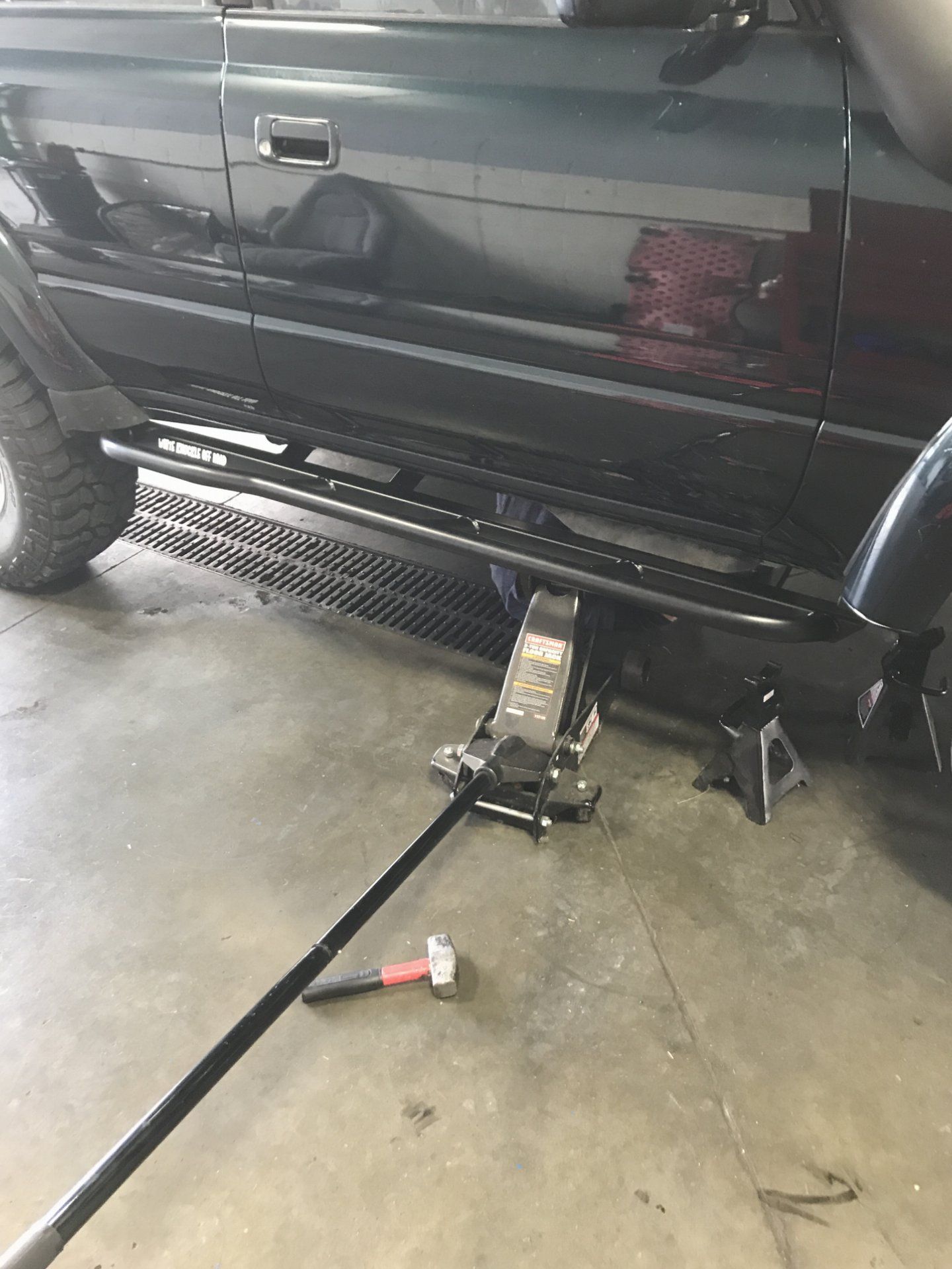

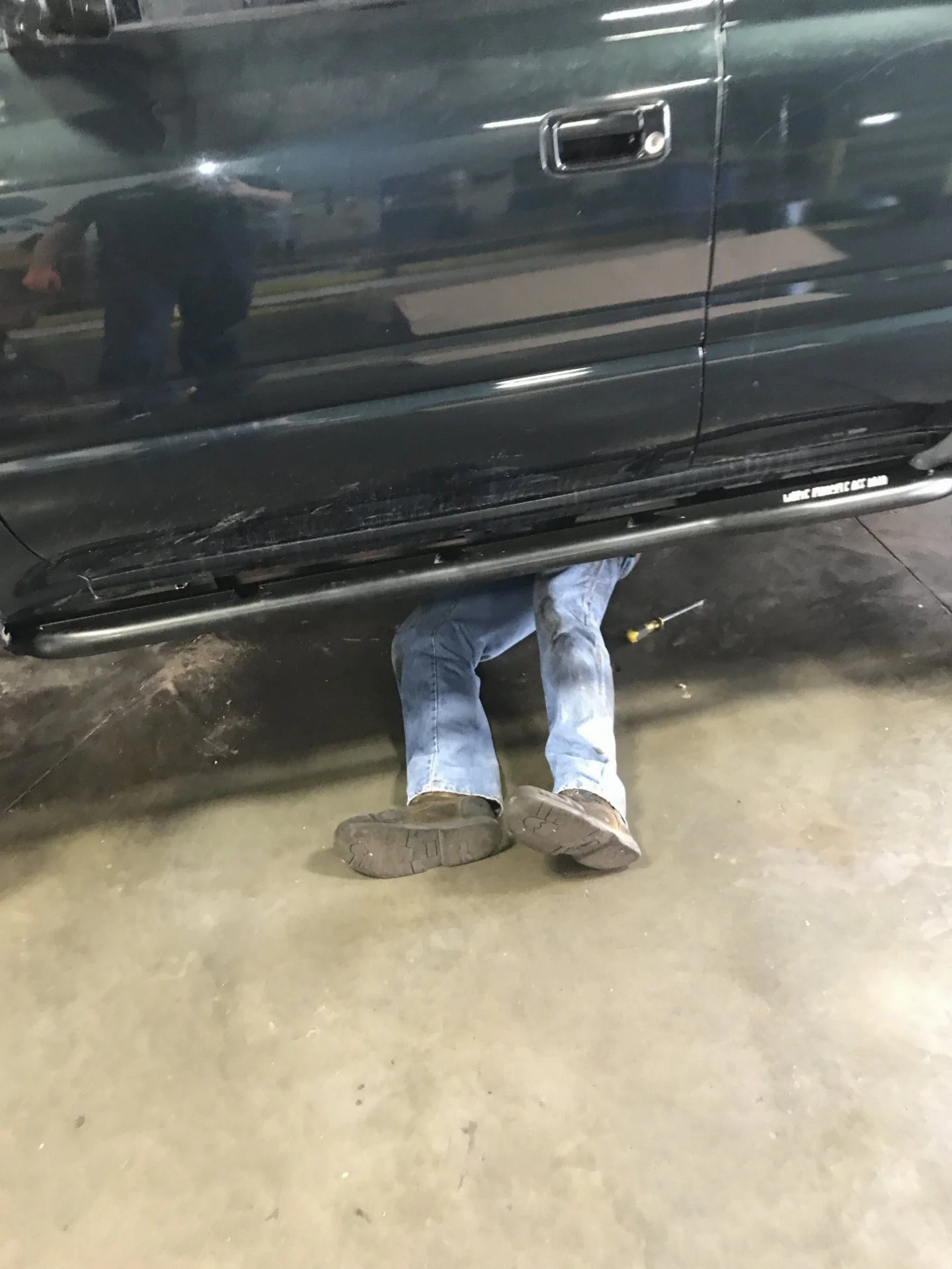

And A DOOR!!! ...... of course this would be the third door now, so this is becoming normal maintenance for you.
Yep, as you said Saturday, "should be good for a few more weeks!" :deadhorse:

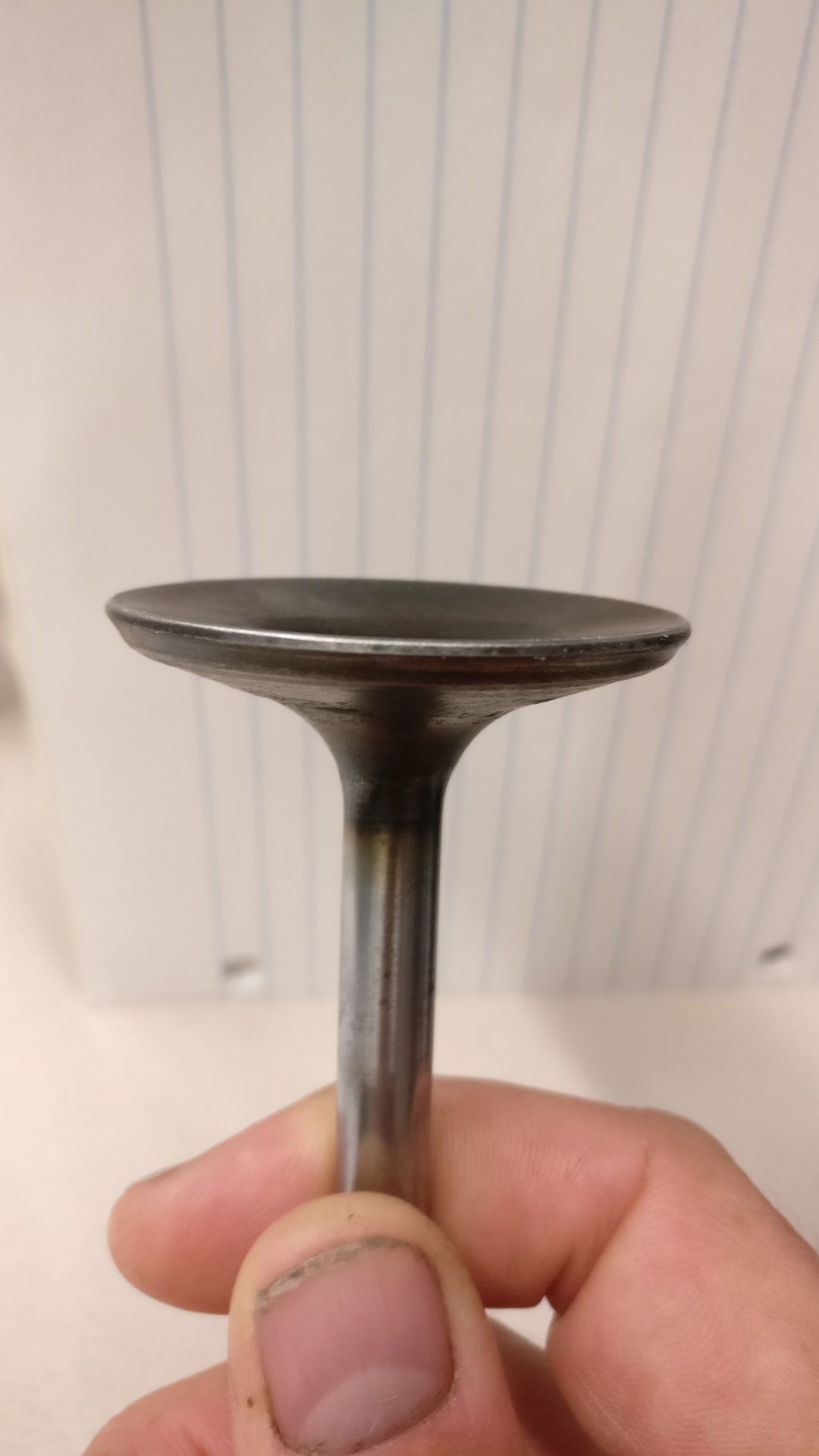

The engine in my 40 was running a little rough, so I ran compression test and found cylinder number 7 sitting at 0 so I tore it apart and found a nice bent valve in it. the top is even caved in
I'm asking the dumb question. Is that the new valve? And how does a v8 piston contact the valve? They aren't interference engines are they? Yeah I'm v8 dumb and we have 2 of em
It's the old valve. Non interference engine.
In the first pic the shaft should be parallel to the lines on the paper. In the next pic only the center area should be dished. The outer flange area should be flat with a taper around the valve seat.
Suspect that when it started leaking it got superheated by exhaust gas blowing past it and then the valve spring started working it like a hammer on anvil of the the seat and dished the whole valve.
