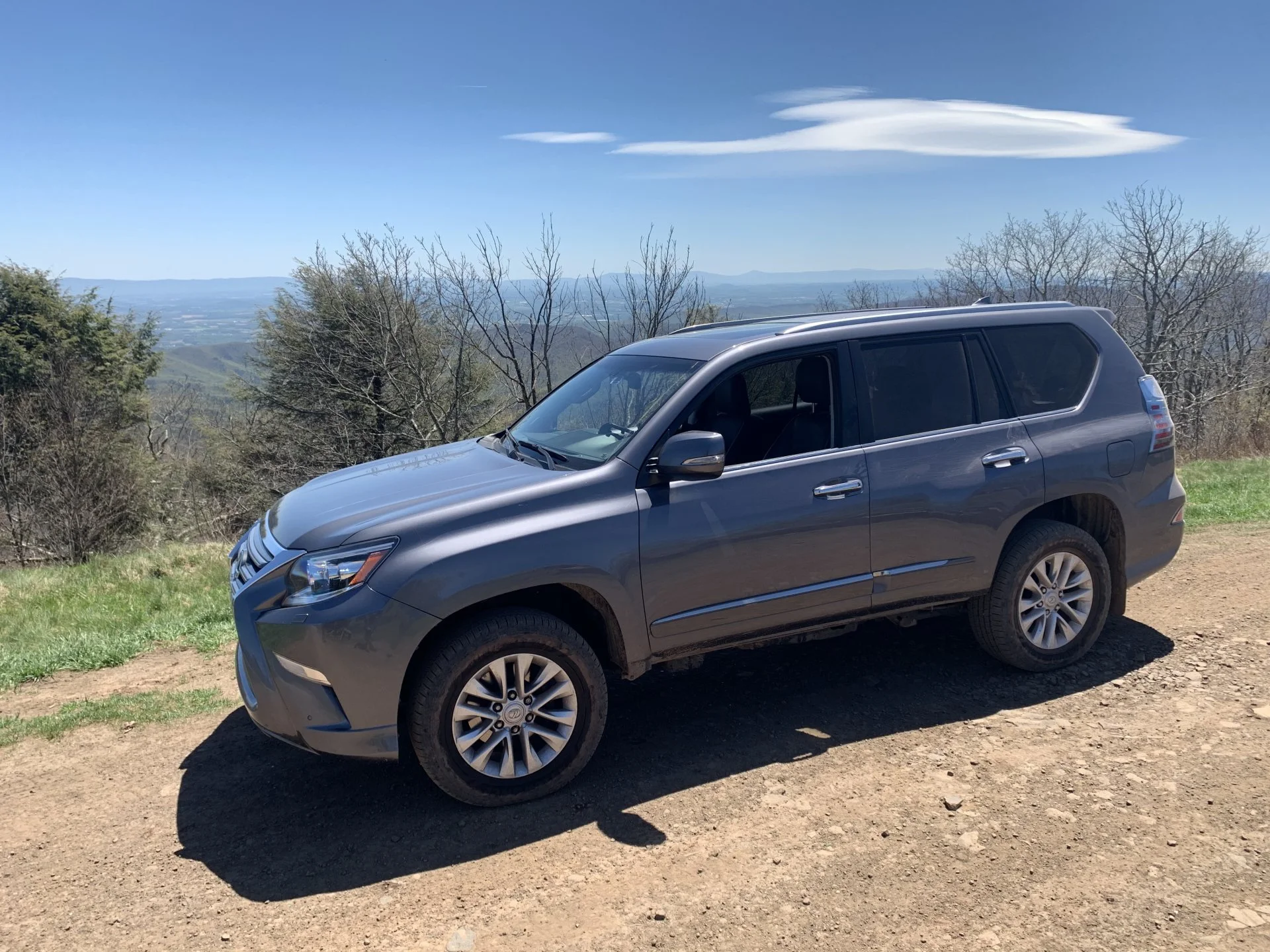

I grabbed an off-lease 2017 GX 460 Premium with 26k miles in April 2021. It happens to be a “Certified Pre-Owned Lexus” for whatever that is worth which is probably a topic for a separate thread. I was coming off of a rusted-out 2007 FJ that I didn’t properly inspect for rust when I purchased it in 2018 -- I grew up in Arizona and was clueless that rust could be an issue. Despite my love for the FJ, I’m glad to be out of that rust bucket and into this spectacular vehicle. I thank all the folks in this forum for your posts and reference material that I spent weeks reading through during my pre-purchase GX decision making and subsequent build research.
I’m in the DMV area and love to head to the “mountains” in Virginia and West Virginia. With this in mind, I want to build my GX into a mildly capable offroader. What do I think that means considering a stock GX is already super capable? I want to add clearance, improve appearance, and go overboard, but not too overboard.

(May 1, 2021 at Flagpole Knob, VA)
