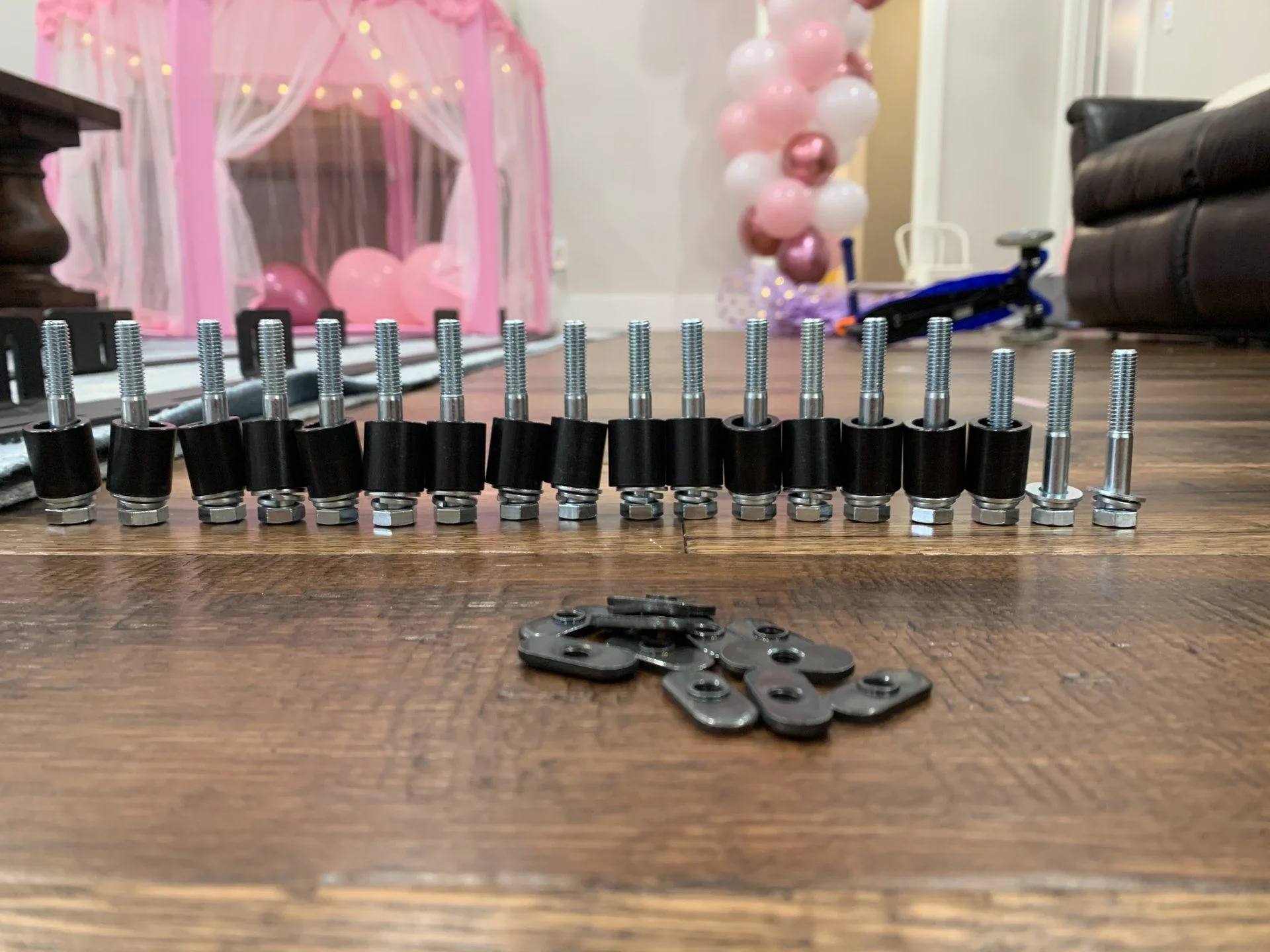

I had planned on documenting my weekend of rack install, but I already have a silly question.
After sorting all the hardware, I noticed that 3 of the roof bolts are shorter than the others.
All 16 spaces are the same size.
Did I accidentally get 3 short bolts, 2 of them being spares?

Ok I'll be the one to ask: what is that pink thing in the background?
I have 4 kids under 5, 3 of which are girls. There’s always pink crap everywhere.

-after staring at the bolts that Prinsu sent, most of them now seem too long. Should the bolt threads start after the spacers? There’s currently about 1/4” with no threads.

I just installed mine last week. All my bolts were the same length. I used clear silicone to seal my holes. I used it (along with many others) on my 80 rack removal and had zero water issues through a central america rainy season.

Originally the racks came with two different height spacers, 7/8" and 1", presumably to fine tune to your individual roof or rack. Ultimately I "fine tuned" my installation with a few strategically added stainless washers to avoid putting any uneven pressure on the side rails. So with only one height spacer, I'd recommend having some same I.D. and O.D. washers on hand just in case. I'm sure you could just crank everything down, but I chose to use the washers. In the end, all of my spacers ranged from 7/8" - 1 1/8".

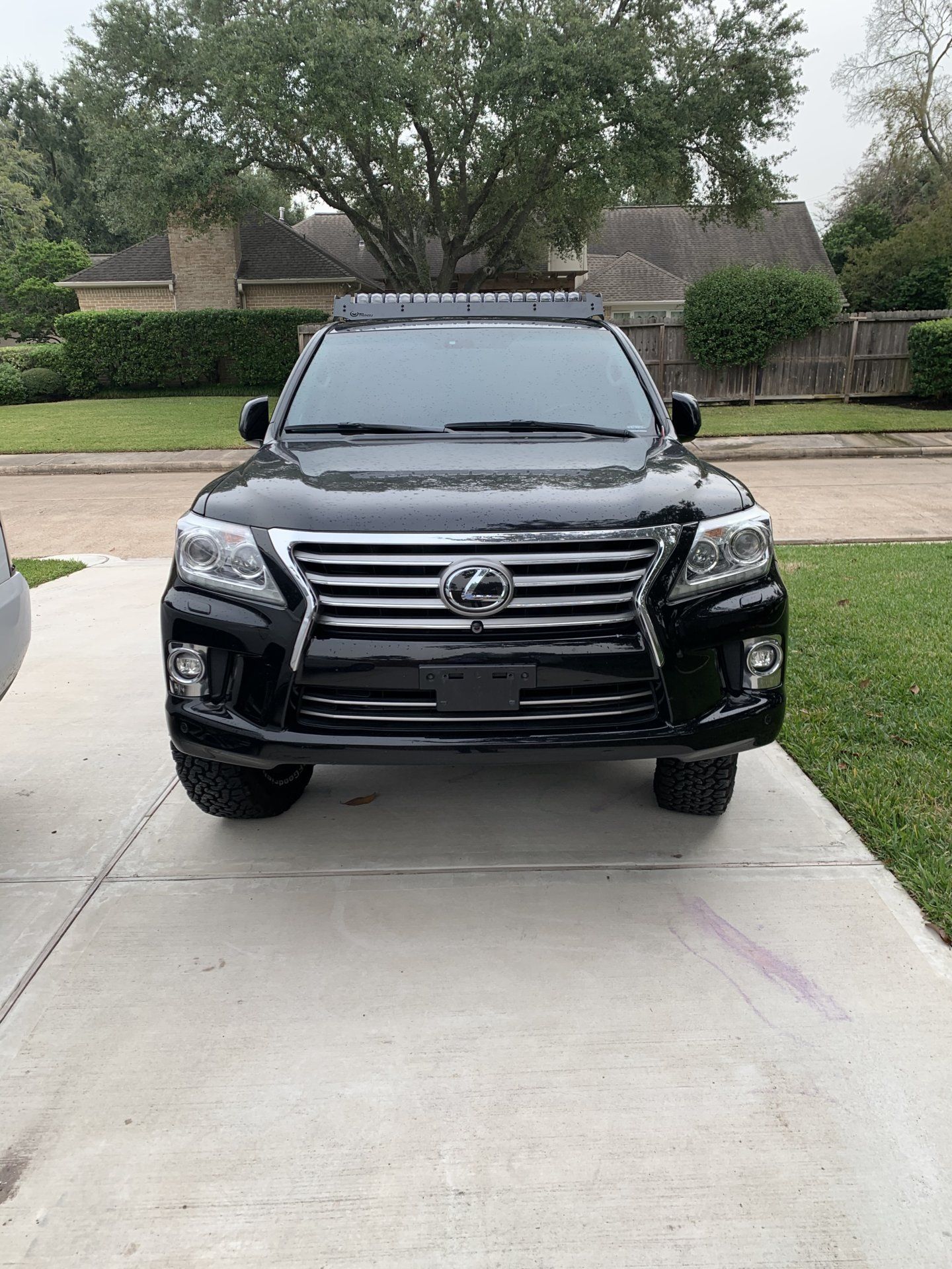

Still need to move down the wind deflector, install the noise trim, and wire up the light bar. The adapt is freaking HEAVY and is causing a lot of vibration.
That's a great looking rack. I'd be interested to know your opinion on the wind noise once you get everything complete.

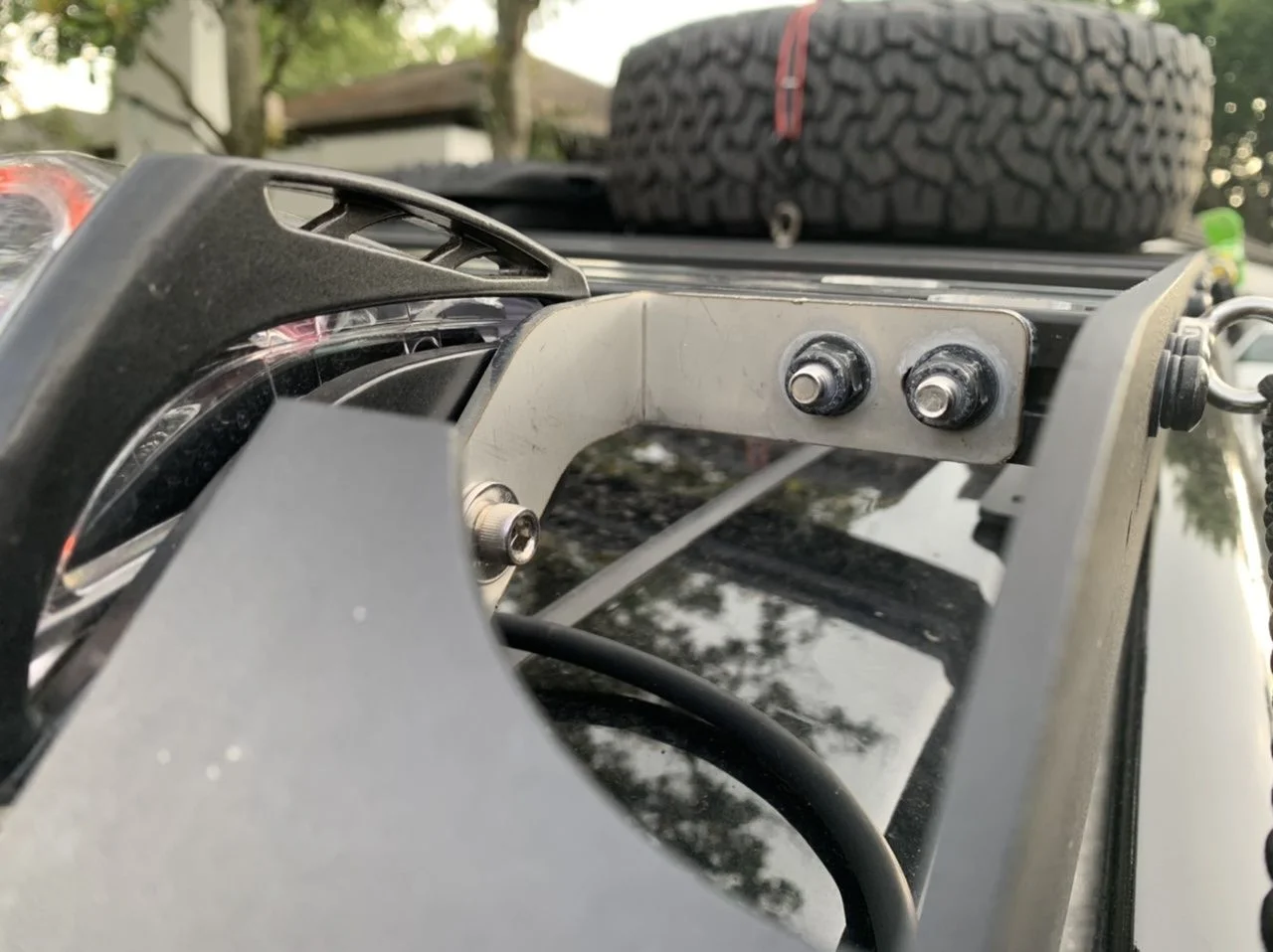

Adding more pics for a fellow mudder:
The load panels significantly strengthen the crossbars. I weigh 180# and wouldn't be able to stand up top without a lot of flexing.
