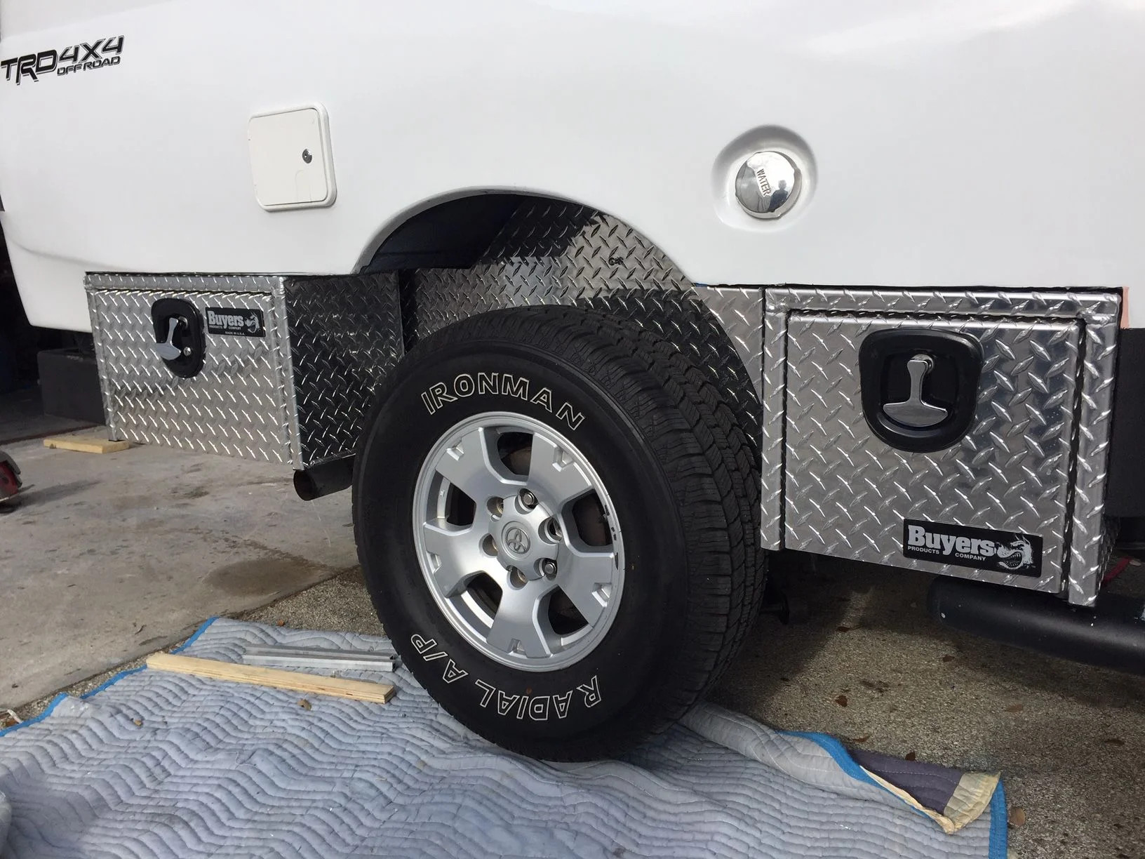

Got my hand held shower plumbed and mounted on a diamond plate bracket inside the forward utility box on the drivers side.... for the shower, I ended up with a bidet sprayer. I found out it is tough to find a hand held shower with a trigger valve.

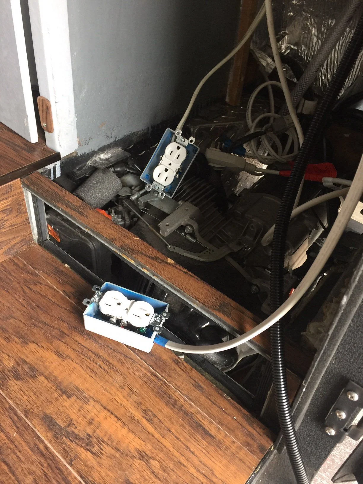

I have been busy doing other stuff. Guess I needed a break from this project but got back to it today! Got all the 110 volt side together today. Tested the outlets and good to go. 12 volt side next! Feels good to be back on it! After the electric I can finish the interior details...wall covering, upholstery etc.

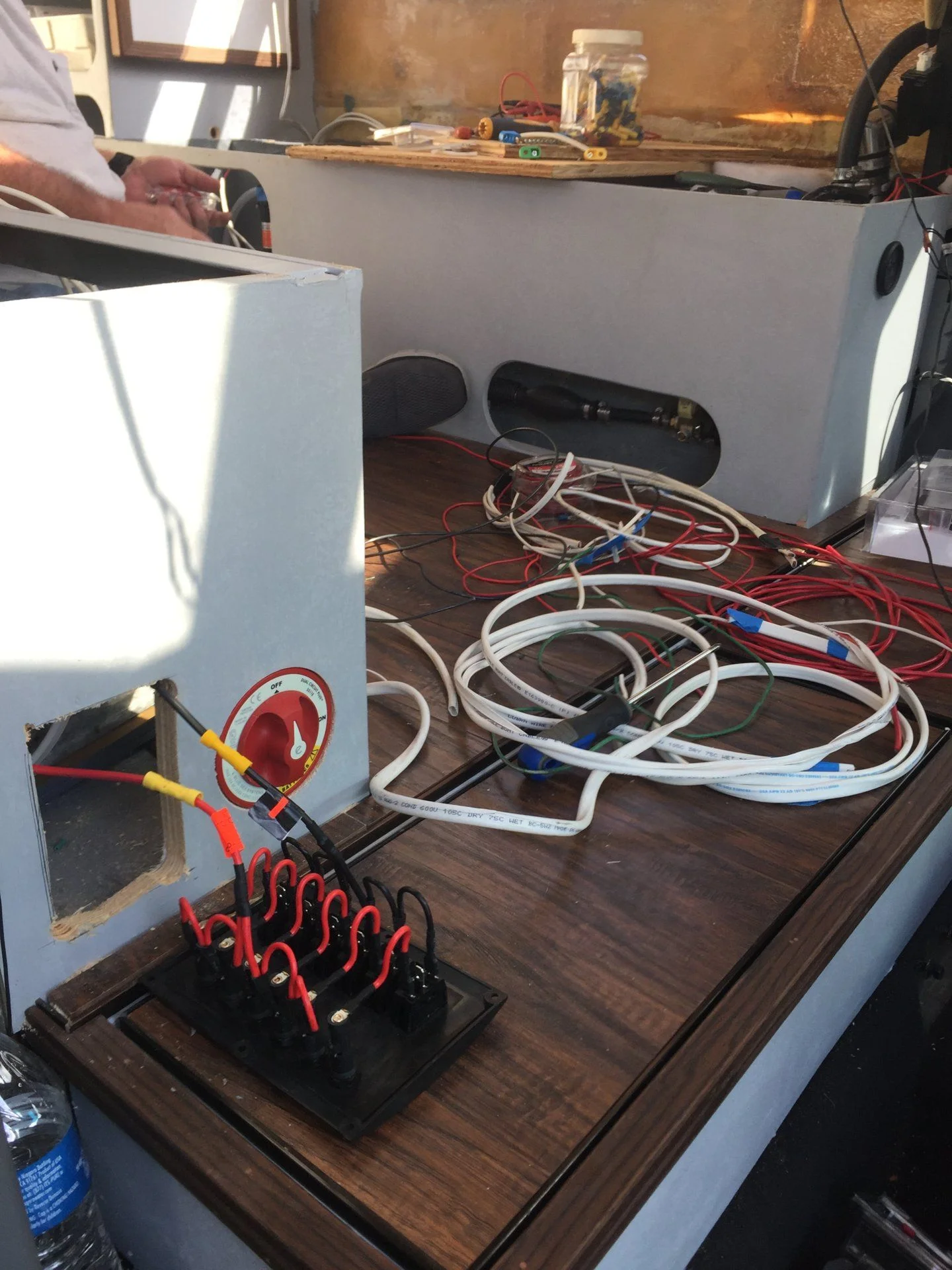

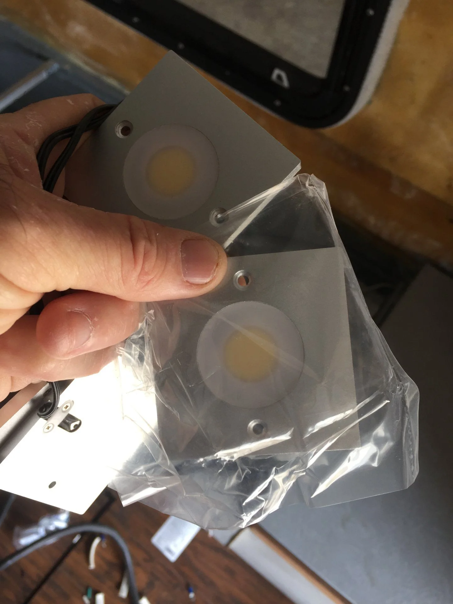

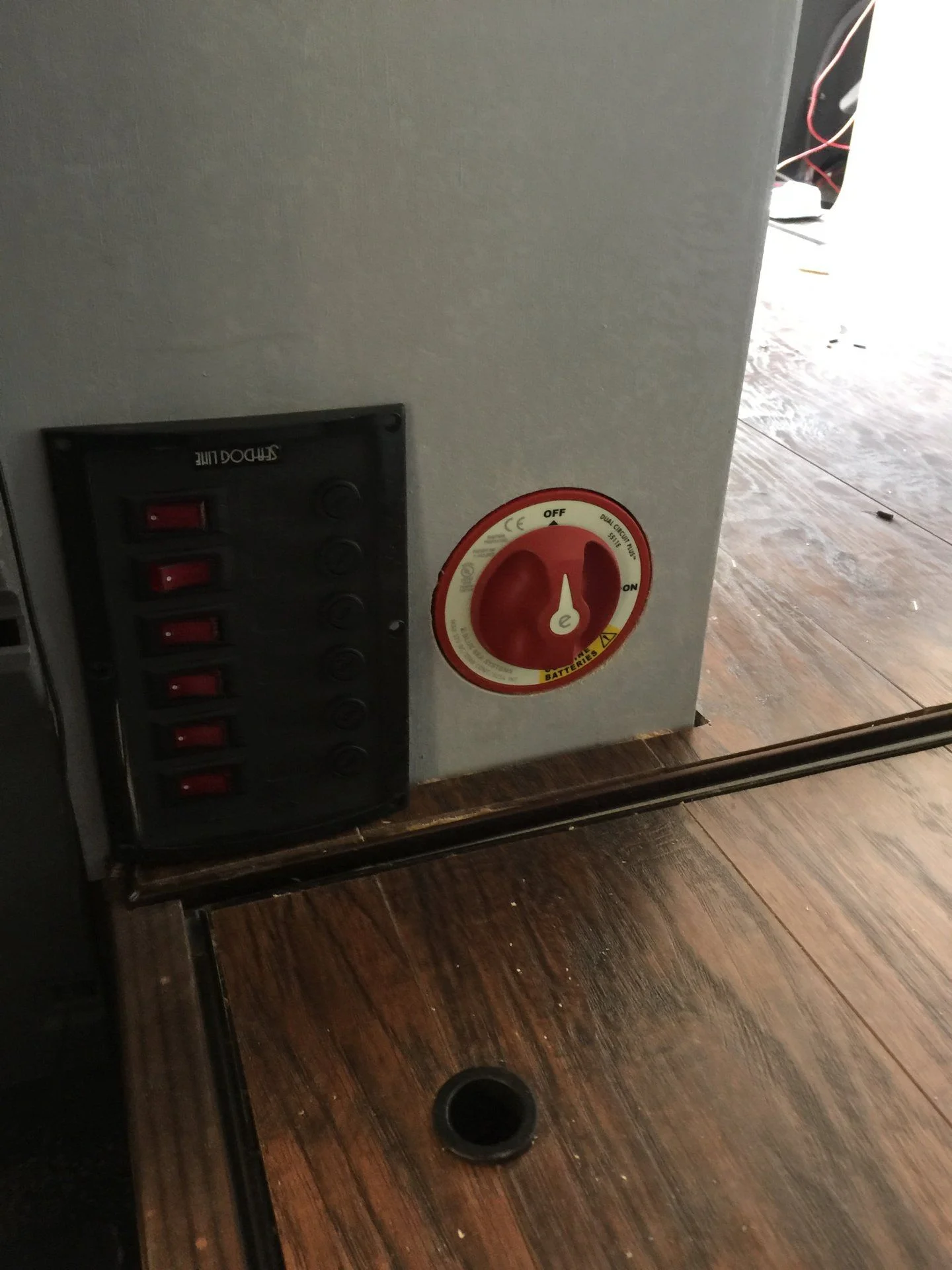

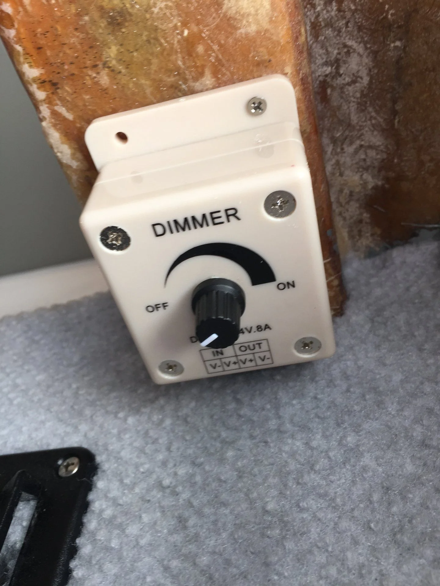

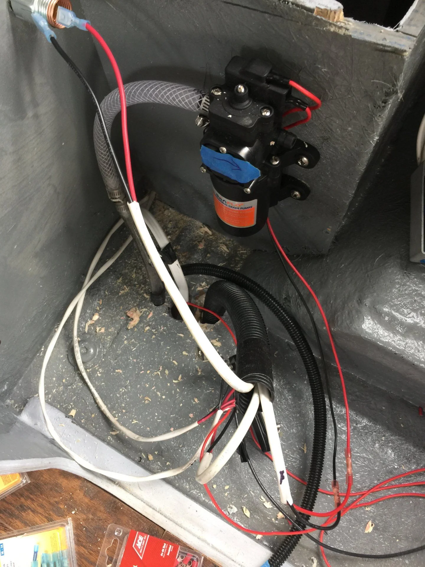

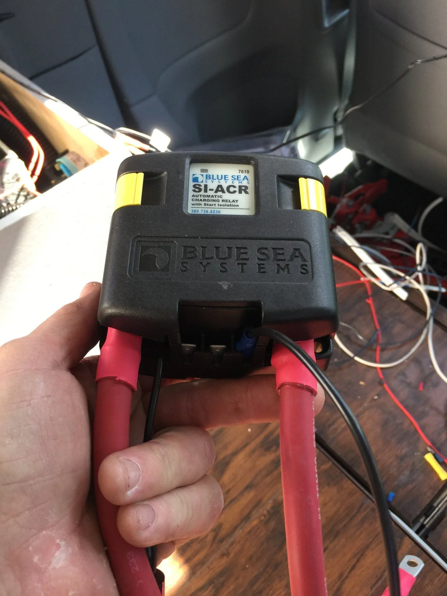

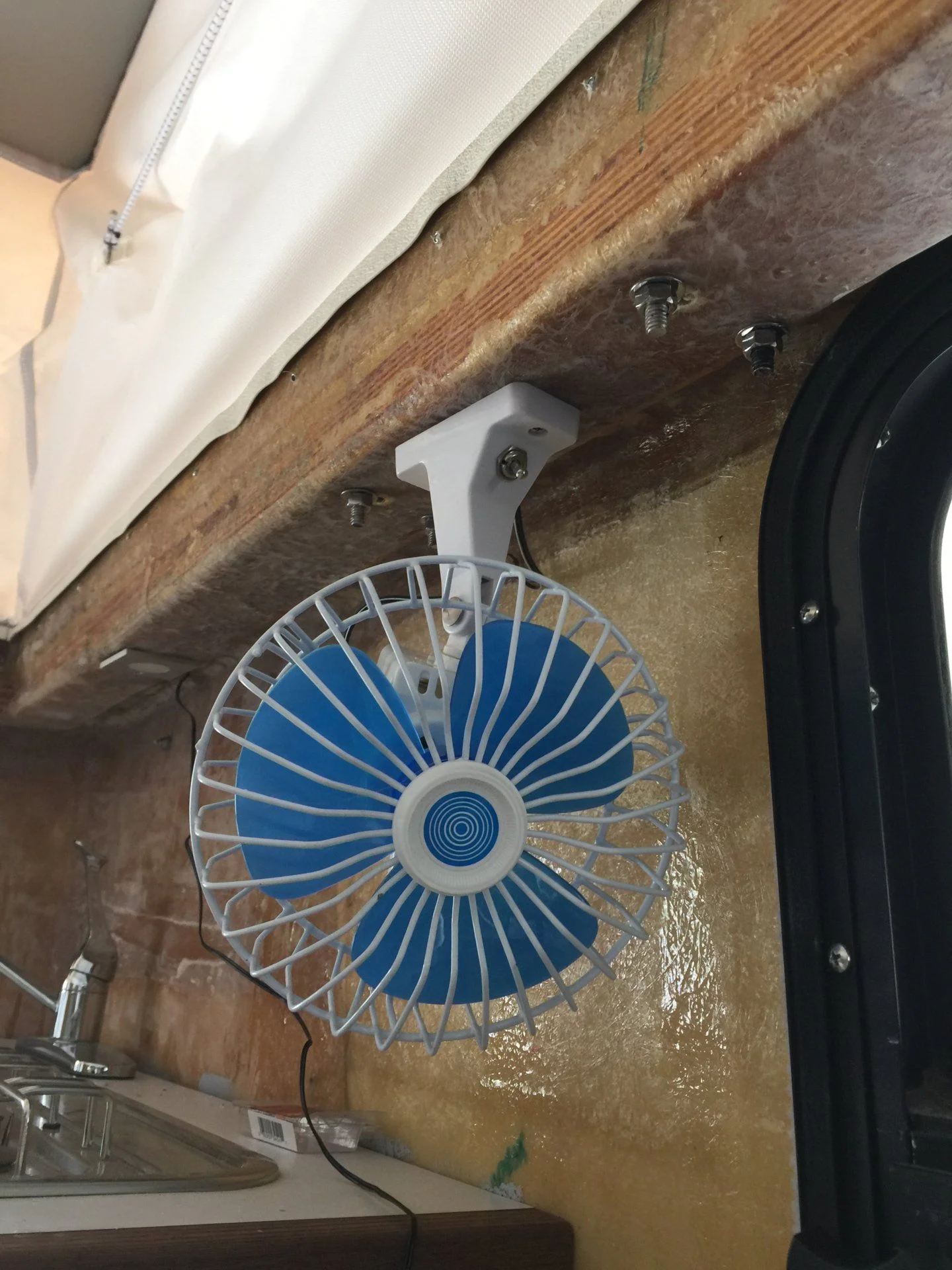

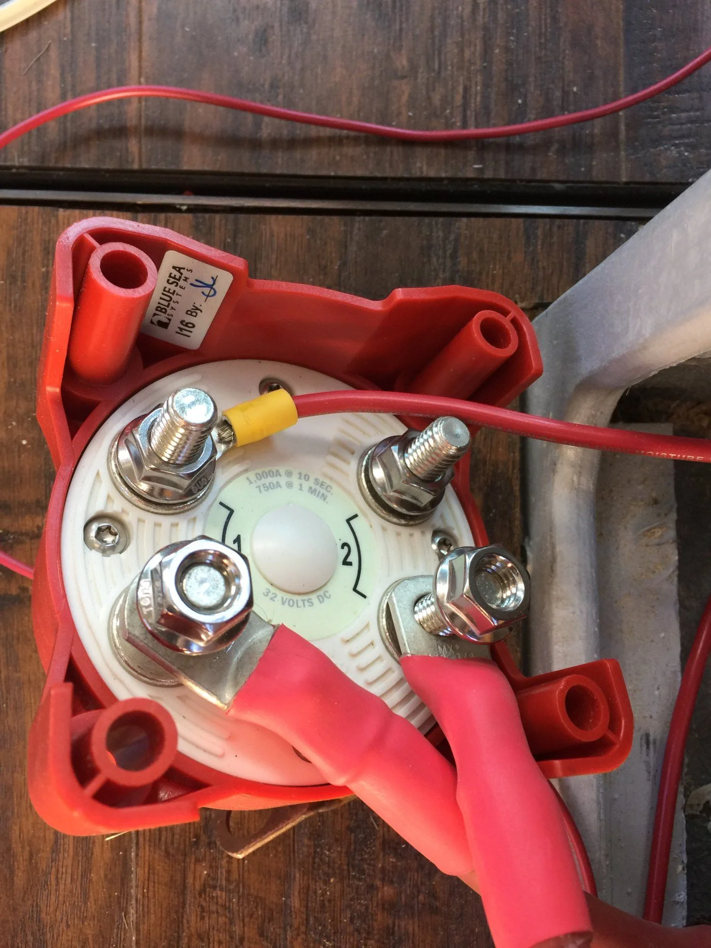

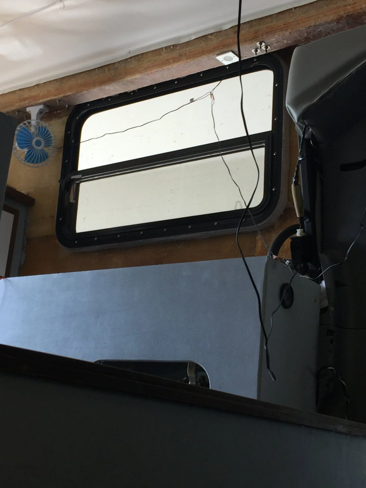

Made a bunch of progress on the interior wiring. Temp mounted the little LED puck lights with dimmer. Also a 12V oscillating fan. They are wired. All of them then come down for the final grey felt upholstery then reinstalled... mounted the battery switch for the 2 battery system. The 2 batteries get connected with #1-0 cable through the switch with an isolator that connects to the starter circuit... also mounted a switch for the second fuel tank gauge. Some bus bars for future 12V needs and wiring for the little demand water pump. Also a cigarette lighter for another charging option and circuits for the fridge in 12 and 120 volt...All the circuits are run through the fused switch panel.... I have another switch that will separate the 2 12V sources... the house battery or the 12V step down transformer if I am plugged into shore power or the generator is running. The 2 position 25 amp switch will not allow the circuits to be fed by both sources at the same time. I have a retired boat electrician working with me a few hours at a time which is awesome!

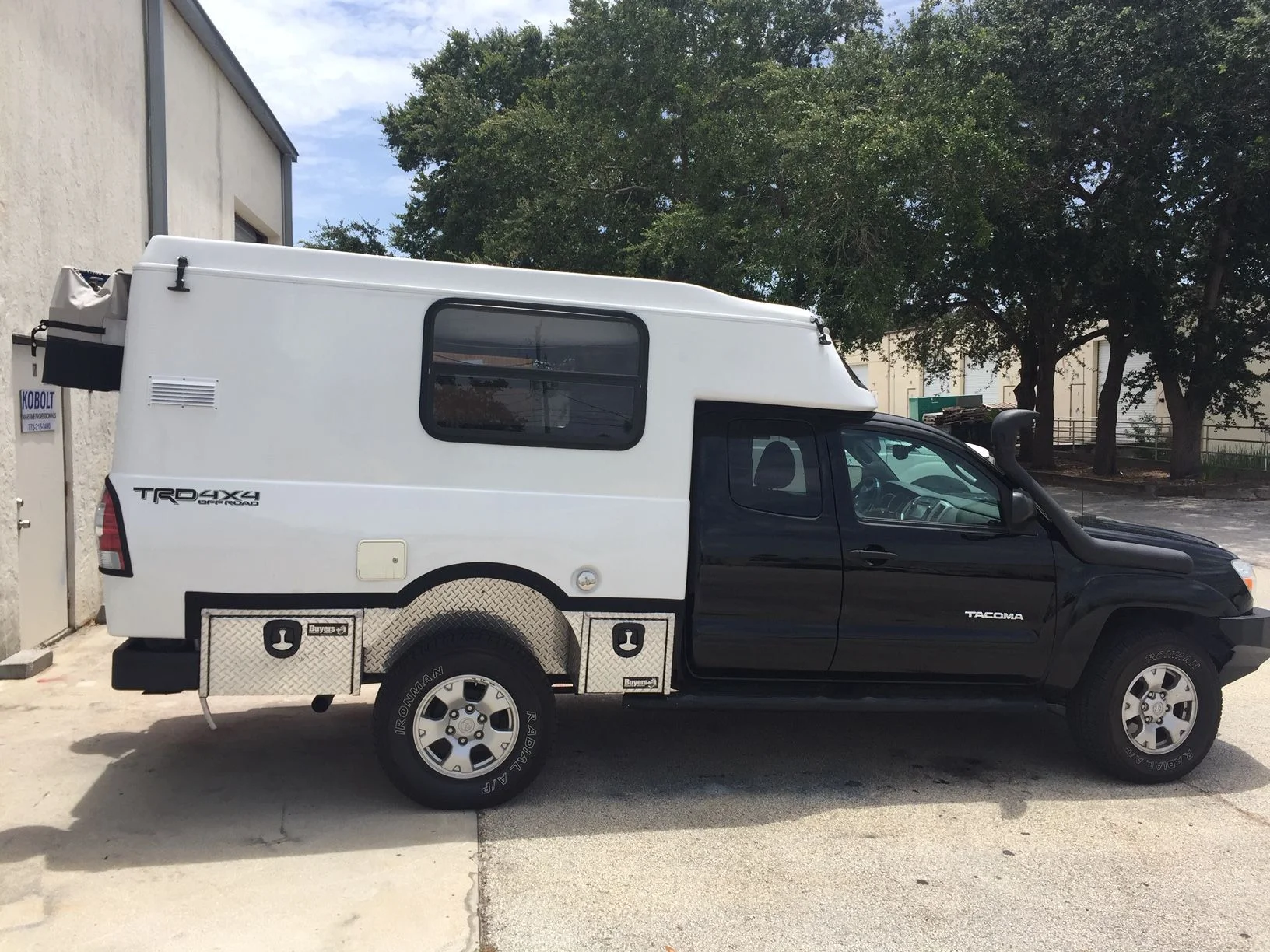

Are you still doing the tire rack up top on it? Not sure if you mentioned already, but do you have plans of painting the camper or both to match?
Love it.
Hey Cody. I am not painting the truck. I have embraced my black and white motif! I am still mounting the rack. It is fabricated but I have to put the final wrinkle paint finish on it first...thanks!
The wiring is all connected and tested. A big milestone! I still have to do some split loom and organize with a couple million zip ties... 2 battery system is wired through the isolator. 2nd battery is in the rear step bumper. After I organize my electric I can button up the wall covering. I see the light at the end of the tunnel!

Only upgrades to date are leaf springs and airbags... this rig was built to be able to drive into a standard 20’ shipping container. I have some international travel plans ...by being able to use standard container shipping this truck can be sent to any port extremely cheaply... example Miami to Sydney about $1900...
