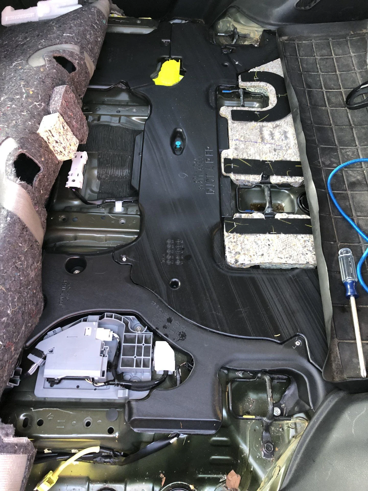

Where does the fuel pump hide in here? All kinds of plastic ducting obstructs a clear view of where I expected to find the access port.

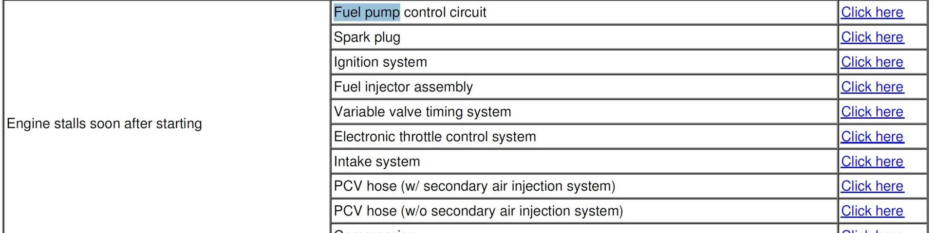

FSM lists these as possible causes. Last one is compression thats cut off. That doesnt seem like it would be i9t
there are other possibilities based on if it decelerates slowly or rapidly before stalling
Thanks!
When it stalls, it decelerates slowly, and sometimes even catches itself - restarting on its own. The times that it does this, it runs cyclically running normally for a time (minute and a quarter or so - but sometimes longer) then starts to fade out, and either stalls completely, or the vehicle seems to catch it, and jumps in rpm (as if someone stepped on the accelerator). All this seems to be controlled by the ECU without any driver inputs or intervention.
Check under the darker black plastic section to the left of the bright yellow part near the top of the image.
It has to be on that side of the truck, likely somewhat near the center of the fuel tank.
