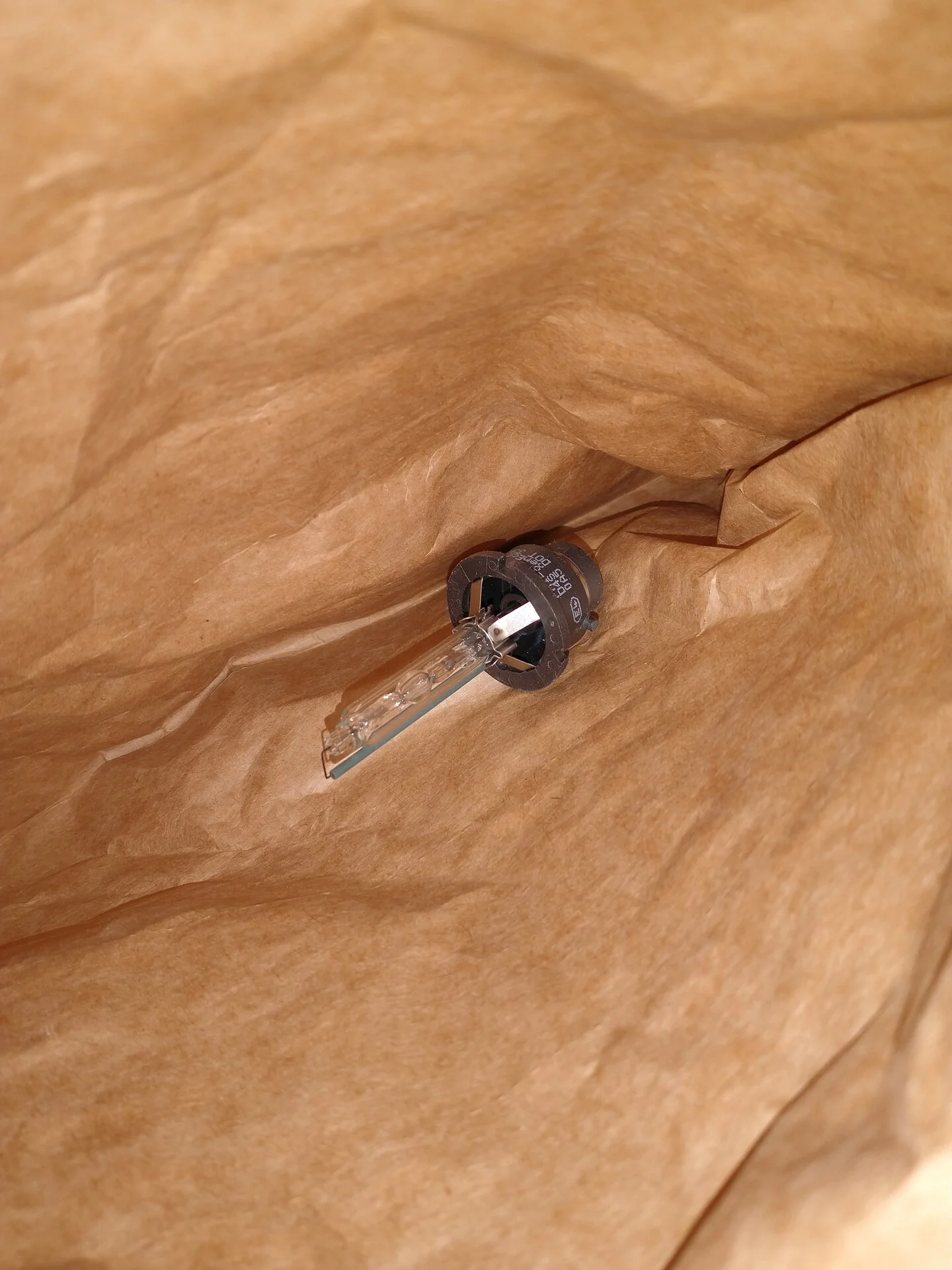

I just replaced my bulbs in early September (2010 originals). Once replaced, the flickering went away, so I think my ballasts are fine. They are the same color as stock but were noticeably brighter as new bulbs should be. I used the Philips D4S available here: More Information for PHILIPS D4S - https://www.rockauto.com/en/moreinfo.php?pk=6319494&cc=1445667&pt=11701&jsn=47
I previously ordered a set from the Jungle Punks and was less than satisfied with how they arrived. RMA'd the same day. See below images.
