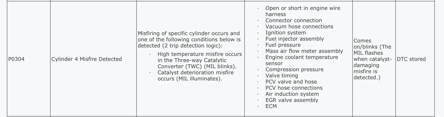

1) So I am having an issue with my 2010 GX460 where the 4LO indicator is blinking, and the check engine light and slip are also on. I have never shifted out of 4HI, so I know for certain it's not in 4LO and hasn't been in many years.
2) When I check my engine codes I got a P0304 - Cylinder 4 Misfire Detected.
3) Idles fine, but when I shift to R or D, it becomes rough.
4) However, if I reset the code, it idles fine and the roughness completely goes away and I can drive it like nothing ever happened. (Until I let it sit, turn it back on and all the lights come back on).
That to me feels like ECM possibly? Maybe bad electrolytic caps?

I just figured that since clearing the code causes the car to behave normally that perhaps it's related to the ECM, but I guess I should start from the traditional end of investigating the cylinder. Why does 4LO blink when I have a cylinder issue? Those things seem unrelated to me, other than erratic ECM, but I 100% admit I don't know what I am talking about either. :)
from my limited experience if its a CEL theres always bound to be a few extra lights unless its like evap leak. But i could be wrong, my thought process would just be if the code is saying its a cylinder than it should be that. If that means its something else than thats just nonsense to me
i dont get why that list of possible issues doesnt list a bad plug or coil for a misfire lol, i must be on a completely different wavelength

One of two options:
1) Work down the list yourself, depending upon your time, expertise and equipment you have. It may cost you more if you're needing to purchase replacement parts as you move down the list till you hit upon it.
2) If you can afford it, have your local mechanic chase it down. He may be able to chase it down without having to purchase any parts except what is needed for the actual problem. In the end this may be cheaper and probably faster.
I would guess "ignition system" includes those items?
That is how I would interpret it.

Okay, I will see how bad it is to get to the #4 coil and any other coil I can switch to see if the problem follows. And I will give up on the idea of the ECM. If it's difficult to get to #4 and any other coil then I will give up and take it to a mechanic. But I do like to learn and dive in when I am able to, so thanks for the FSM!

Misfire codes can be caused by many things, even stuff like vacuum leaks in the intake.
Honestly, the FIRST thing I would check is your alternator. Low voltage can cause many weird codes.
