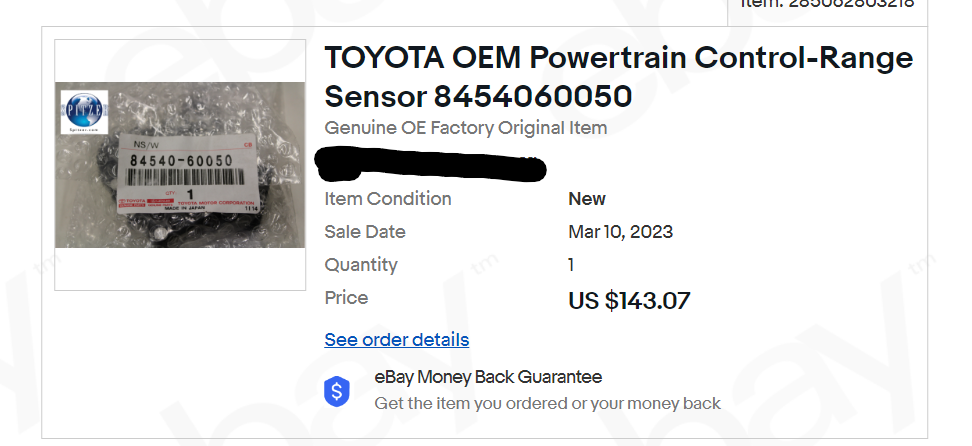

Its the powertrain range control senor or I've seen it called neutral start switch assembly, there is a plastic part on the outside that cracks and fails over time. Mine went out a few months ago. Sits on the passenger side of the outside of the transmission, I didn't want to bother with it so I had a local shop install it.
Amazon product ASIN B00KTJDKMM8454060050

Just a heads up, when I go to the link of that part in Amazon, it shows that it DOES NOT fit my vehicle.
Double check compatibility before you purchase.
