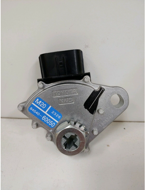

Its the powertrain range control senor or I've seen it called neutral start switch assembly, there is a plastic part on the outside that cracks and fails over time. Mine went out a few months ago. Sits on the passenger side of the outside of the transmission, I didn't want to bother with it so I had a local shop install it.

Can you confirm that your issue was exactly the same, in that it was throwing a p0304 as well?
