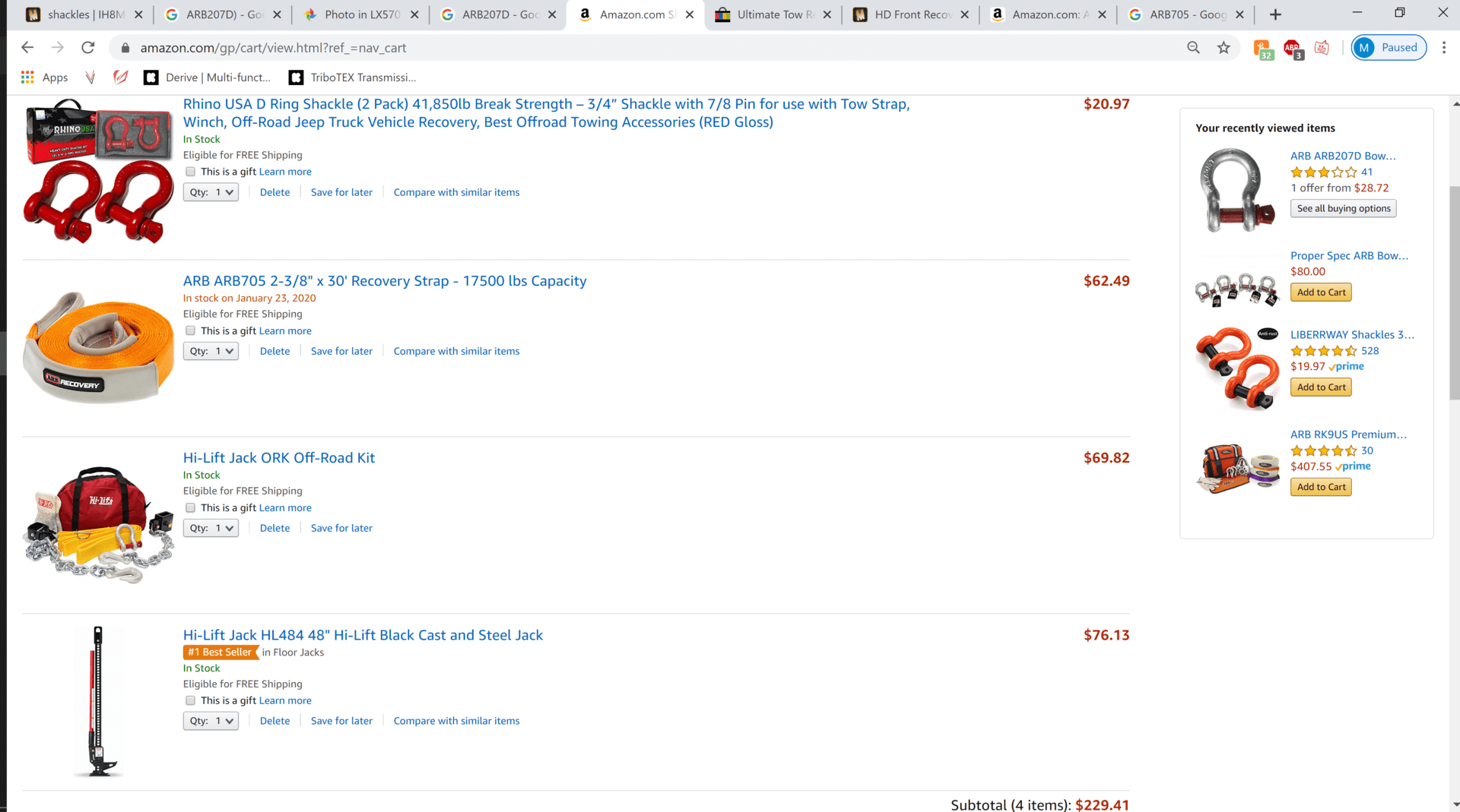

Also, i have been looking at recovery gear in case i get stuck when i go back to the above trail, will this be everything i need to hi-lift-winch myself out if there are plenty of trees around?
That ARB strap is used for vehicle-to-vehicle recovery. While great to have (I have the same one), it won't help with winching.
First thing you need is an ARB Tree Saver strap. It'll be green. This is wrapped around whatever object you're pulling off of - tree, rock, etc. Its first purpose is to protect the tree from damage, and second purpose is to provide you with a nice way to attach your shackle (goes through the two ends of the Tree Saver strap).
Second thing you need is length in your winch setup. The Hi-lift kits won't provide much length. You can look into various tow/winch straps. ARB has a "winch extension" (purple) strap that's 60ft long - not a bad place to start.
Outside of all this, I'd actually advise to pass on the hi-lift setup altogether. On a somewhat stock vehicle, the hi-lift is not all that useful as there are no good points for you to attach the jack. You could use the hitch receiver, or hi-lift's kit to lift by a wheel, but neither option is ideal. Hi-lift is most useful when you have sliders and steel bumpers. Further, hi-lift can be dangerous (people have lost eyes), so make sure to do your research and learn how to use it safely. Hi-lift is also heavy and bulky - it's tough to store nicely, such that it's out of the way. Winching with it, while possible, will also be a huge pain. If you'll be using it as a jack, you'll also want to buy hi-lift's red base to provide much needed stability. And while you're at it, grab the handle keeper (minimizes vibrations) and neoprene case (keeps the mechanism clean~er).
You can get a hitch-mounted winch base for $100-$150, and find decent winches for under $500. (I had - and liked - the Smittybilt 10k w/ synthetic line and remote for around $500 USD some years ago.) Add some wiring/connectors, and you'll have a much, much more useful setup than the hi-lift for not much more $$.

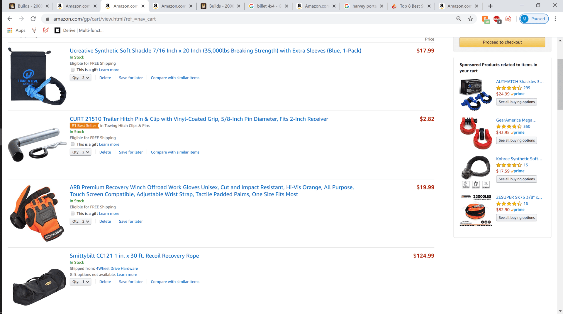

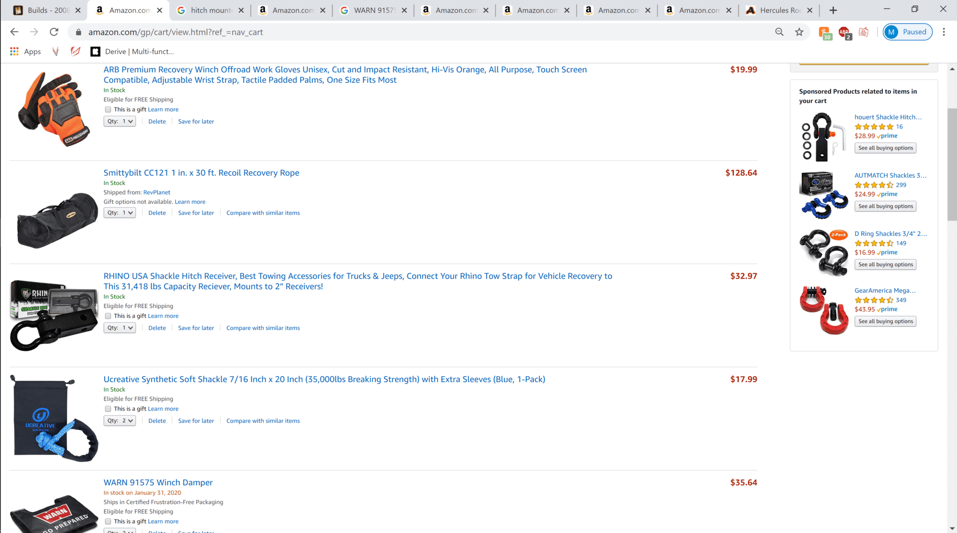

I plan on ordering things tonight in hopes it will be here for this weekend when i try that trail again. I attached a screenshot showing what i have as of right now. The plan is to go with a friend this weekend (he has a lifted dodge ram 3500 and no recovery gear), so my goal is to pick up only what i need when going with the assumption that there will be another vehicle there.
I left out the tree strap for now, and will pick up one when i get a hitch-winch-mount and a winch. Let me know if it looks good and i will put in the order tonight so that it gets here by Friday. Thanks again everyone.

Thanks for taking the time to write that; it is very insightful. I did not know that a hitch-mounted winch was an option, and will look into that. I also was thinking that maxtraxs would be my most used tool and that it would almost always come out first, but i have no personal experience with it. I did abandon the hi-lift-winch idea as well (per other members recommendations), so always nice to have confirmation on that.
Recoil recovery rope and snatch straps generally serve the same purpose, so you don't need both. I don't have any experience with the Smitty rope you've found.
The shackles you've selected look fine. Make sure to get a few shackle pins. One will be useful for that hitch shackle (doesn't look like it comes with a pin?), and backups will be useful down the line. In a pinch, you can slide the end of a recovery rope/snatch strap right into a 2" receiver, and put a pin through the receiver and the rope; I've recovered numerous vehicles this way (they had no other viable recovery points), but it frequently results in bending/destroying the pin, so it's good to have spares.
The winch damper is not necessary until you have an actual winch. Generally not used w/ snatch straps.

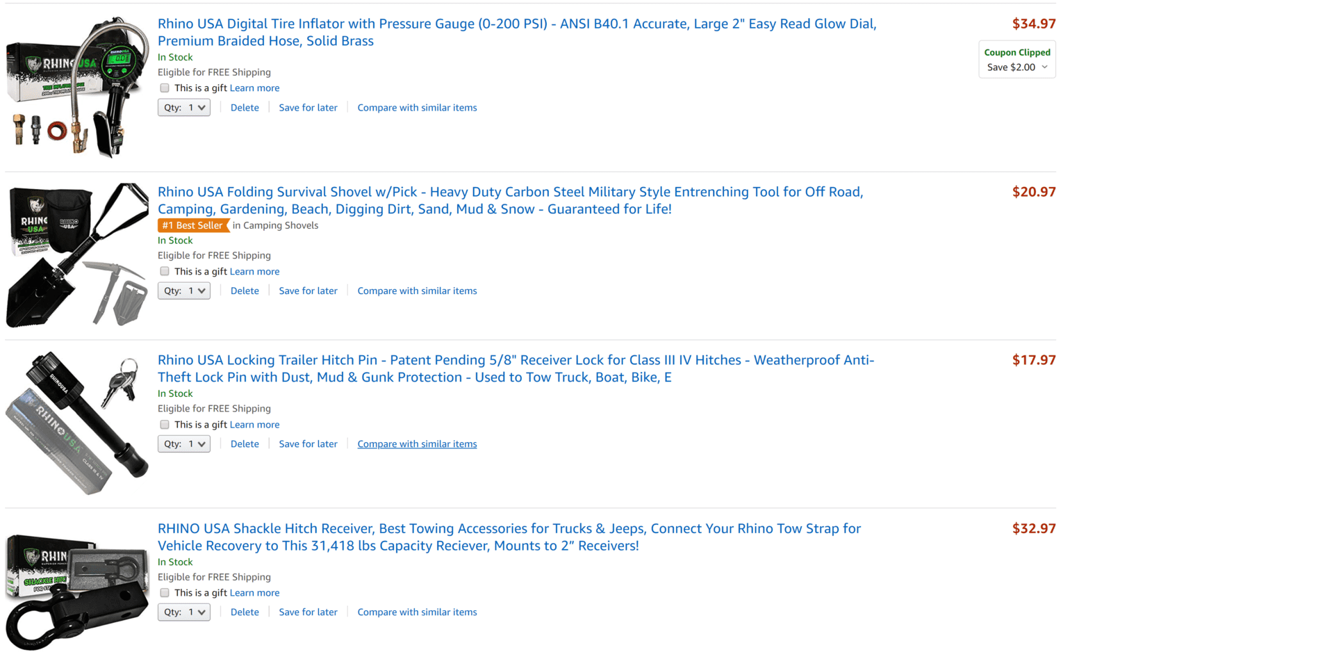

Rhino has a buy 4, get 15% off coupon on amazon, so i went ahead and added a digital tire inflator, as well as go with them for the shovel and locking hitch pin.
