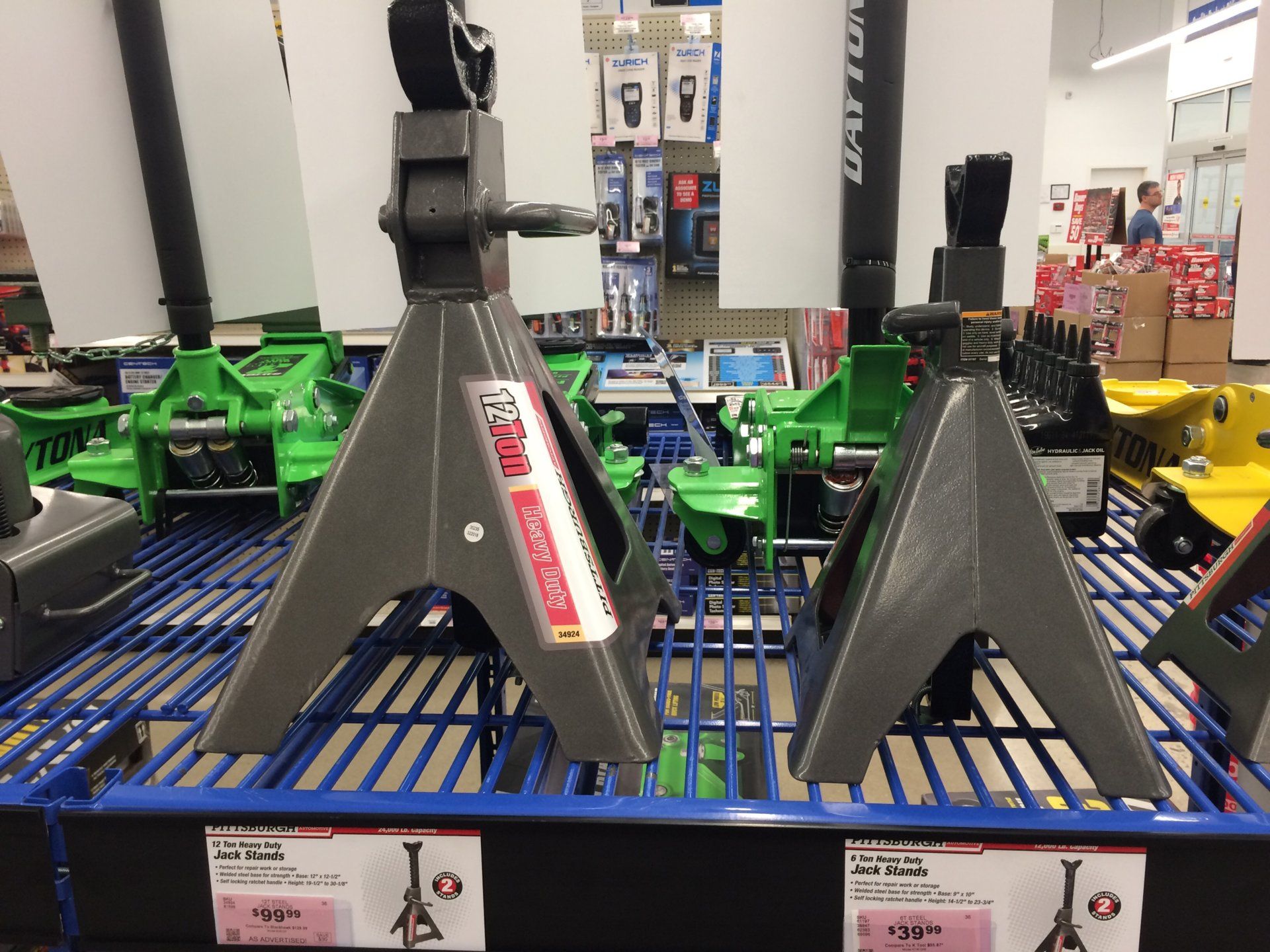

I have 6 ton axle stands and they barely reach the frame.

This one looks solid, 23.4 max height and 3 ton enough to do tires? Also the 6 ton jack stands do look small.

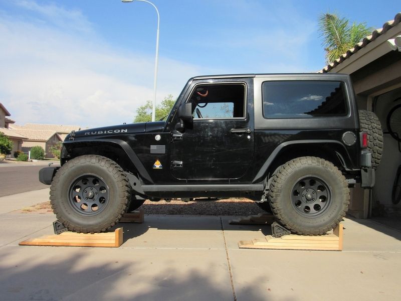

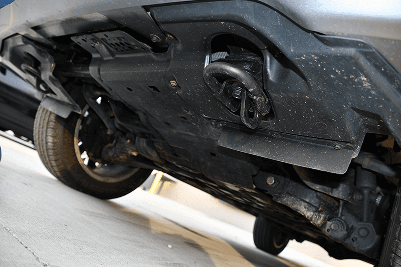

My dad wasn’t a big fan of the wood ramp idea so I will hold it off for now and consider renting a bay for when I prep, clean and spray the undercarriage. I honestly thought it was a good idea to recycle the wood and save myself money in the process. I was thinking something similar to the pictures below but a little Wider and higher in height. Oh well back to drawing board as to how I will get the clearance I want for coating the undercarriage.
