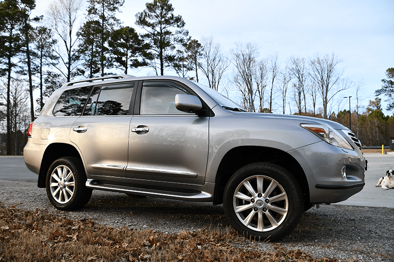

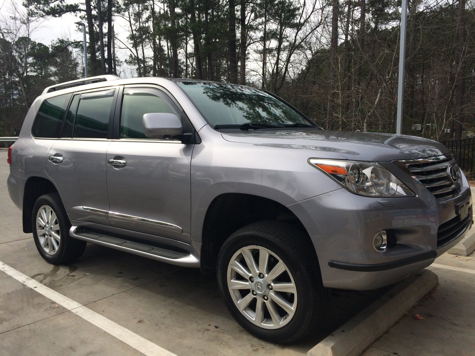

First picture in low, 2nd in high. More stock pictures on page 2. I will also make a google photo album and link it here after it is done uploading if you want to see more pictures and at higher resolutions, as well as be able to see everything in one place.
