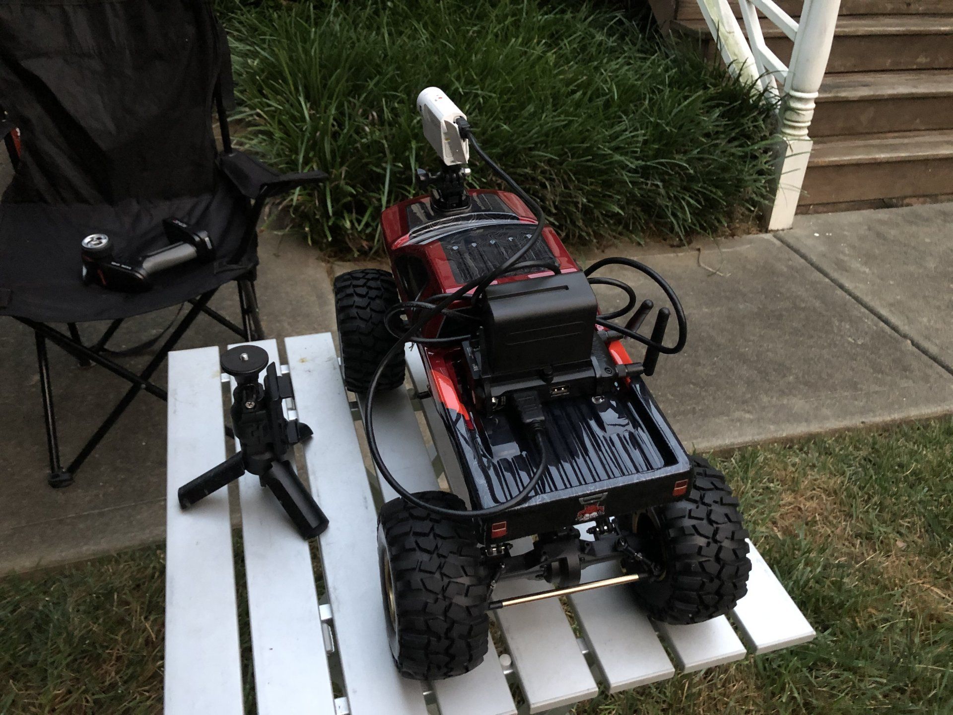

Meanwhile, I’m going to go live in 15 mins to unbox the Remote Control Truck that will be the platform for the Remote Control Camera Car. Yes, the live feed RC truck is coming!
I am traveling solo in most cases, so this baby will be my spotter while I stay in the car and trying to cross obstacles. This will also be one of my best tools to check out and show off everyone’s rig, on and off the trail, while I’m at LCDC. It’s going to capture some amazing shots from under as the LCs cross over obstacles.

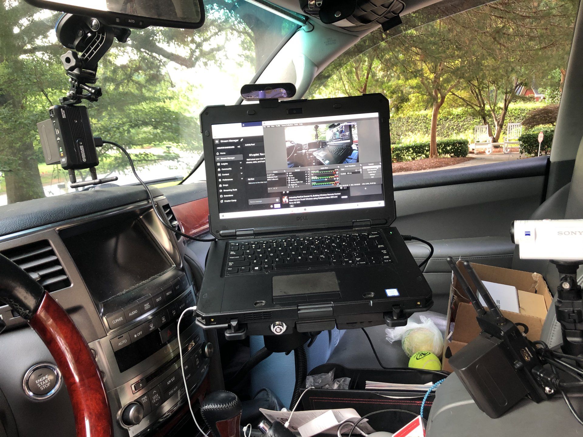

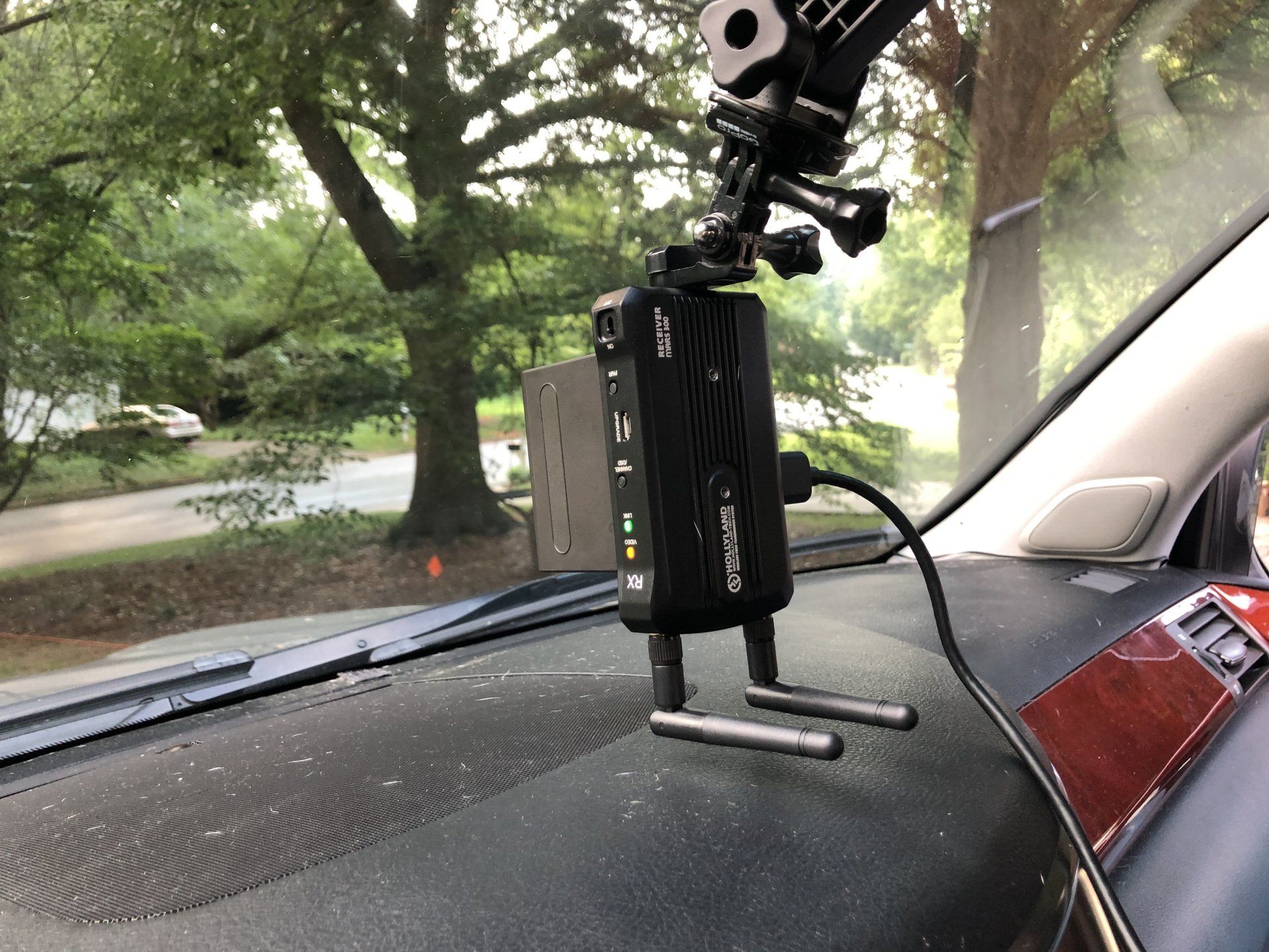

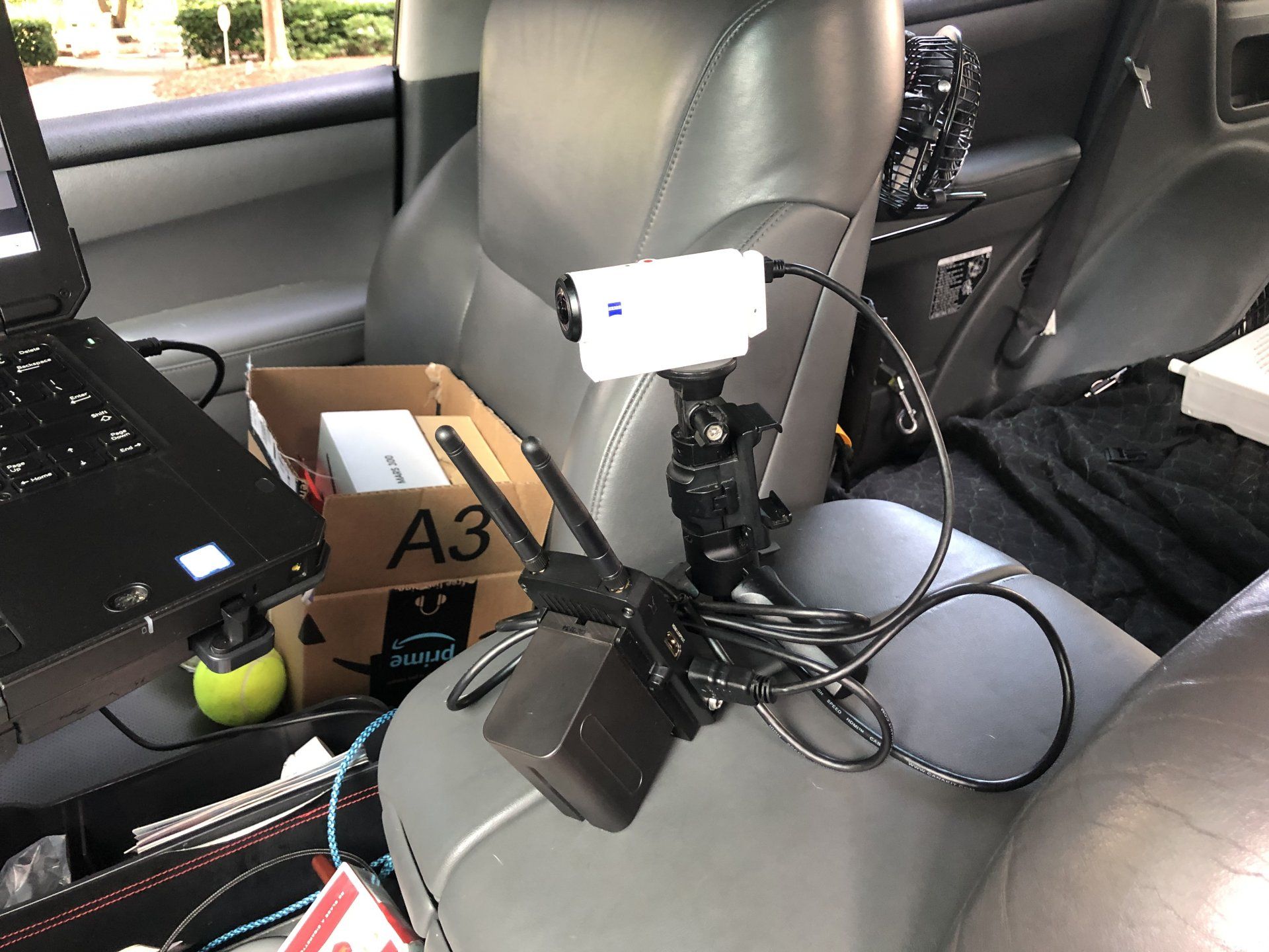

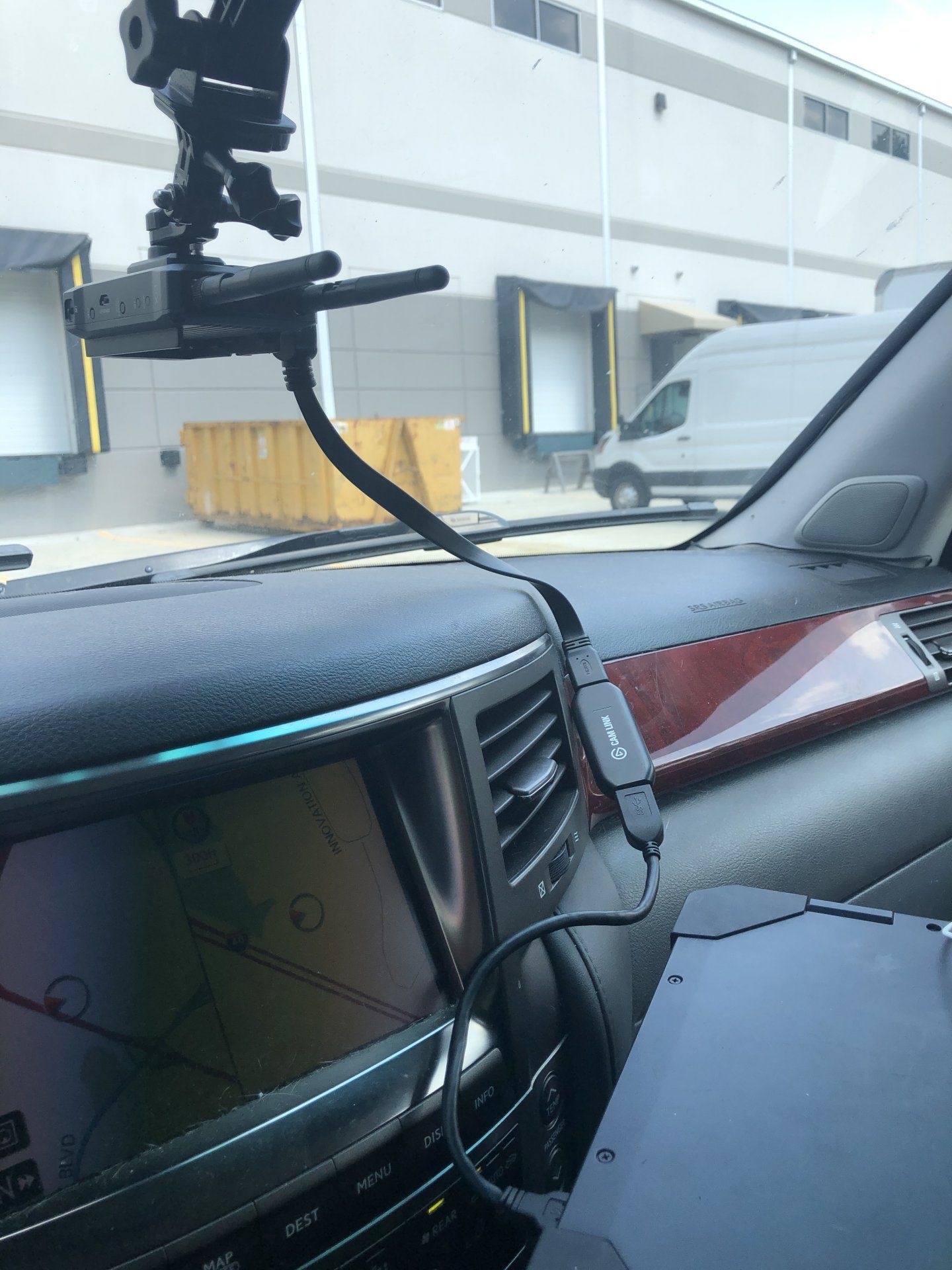

I decided to go with the Hollyland series for my wireless setup, here is a glimpse. A shorter, coiled hdmi cable, and a smaller battery, a different hand grip/tripod, and we have ourselves a nice and compact wireless setup that can easily be handled with 1 hand (the Hollyland will mount on top of the camera if you get the right hand grip).

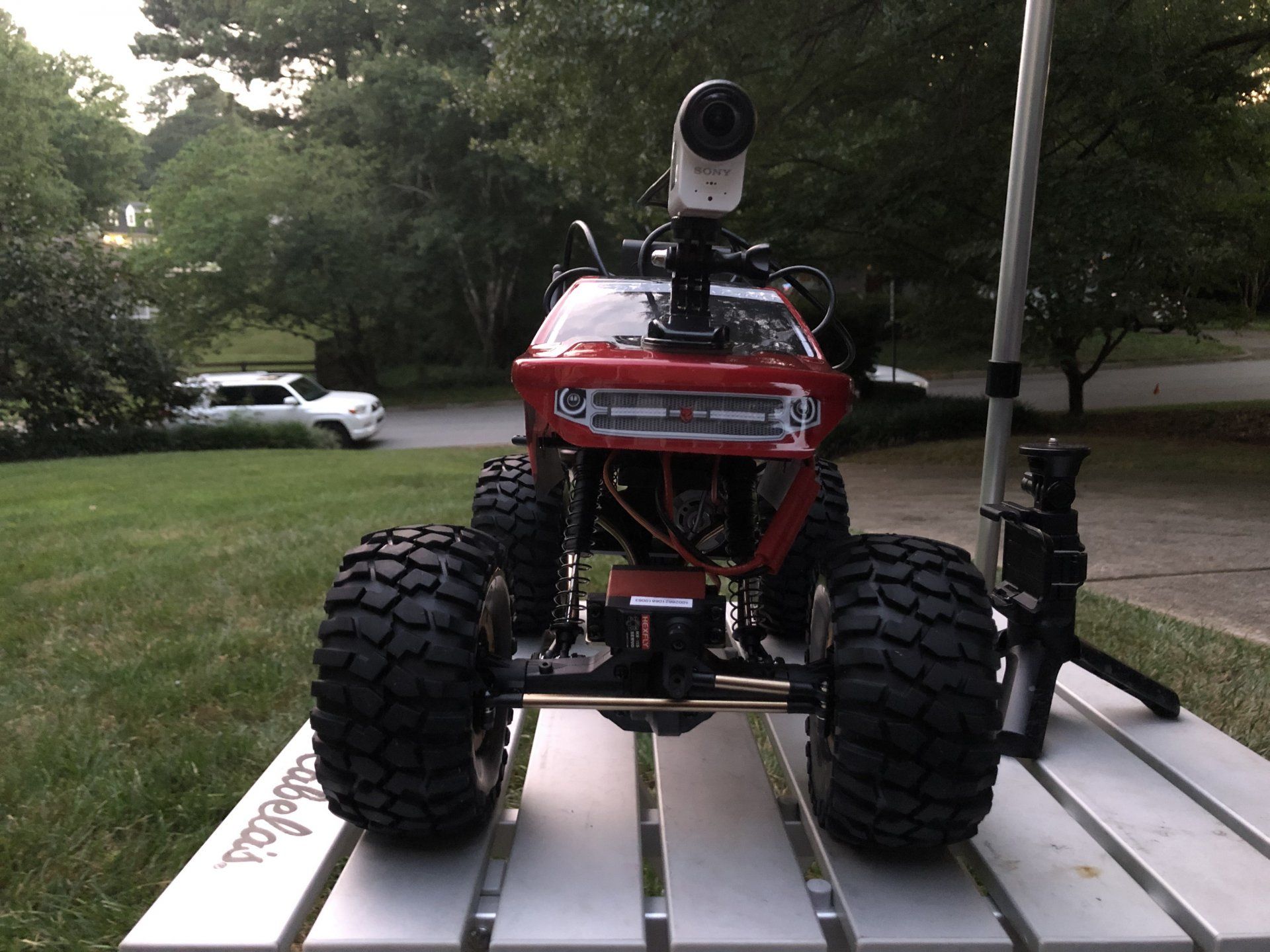

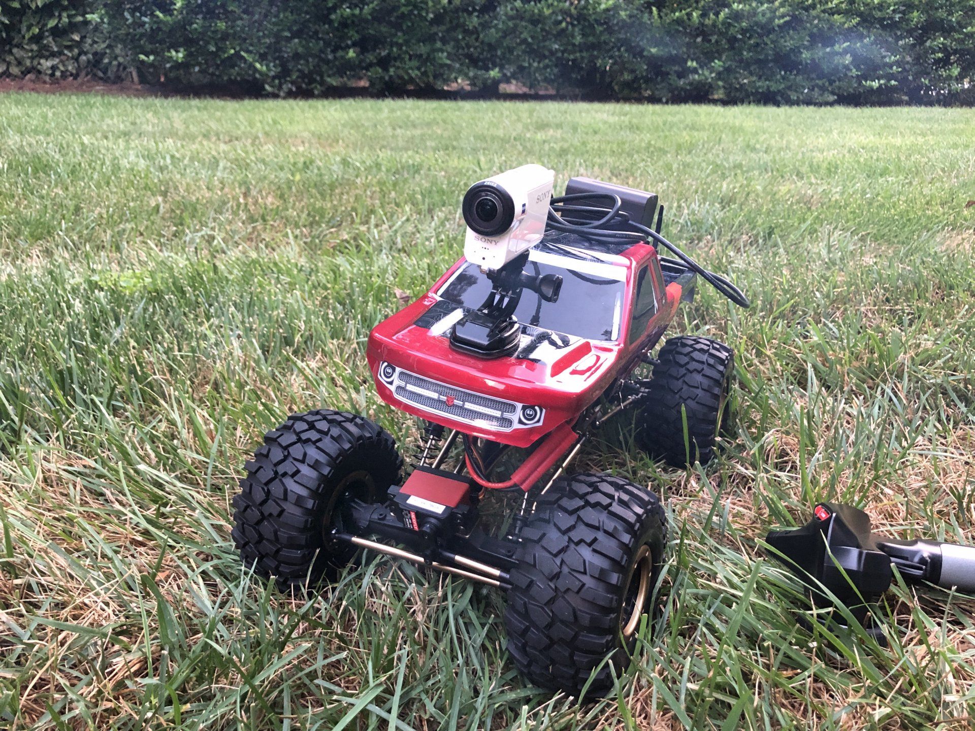

The RC Camera truck is... AWESOME!!! Worked exactly as I expected. It’s like FPV but with my laptop instead of goggles, and with any camera I want! And also with the option of sending the live feed to any platform at the same time.
I just need to get a hardbody now and we are good to go. And a shorter hdmi cable. The plastic body is too weak and it leans.

Going to work on ways to trim it a little because it sits so high that it’s a tight squeeze To get under the car, given that I am on stock tires.
Probably go with a GoPro as well when I get one with hdmi (need the black), so it sits lower as well as better image stabilization. This thing is very capable crawler though. I can climb stairs with it.

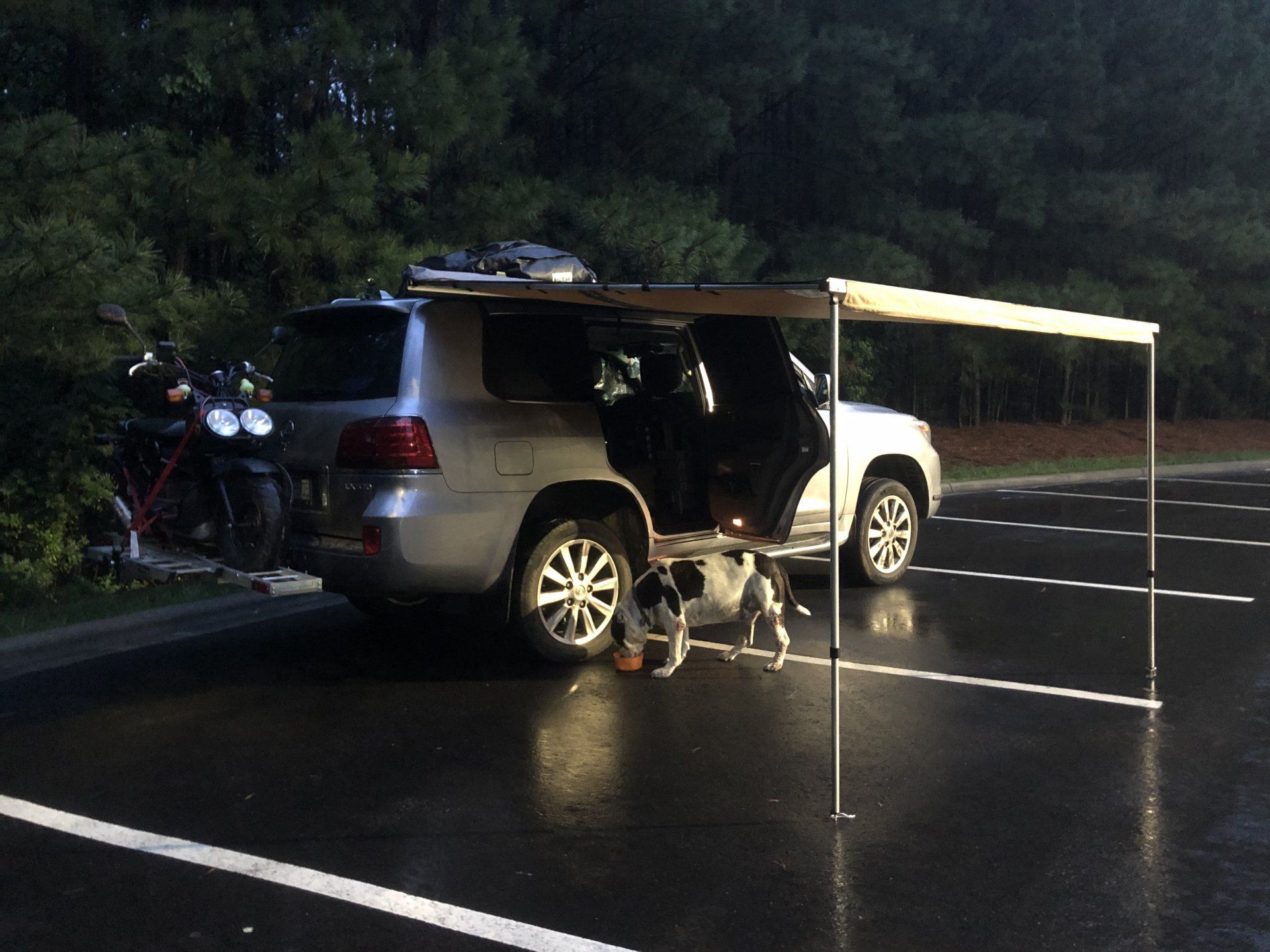

Remember to be safe with your awning folks, and angle it down in the rain and make sure water is running off and not build up in middle. Luckily no one got hurt in my case. In case you missed it, Tiger was in the car and I was trying to lower 1 pole from one of the corners, and it collapsed. There was so much water that it was only about 2 ft from sagging all the way to the ground. Here is a picture of the night before, and how it was angled to lead to that.
Luckily the ARB awning is very sturdy and held until I unlocked one of the poles. The difference in price wasn’t much from Chinese awnings (with the discount from 4WP), and this is one of those cases where I am glad I went for a quality product.

Yeah I do have a lot of electronics, and there are more coming. If the cheap bonding service from speedify (10 per month vs hundreds per month from other companies), can handle cellular data from phone tethering/hotspots, then expect to add 3 phones/hotspot devices to the mix. Then you add the drones, microphones, tiny Second monitor (so I can monitor chat and the stream in real time), sound insulation, and lighting gear just to name a few. This is by far the biggest mod I am doing for the car. It’s a lot of stuff that goes into one of those “news vans”, and this is keeping it compact when relatively speaking.

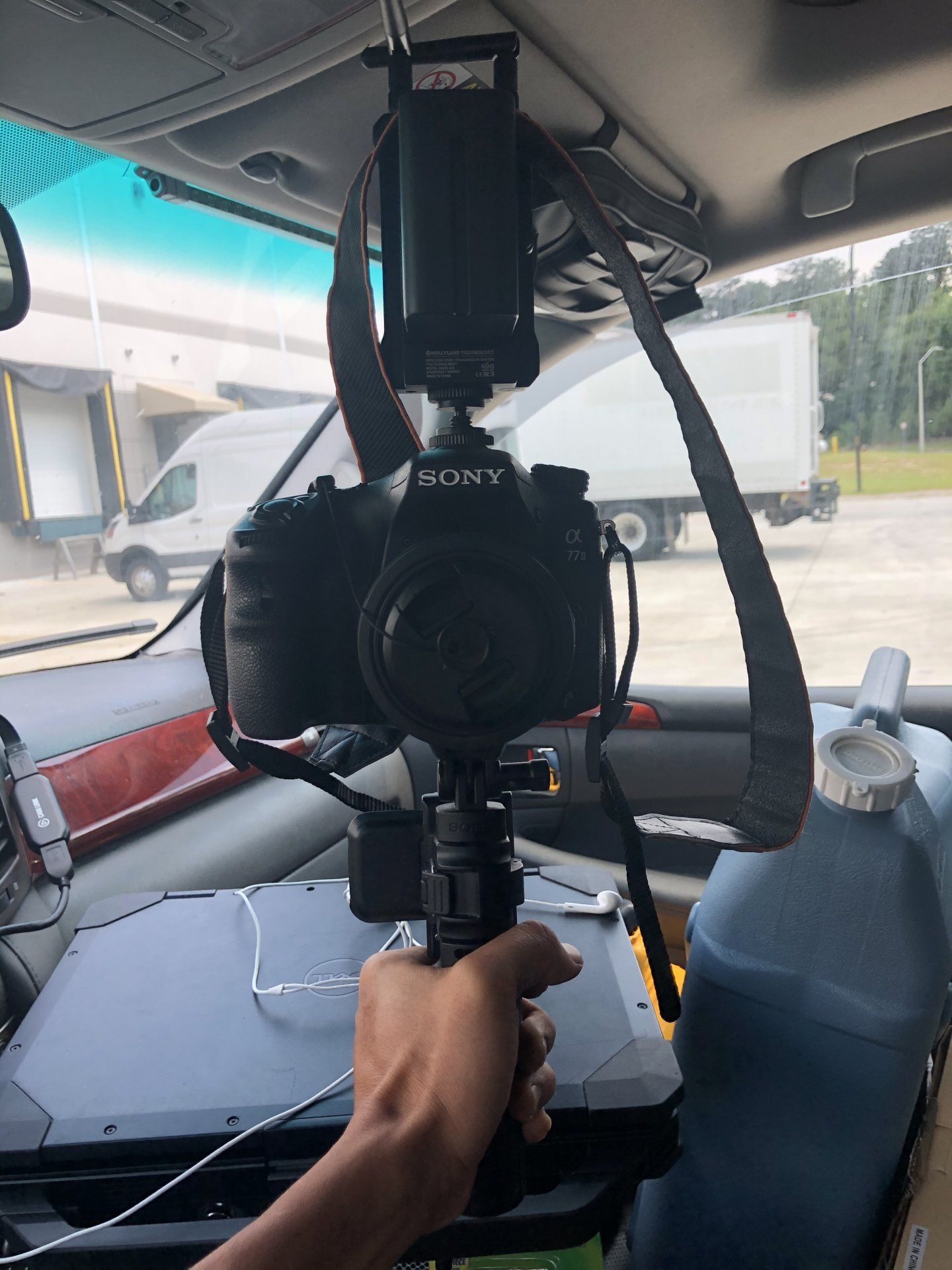

Adding a DSLR into the mix. This is what I meant when I said the Hollyland is designed for this. It had multiple ways to mount to Universal camera mounts. A little on the heavy side right now but tomorrow the Transmitter battery is being replaced with one 1/3 of that size. Also will get a bigger hand grip with a gimbal built in. That hand grip is made for a small action cam. When I am close to the car I will be going for the DSLR, and when I need a quick and mobile setup I will be going for the action cam. Some occasions I will have both on me.
This allows me to add different lenses to the mix. I’m going to start searching for an ultra wide angle lens, as well as one with a 16:9 ratio because we are broadcasting in 1920:1080p.
Oh hello there, I just Found my LED light strip power cable! Had to look it up, turns out it was in the bag that I assumed was guy ropes and little stakes. Perfect timing as I was looking for a good place to work on modding the RC truck. I am trying a few things to help prevent it from flipping, leaning, and sitting too high for undercarriage shots.
Mods for today:
- battery relocation towards front and lower
- Adjust shocks to lower center of gravity
- Mount a 1/4” 20 UNC bolt for the camera and transmitter, if that fails try Velcro and adhesive.
Going to continue modifying the RC truck today and then give it a test run once the things are mounted in new locations.

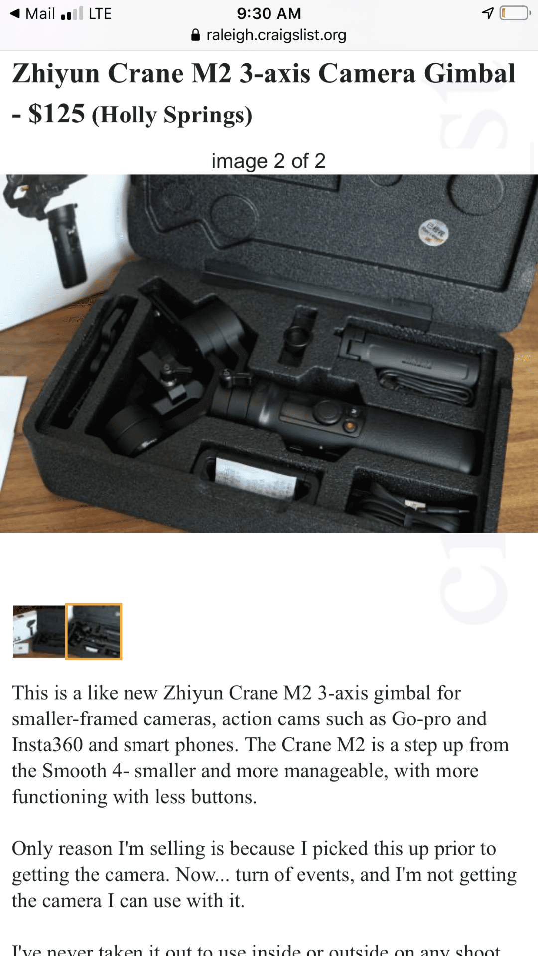

Also going to try and pick up this gimbal from Craigslist, dude wants 100 which is really fair. I got the DSLR working, But only lens I have is a macro lens; so it was very shaky and the angle was too narrow. A gimbal and a 16:9 aspect ratio lens should do the trick, or even wider for a nice cinematic view. Time to start looking for a wide angle lens. I’m gonna go check out the gimbal today and hope it isn’t too small.

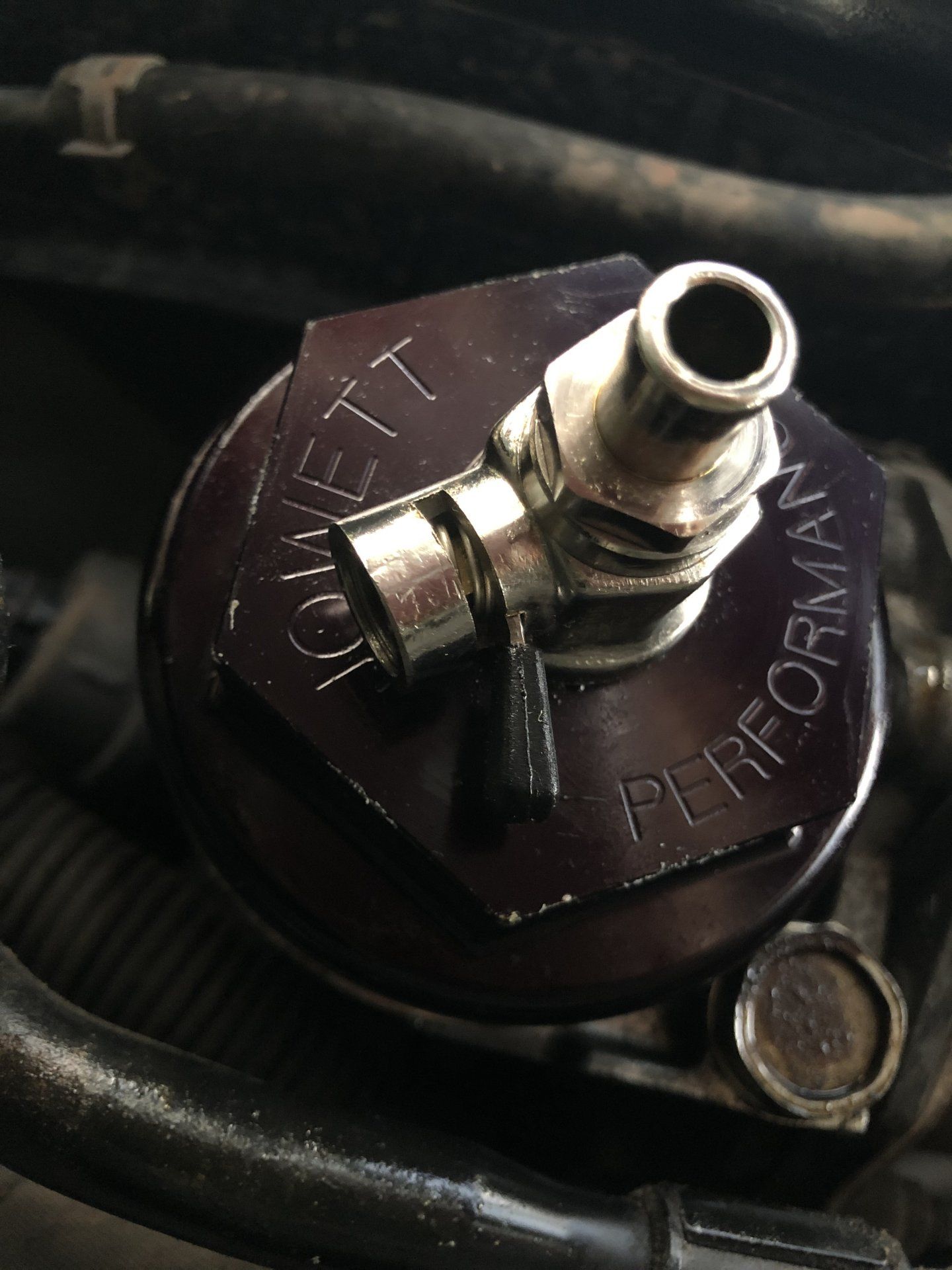

There are a lot of these out there, but this one is mine. Had to stop and admire it for a second before I put the armor plate back on. @bjowett thanks bud!
