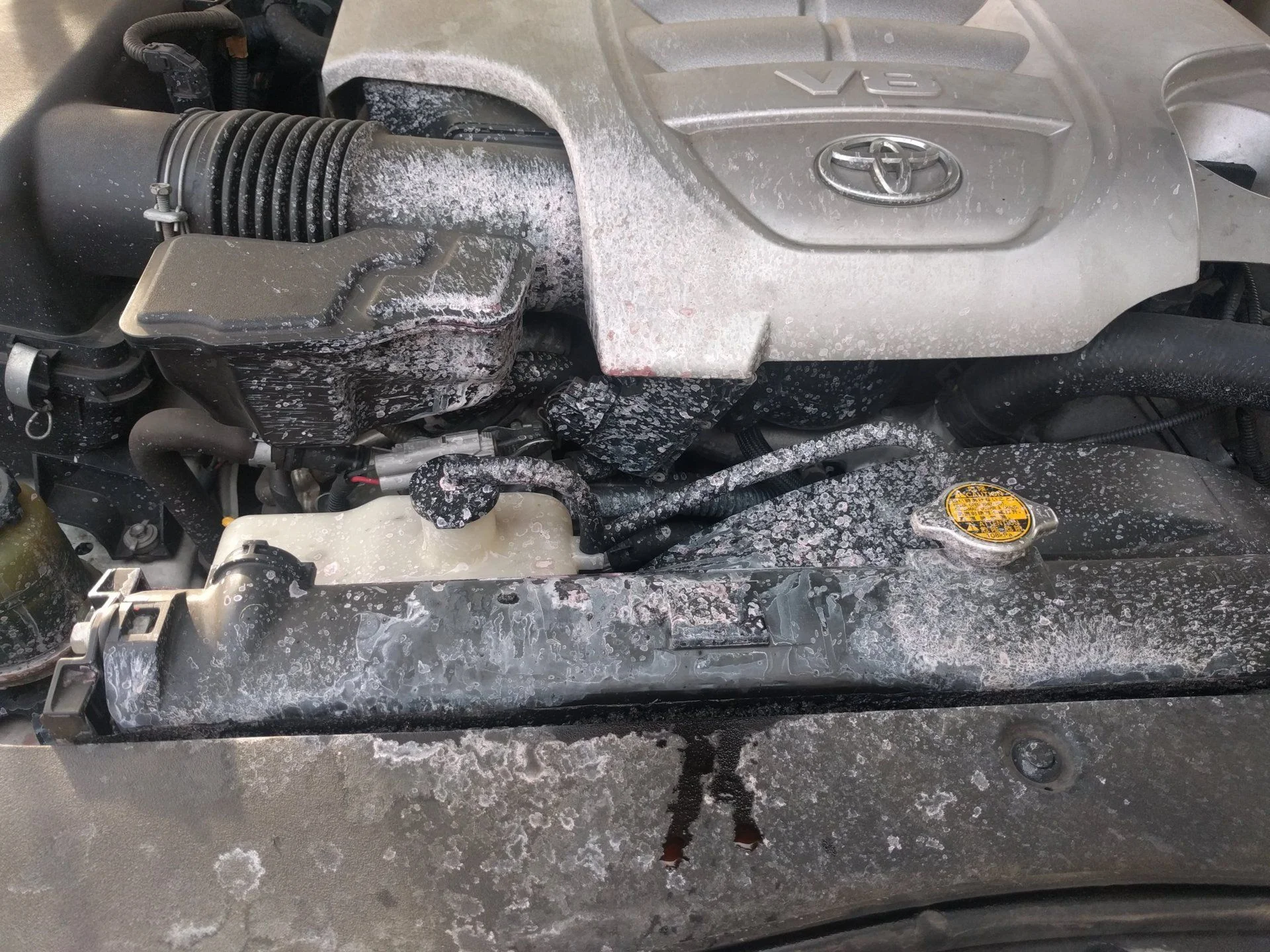

Joining the club with 09 and ~140k miles. Had an oil change done 3 days ago - all looked normal. Today was 1st warm day after winter here in Texas, temp got up to 80F outside, wonder if that's related. Attaching a pic

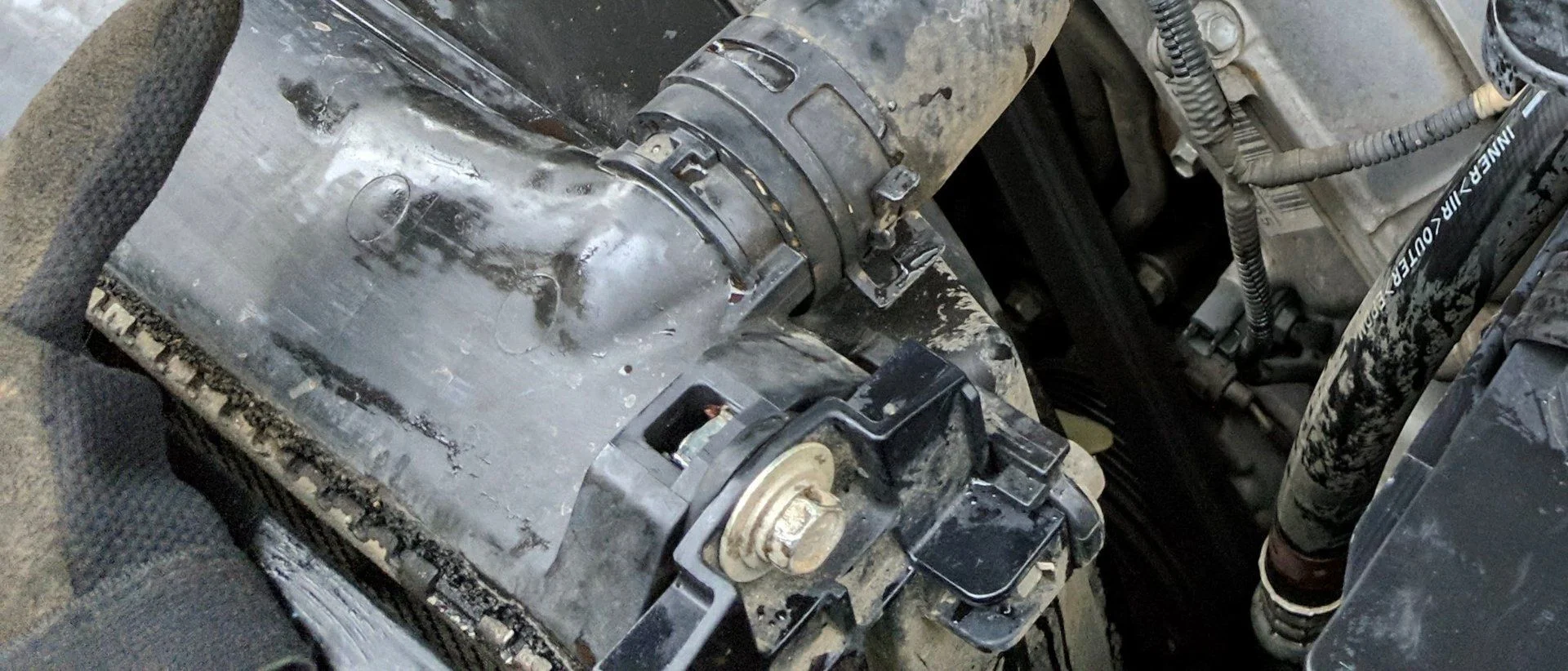

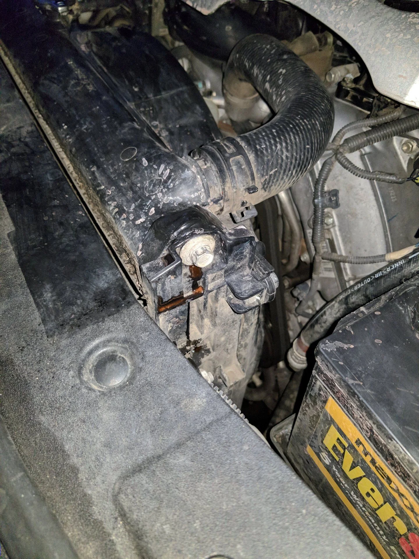

I have 161k on mine and have sprung a leak... although in a different location from most. Mine is leaking from a tiny crack on the driver's side edge where a bolt secures the top plastic to the side plastic. Could be that the bolt had been overtightened at some point.... don't really know:
I put a temporary fix to get me down the road until I can get my hands on a radiator... but its still leaking considerably through the bolt threads.

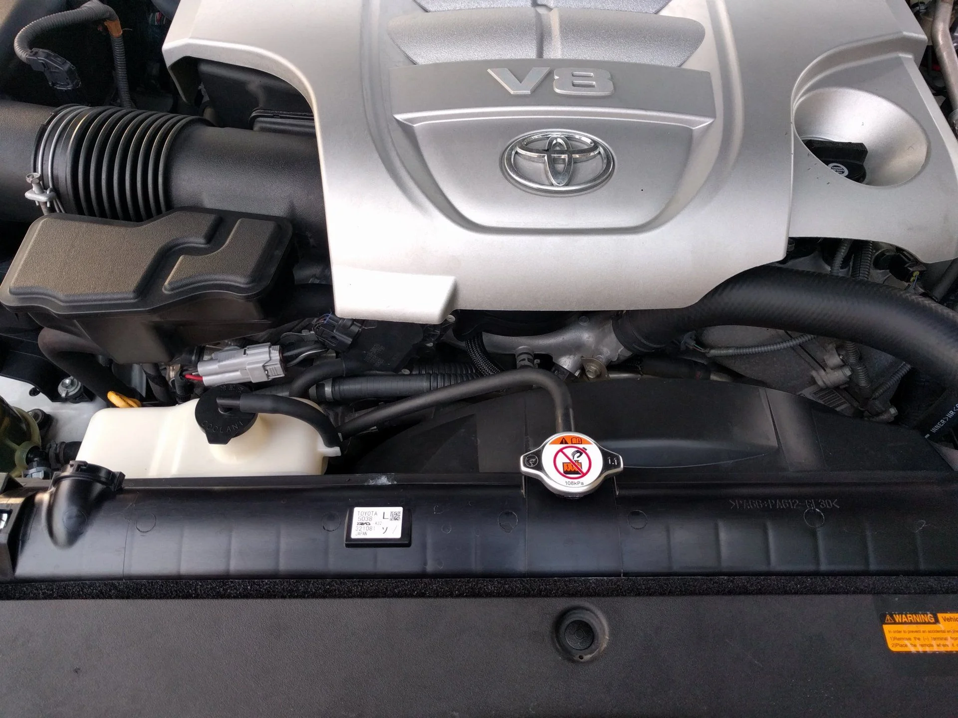

Anyhow, $860 later engine compartment looks much better with the new radiator, attaching the pic. Hoping this one will last another 100k

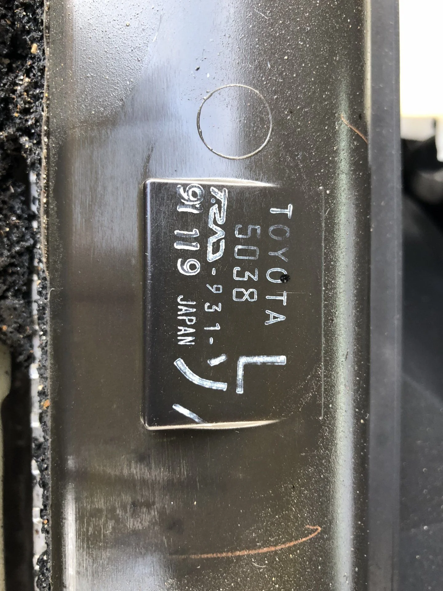

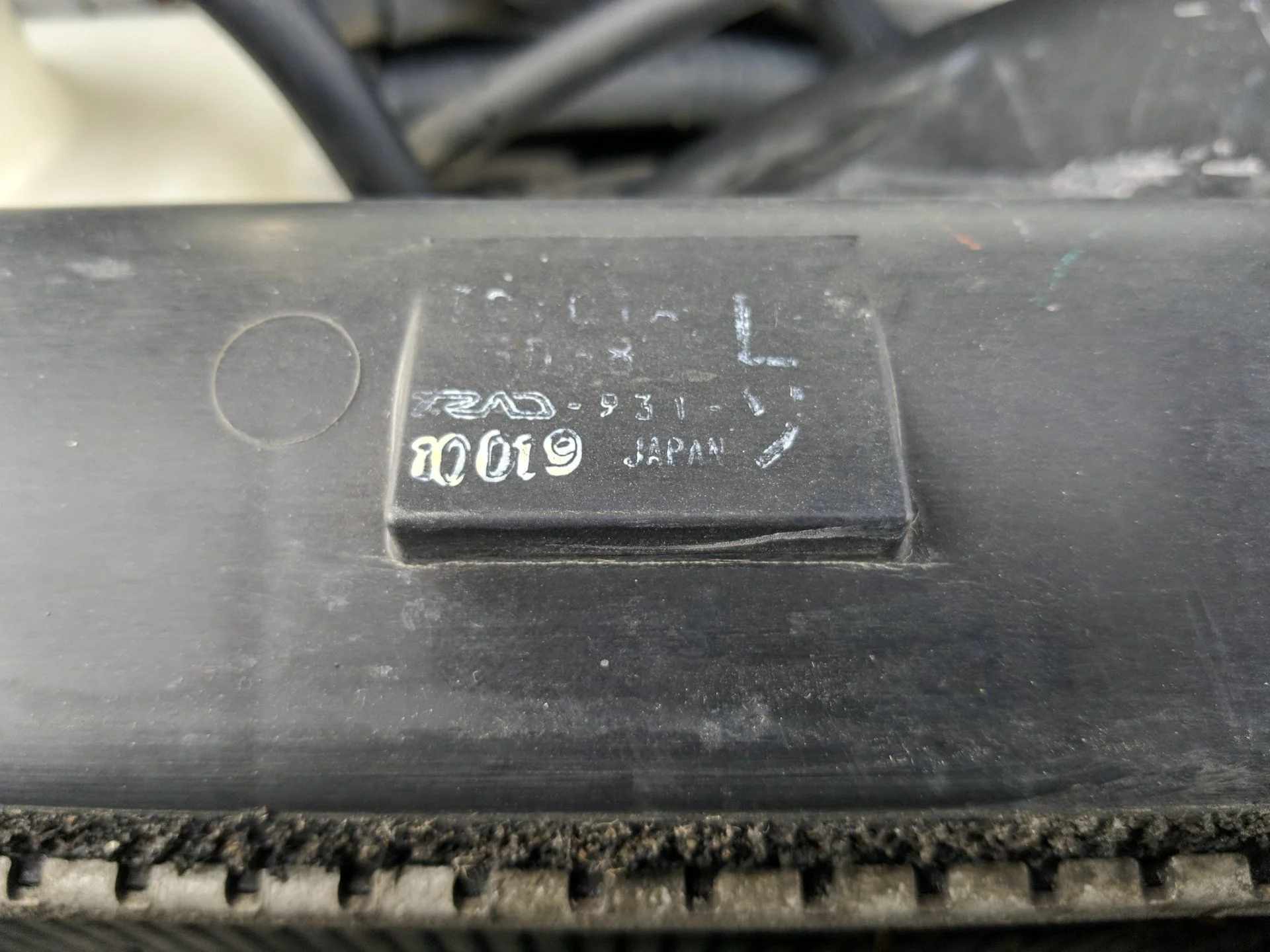

I don’t have any record of the Radiator being replaced. Can anyone tell from the markings on my Radiator if mine is the updated model replaced by the previous owner? Pic attached. Thanks!
