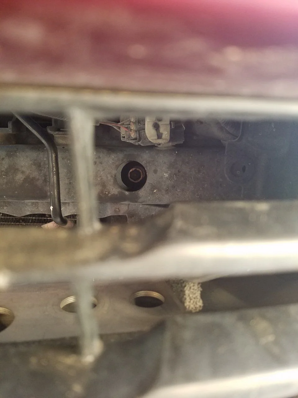

on the driver's side, use the holes in the grill to remove the radiator mount bolts (leave this piece on the radiator)
driver's side Radiator mounting bolt as seen through the grill

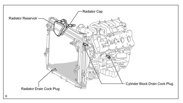

I followed the advice to reuse the passenger side radiator mount off the old radiator so I didn't have to remove the bumper and grill and that worked really well. The one thing that I did get caught up on was draining coolant from the engine block. It took me forever to find the cylinder block drain cock plugs as shown in the diagram below. The driver's side was almost impossible to see... and incredibly hard to reach. You can see the passenger side plug through the wheel well fairly easily... but the driver's side isn't in the same spot... I jacked the car up, stuck my head between the tire and fender and closed one eye and could just make it out (would have been slightly easier without the tire on). I had to use about 16" of extensions and and pivoting socket to reach it... luckily you just need to loosen the nut to drain it otherwise I never would have attempted as I doubt I could have gotten it back on without pulling the whole engine. If anyone needs any help finding these I can go out and take a picture.

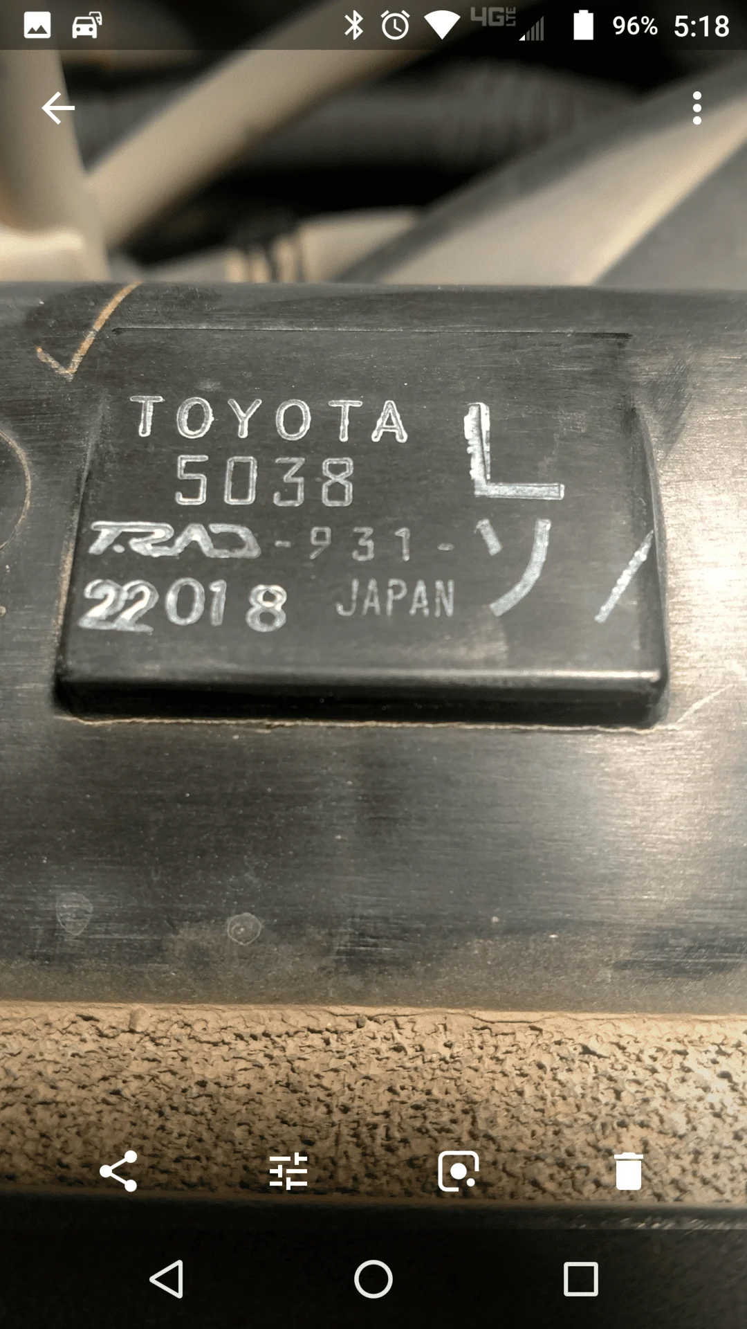

I read the first 8 pages of this thread and now the last two pages and it seems to me the radiator issue has only surfaced on the 08-11 model year 200. Is that correct? If so, how do we explain this considering the part no for the 2013+ are the same for the radiator.
They are different, maybe the uprevs in PN means the failure issues have been mitigated, hopefully.
16400-50380 (09/2007-09/2009)
16400-50381 (09/2009-01/2012)
16400-50382 (01/2012-01/2013)
16400-50384 (01/2013+)
Ok. I'm using Partsouq, but it looks like I have Production dates instead of application dates. My fault.
edit: actually, maybe "Production date" means model year (MY) production dates, not radiator production dates. confused.
Those dates are the production date for the Land Cruiser. However, your part numbers are most probably the original part number fitted to those vehicles. My point is, those old part numbers (16400-50381, 16400-50382 and 16400-50383) have been replaced with a new part number 16400-50384.
So, today, if you go to a Toyota dealer and order a new radiator for a 2010 Model Year Land Cruiser, which was originally equipped with radiator part number 16400-50381, they will order a new radiator part number 16400-50384 for that 2010 LC.
