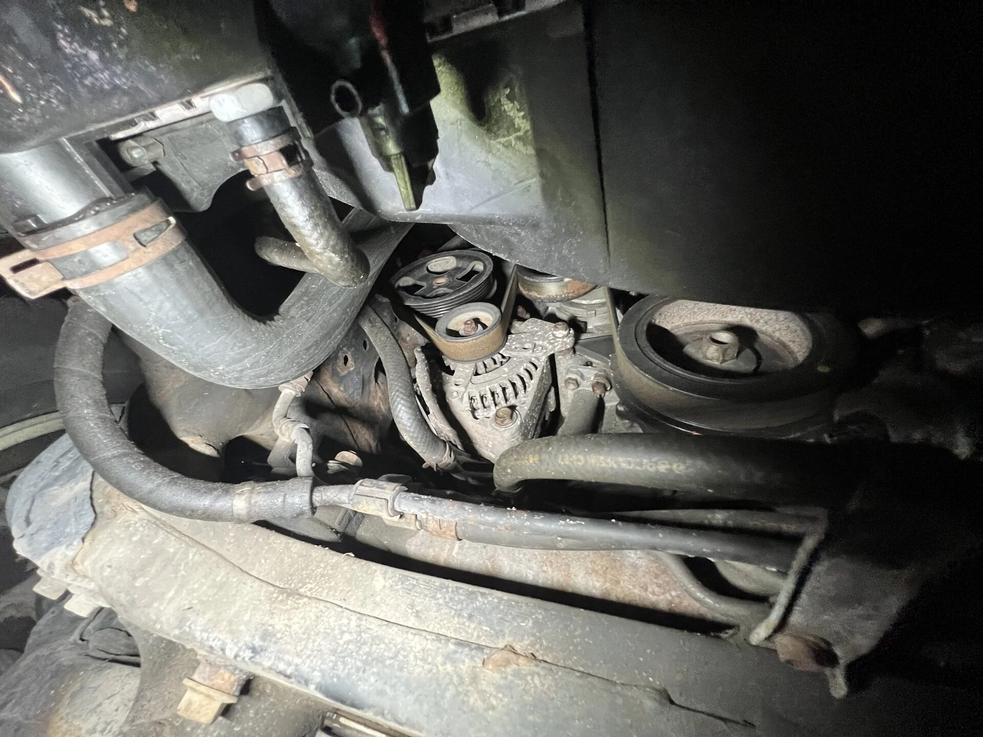

I’m fully ready to dive into the head gaskets now (and likely starter and timing belt/water pump while I’m in there) but I’m hesitant and wanting advice on what y’all think about this rigs rust issues. It was a Detroit cruiser that I had shipped down to TX At 220k miles. It now had 250k with these issues.

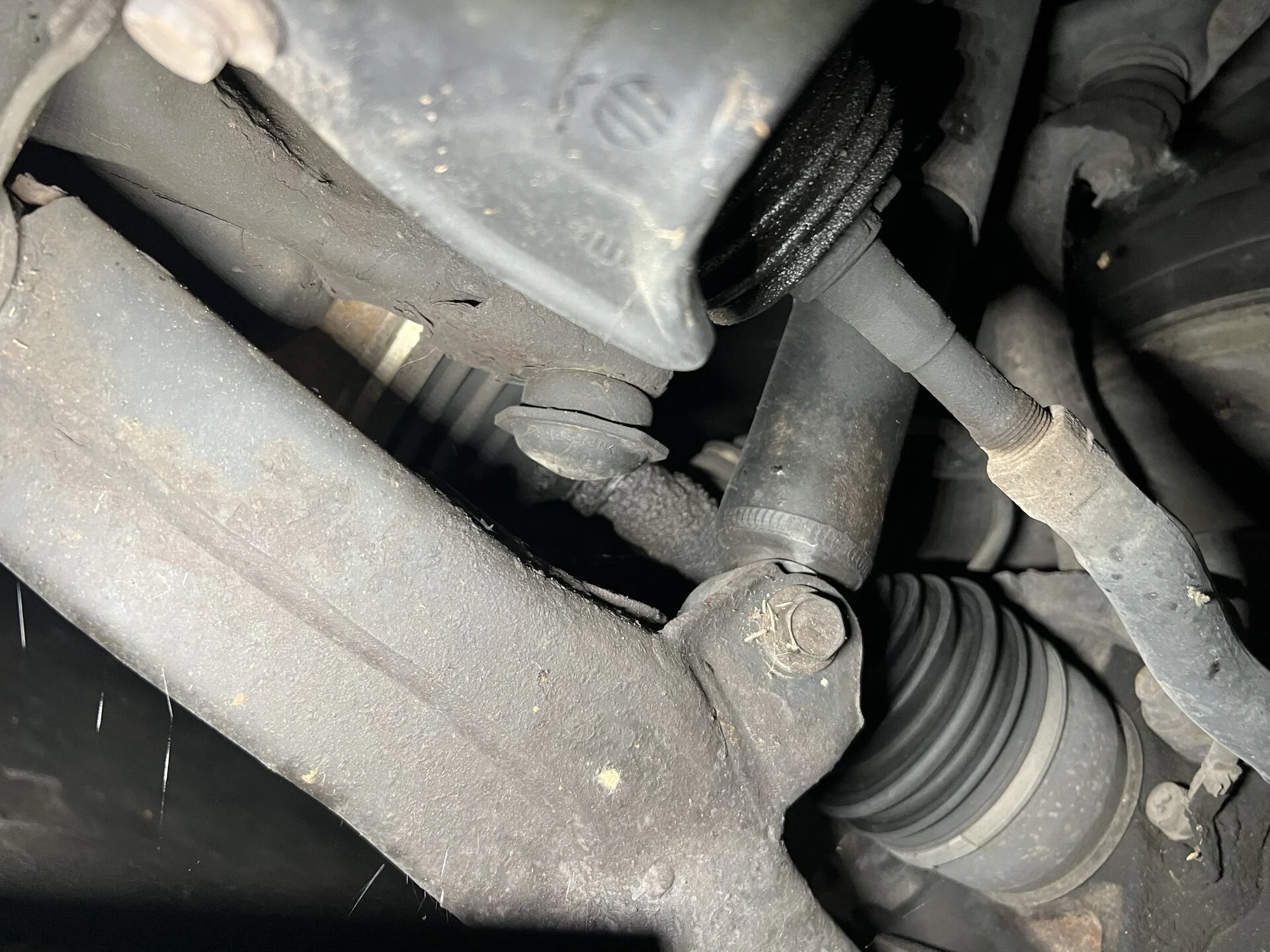

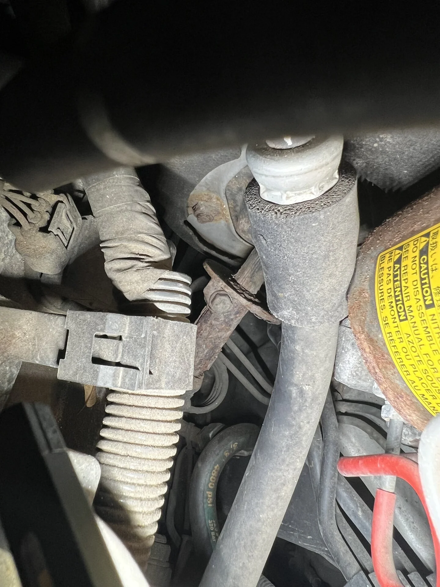

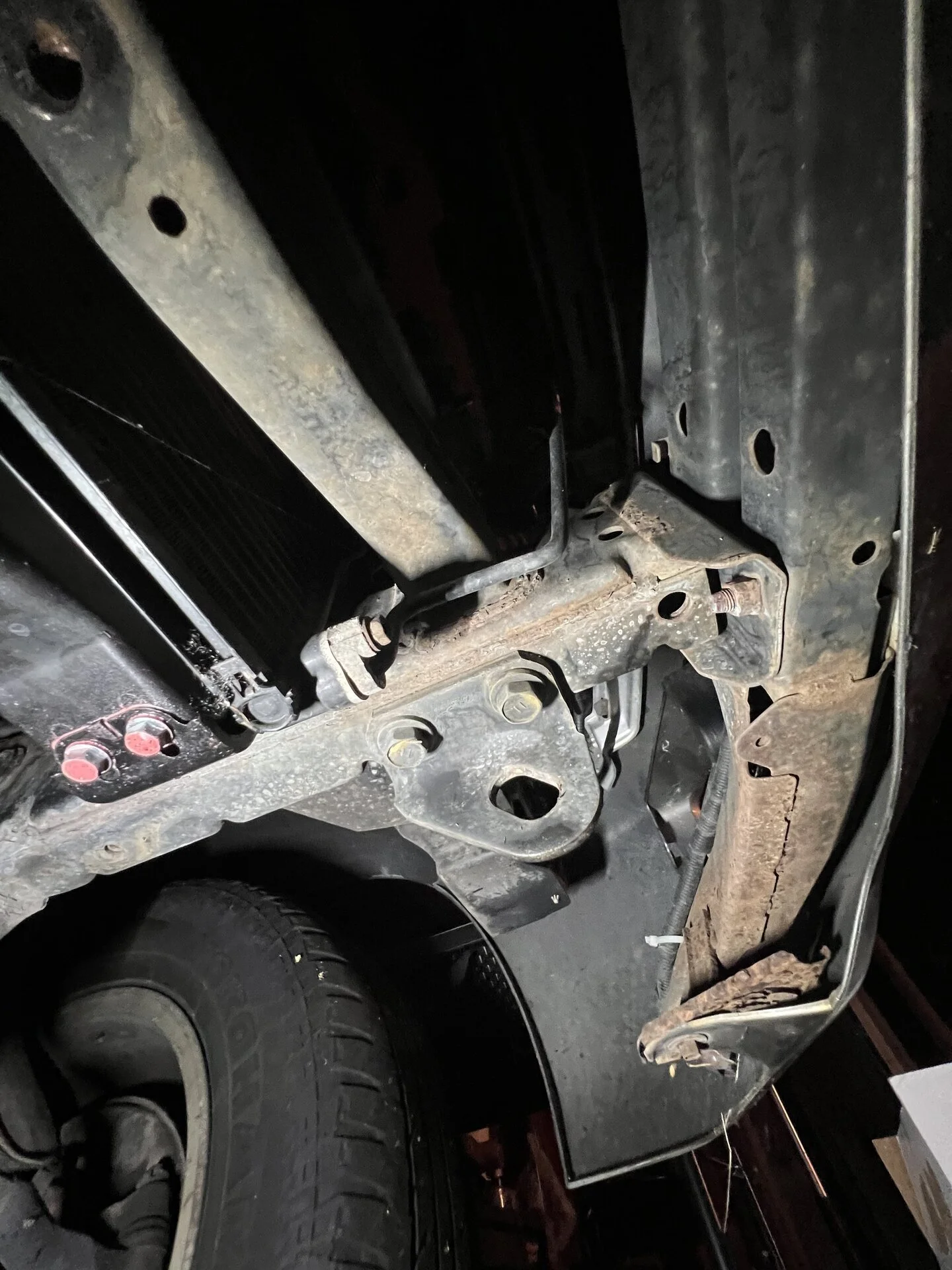

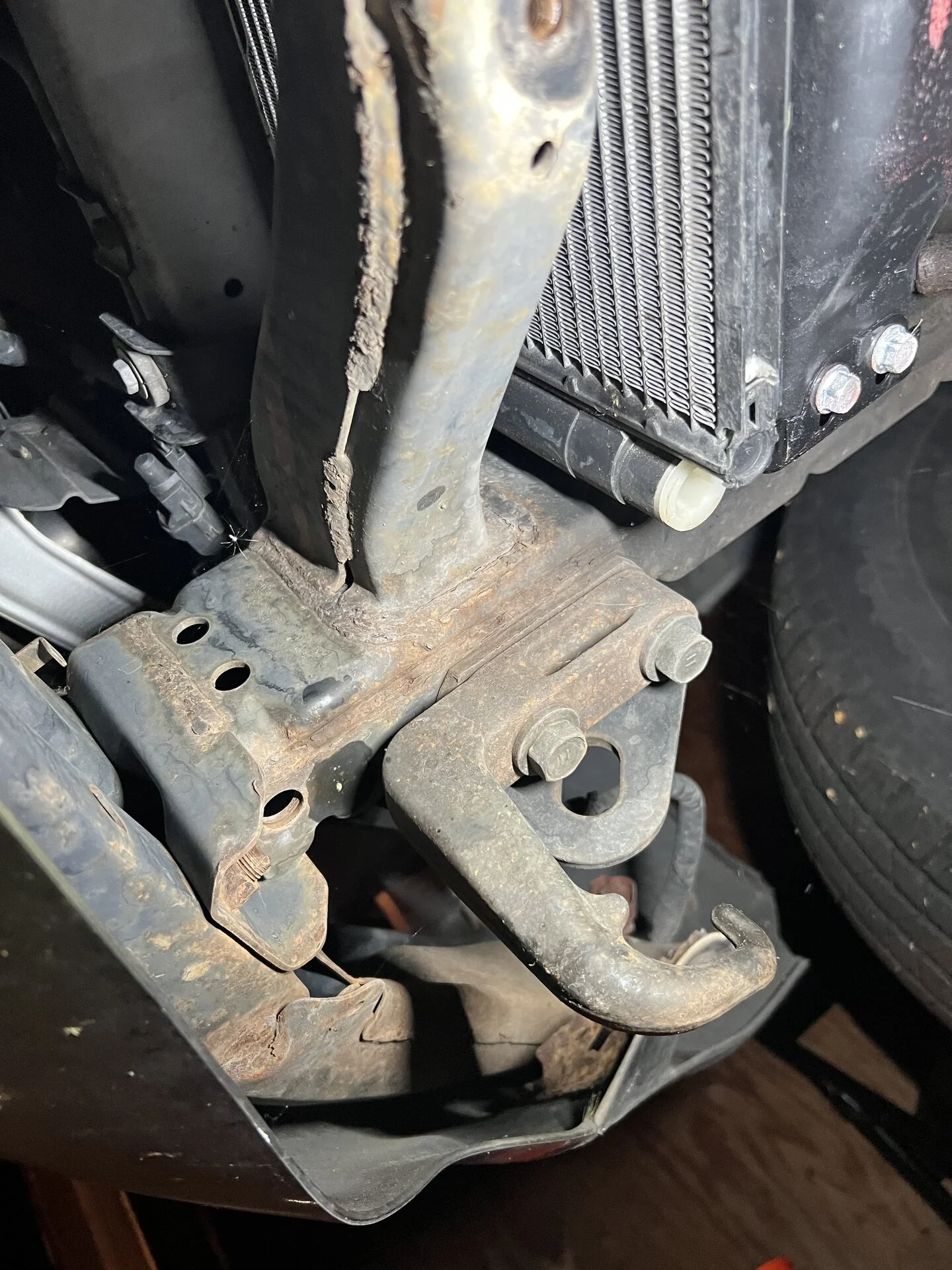

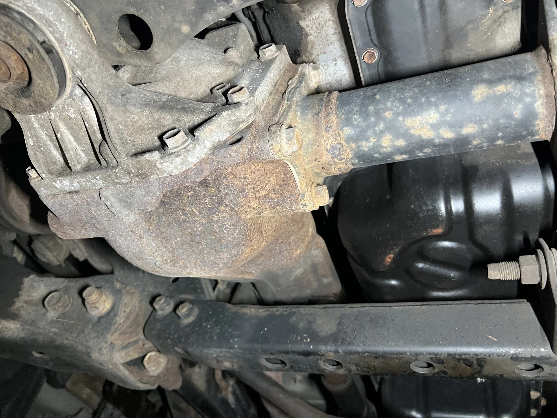

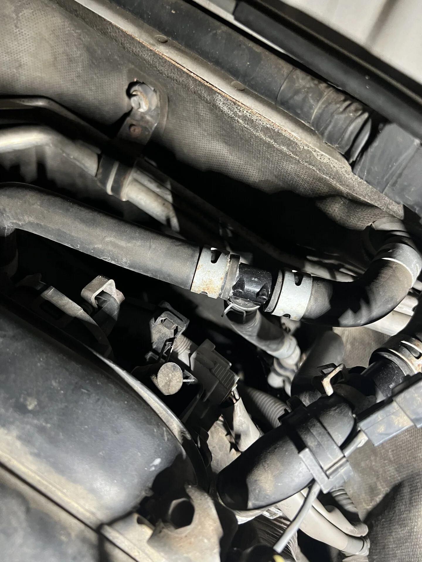

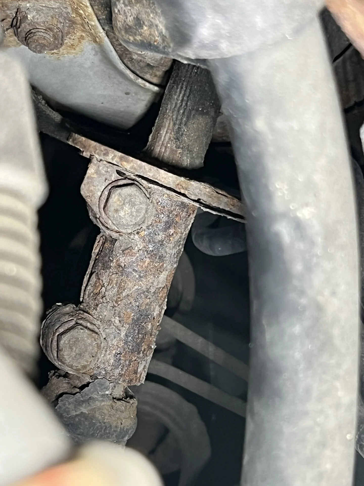

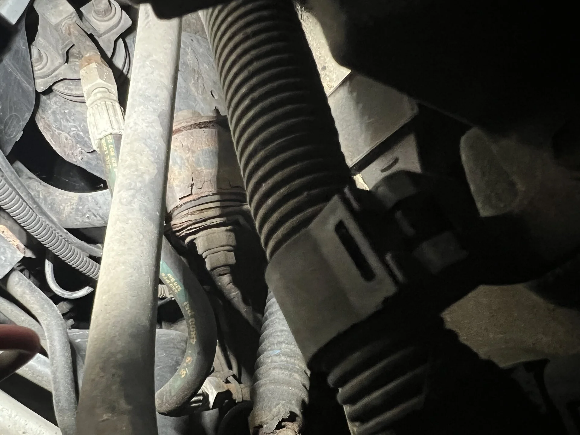

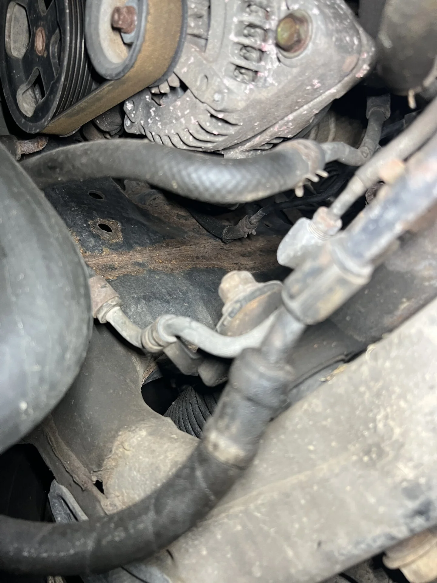

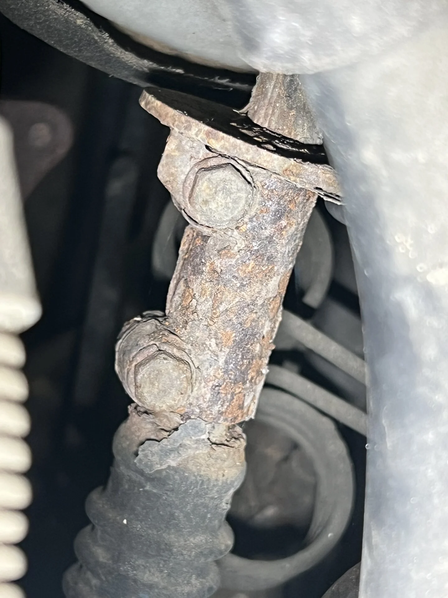

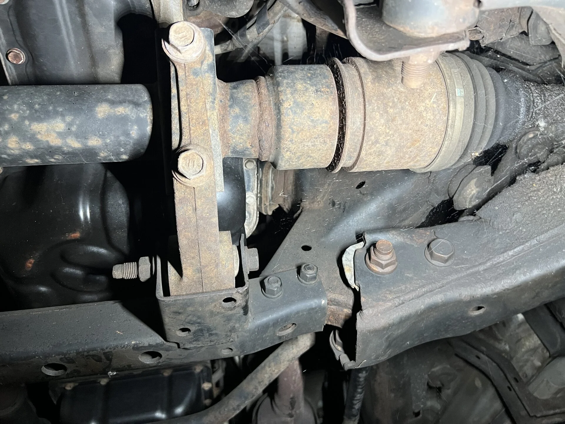

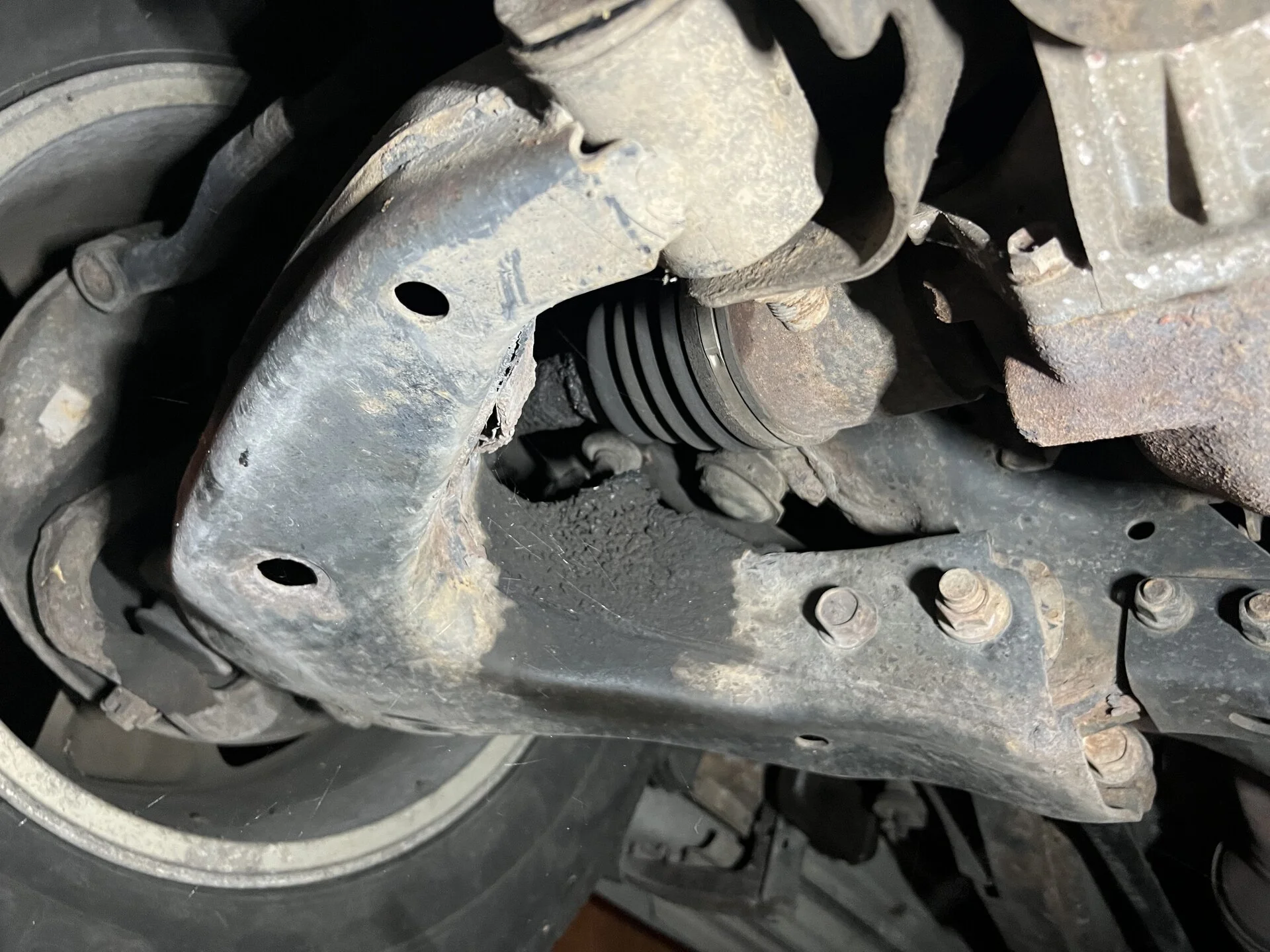

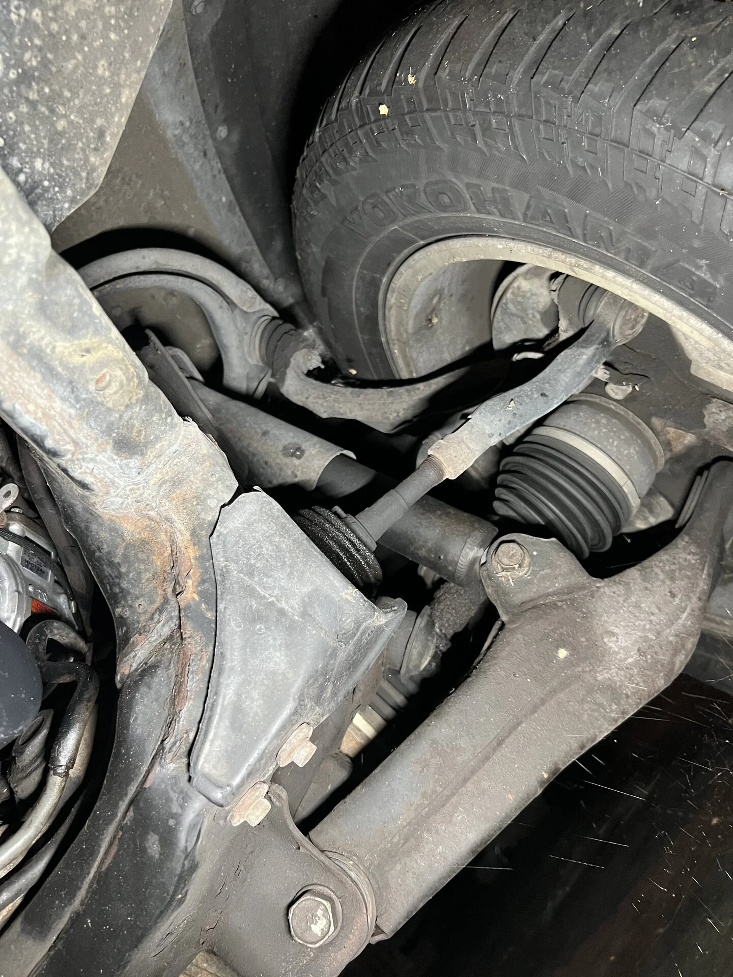

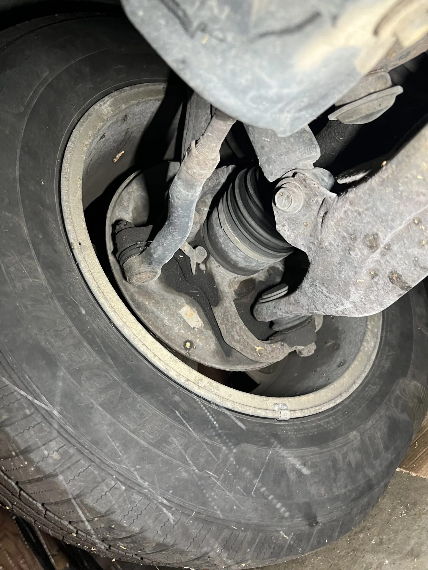

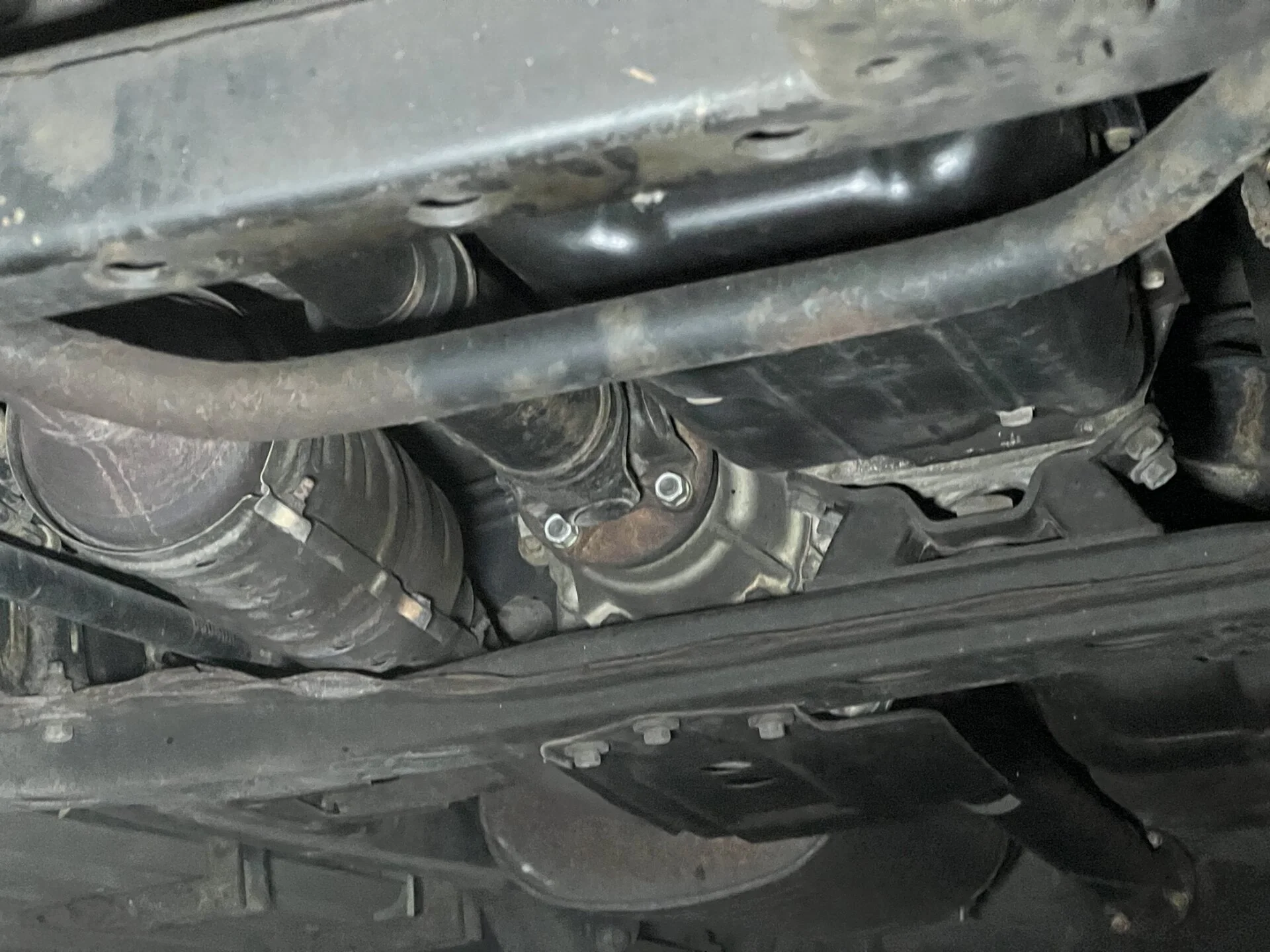

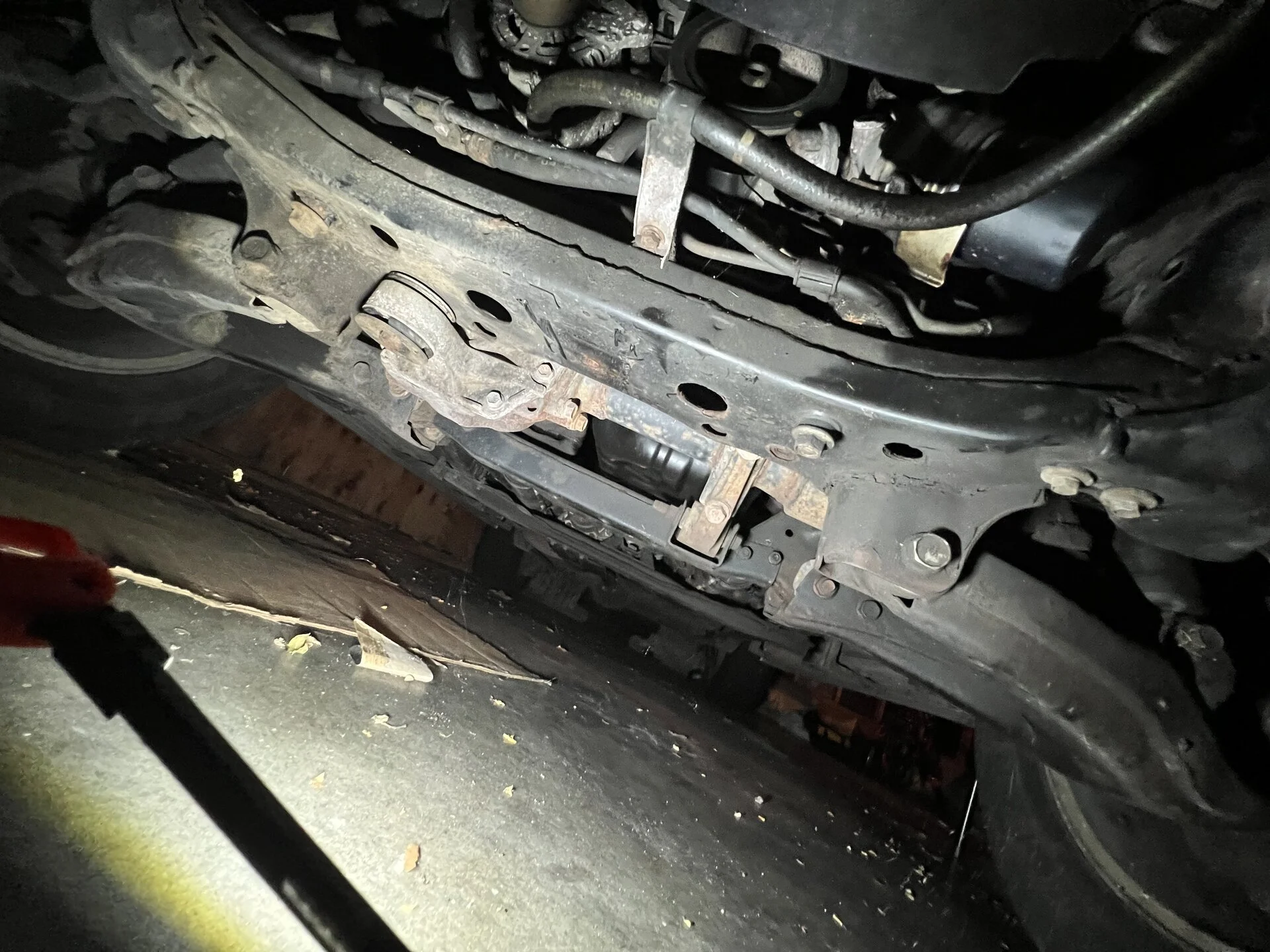

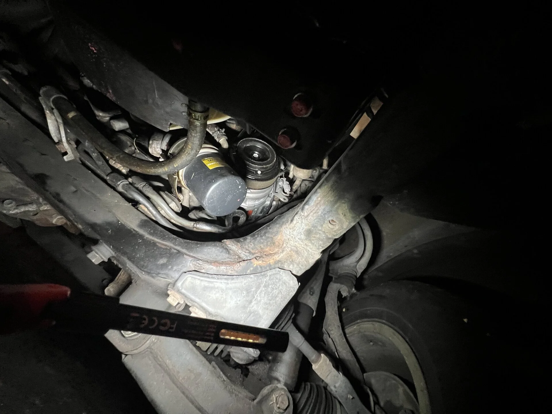

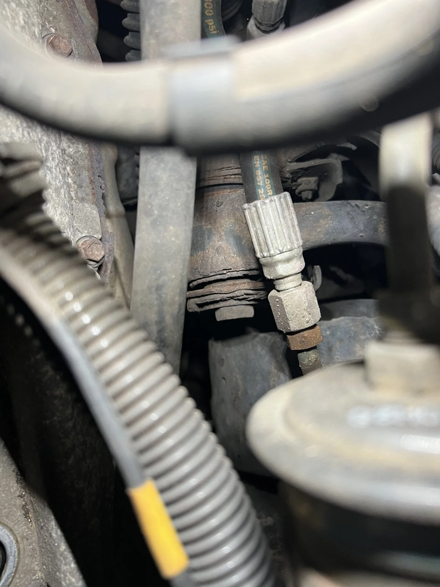

Please see some pics below. My biggest possibly silly worry is how the steering shaft looks. I poked it and the outside wrap(?) disinegrated. Kinda scary to snap that while on a trip. I also took pics of other problem areas I saw including the frame, absolutely filthy disgusting crevices next to intake manifold nuts, and the rusted nuts and bolts I’ll need to take off for HG..(sorry for the sloppy pics!)

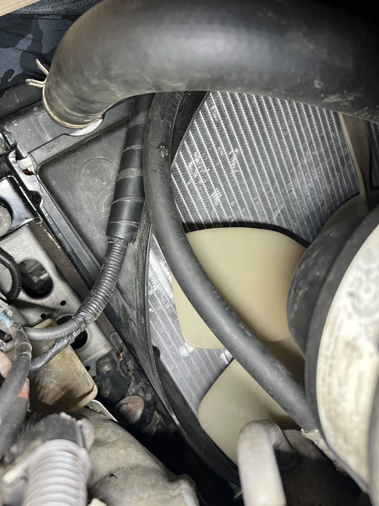

OH, and that’s my brand new radiator that I just noticed I jacked up while installing!! How bad is that?

It’s a little crunchy which might make some bolts harder than typical. How has it been working on it up to this point? Breaking out the extractor regularly? If the truck was closer to 100% I might try replacing some of the more critical components.
Given it is an ‘07 with a VVTI that makes finding a replacement engine a bit tougher. The risk with trying to repair this one is you don’t really know how bad the compression leak is. Engine could be fubar as it stands.
Are you referring to the bent fins on the radiator? If so they can be combed out. As long as it is holding pressure I would run it.

Ok sounds good on the Rad.
