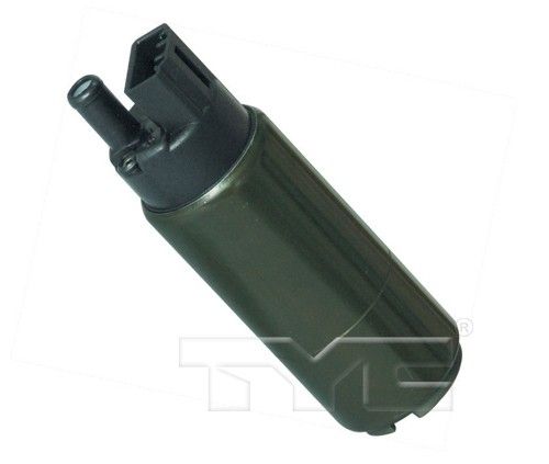

Getting ready to replace my fuel pump, little confused on the layout. Does the 06-07 fuel pump not come with the little black rubber tubing sticking that that connects to the pump module?
The previous ones i see for sale have that tube sticking out, how do you guys connect using the sequoia pump??
This is a pump assembly from a 2007, does the black cage/housing swap over so you can feed the pump to the module?
NO, the one for the VVT engine (06-07) does not have the tube. The pump repeatedly shown in first page of this thread, is the one you want. You'll pull pump from cage and insert in your cage/assembly.
