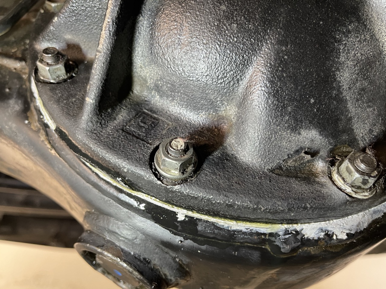

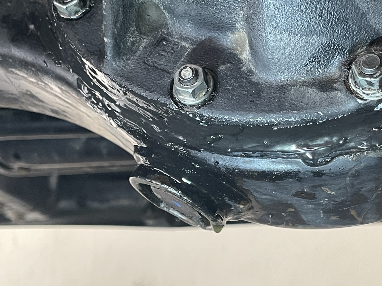

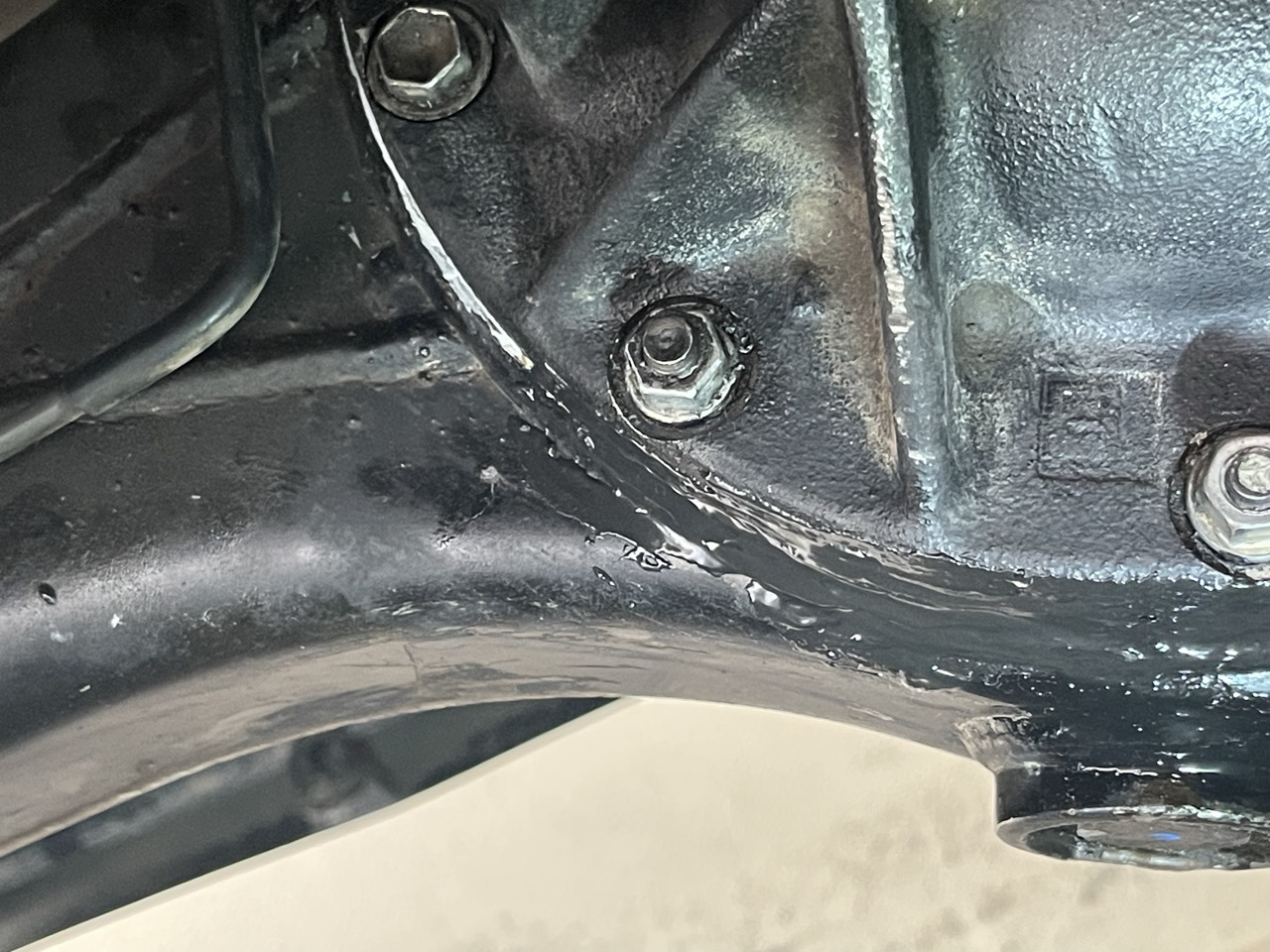

Yesterday, I spent the whole day at the mechanic's shop to reseal the front differential. I even provided genuine paper gasket to the mechanic and the mechanic also used silicon, but it still didn't fix the problem. The next morning, there were still tiny drops of oil leaking from the front differential.

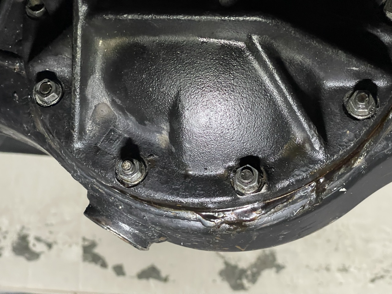

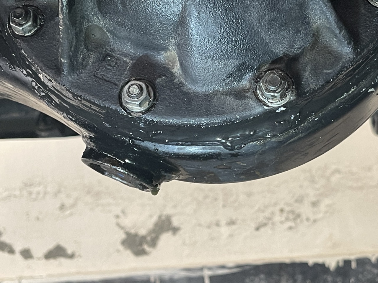

I called the mechanic today and told him that the diff is still leaking oil, and he told me to bring it back, he said he will use JB weld type of glue to fix the leak. Before heading back to the mechanic, I drained the diff oil and applied jb weld glue on the joint where the leak was coming from, I let the glue get dry, and after I filled the diff, it started leaking again.
What is the proper way of sealing the front differential?
Post pics

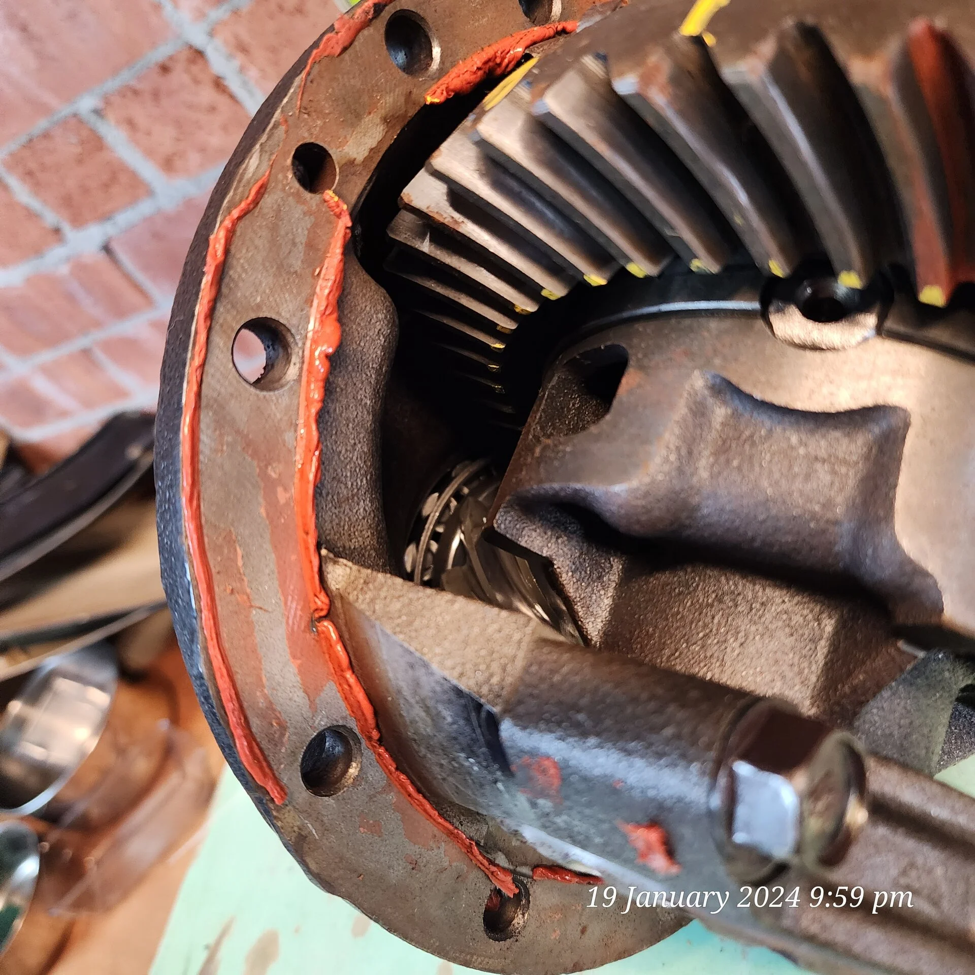

Here's a pic of a diff centre I used RTV on. It squished almost completely out leaving just the thinnest film to try to seal.
I also think RTV stays kinda slippery when it's set, so parts are more likely to move at the junction.

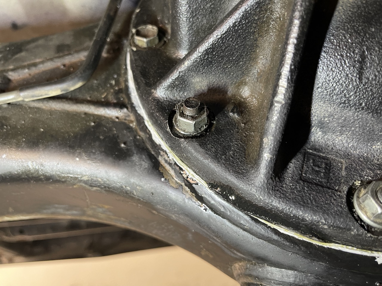

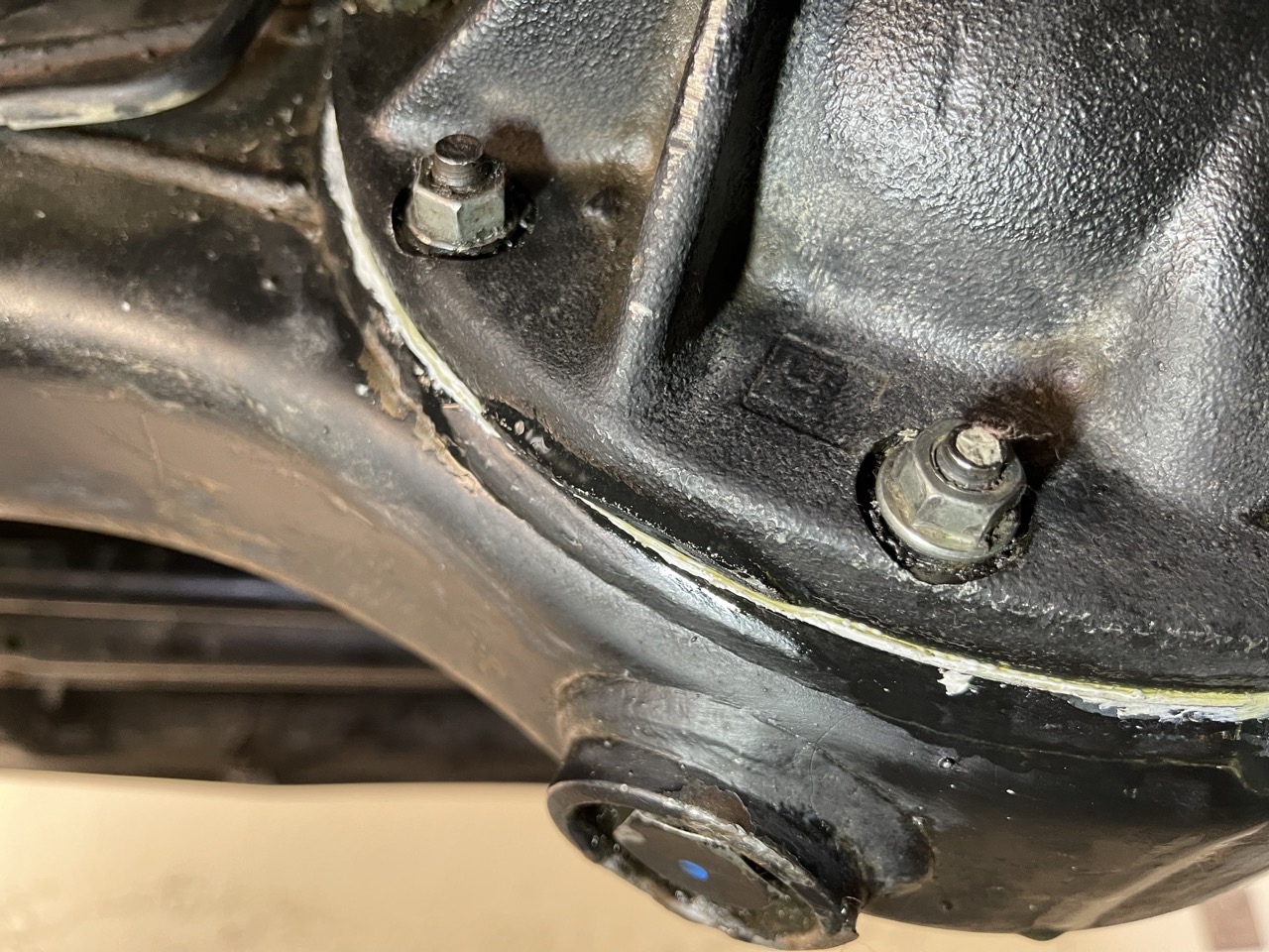

If you zoom in this photo, you will see the lip of the diff is sort of dented outwards. I am not sure if this got hit by rock, or it's from factory like this. I believe this maybe the cause of leak.
