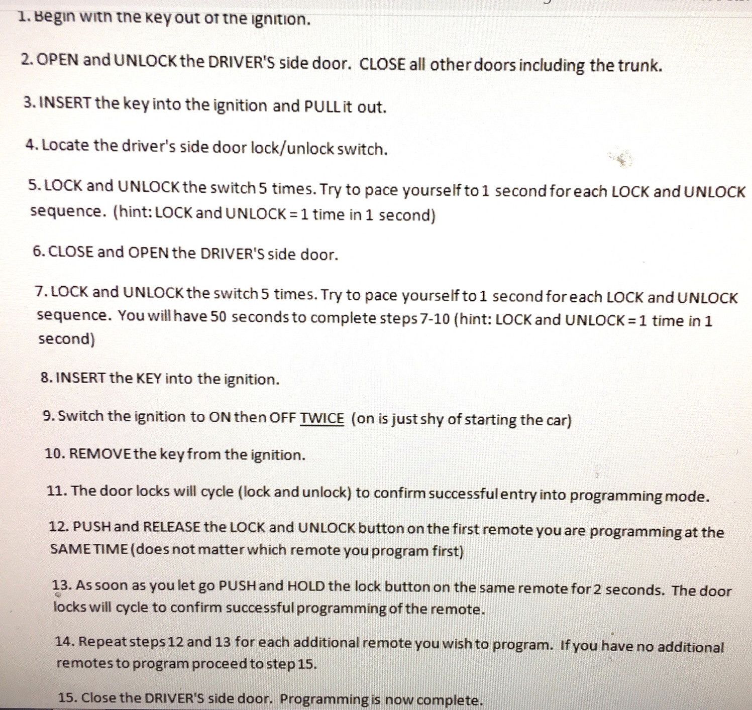

Print this out, follow it to a 'T' and let us know at what point (if any) it fails. When doing the door 'lock/unlock' it can be sensitive to the 'cadance'. About 1 second intervals....works for most.
As for you comment about 'TONE'......I'm not sure where you got that from. But just to be clear....I don't really give a damn if you get your key programmed or not. I understand you are frustrated with it....but we are trying to help you with it. So I recommend you cool your jets, answer any questions we may have (whether you understand the reason for them or not) and be patient.
Try the above and let us know what happens.
