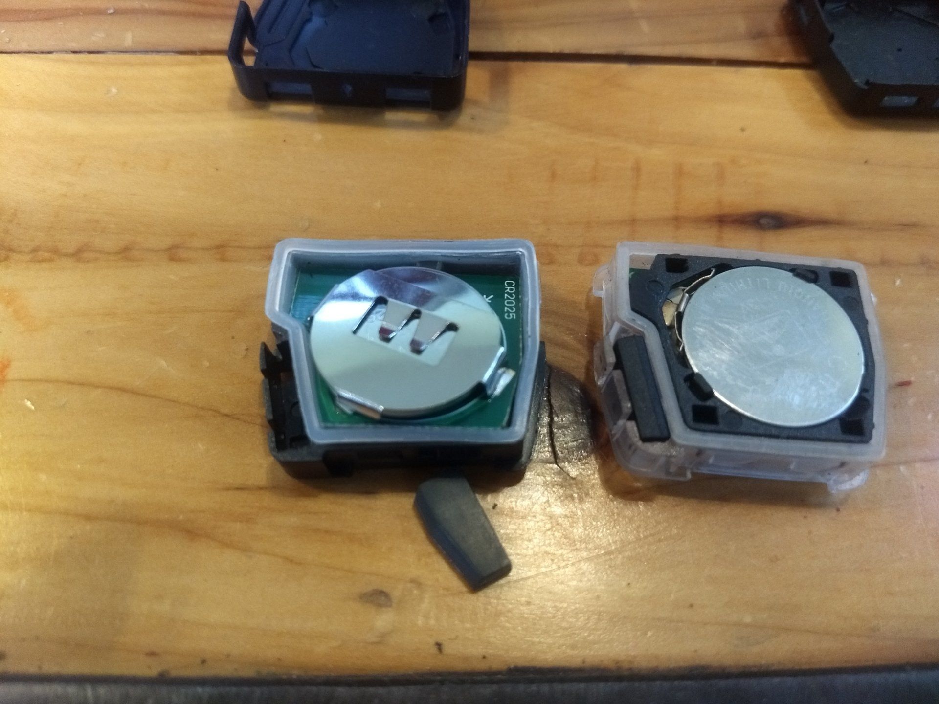

I now have a tool to read the transponder in the keys. The keys from Amazon have a 4D68 tp30 tag which is for Toyota. They come up on the reader as a Toyota master key. What the Lexus uses is a 4D68 tp29 tag.
If the remote is correct then you can change out the transponder chip.
I thought about buying a 4D68 tp29 chip (about 10 bucks shipped) but I haven't seen that done before. Does anyone know how easy it is to swap out chips for immobilizers?
Here are a couple of remotes I bought from Amazon. These have a little compartment in the lower left that holds the chip. Just pull the back off like you do to change the battery and pull the chip out with tweezers.
I ordered some tp29 chips about a month ago, hoping to have them next week. Will be able to ship them for about three bucks each.

I will test them on the GX when I get them and let you know. I know that the GX and LX use the same chip beacause I sent a chip that worked in thr GX to another member with a LX and it was the same.

Mauser if you have two extra I'll buy them. Or please direct me to where to find the correct chip.
I have a limited supply right now but do have 2 for you. 3 dollars each plus a buck to ship.
I will send you a message.
We were successful. Replacing the keytag in the aftermarket keys with the 4D-68 TP29 keytag worked. I will send an email to the seller I bought my keys from on Amazon to let them know why their keys can't be added to the ECU.
I can confirm the 4D-68 TP29 chipped worked on my '05 LX. Registering accomplished via Techstream.

A lot of the aftermarket keys with remotes are sold with the incorrect chip. They have the chip for Toyota master keys instead of Lexus chips.
I have the correct chips.
