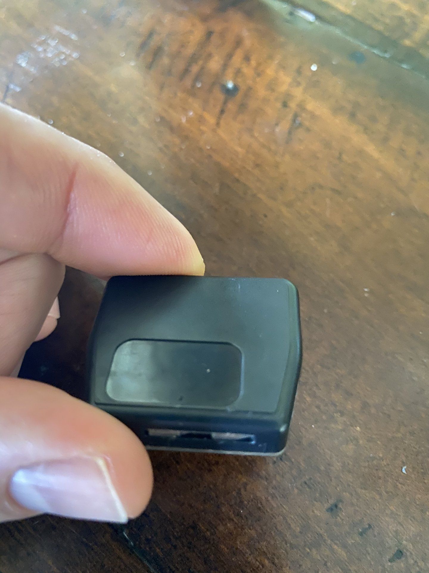

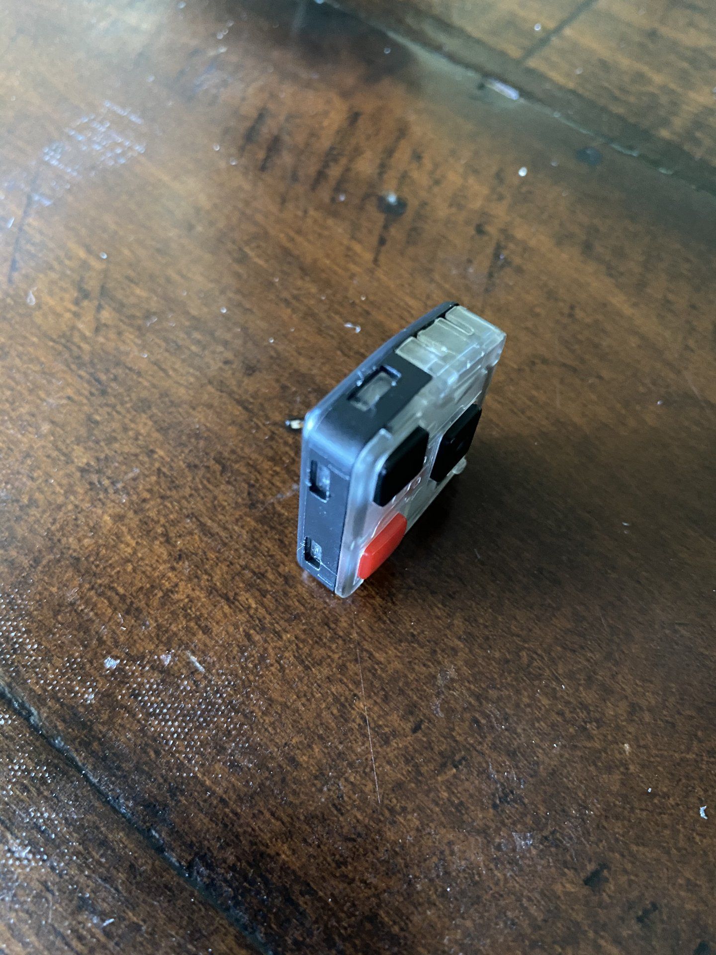

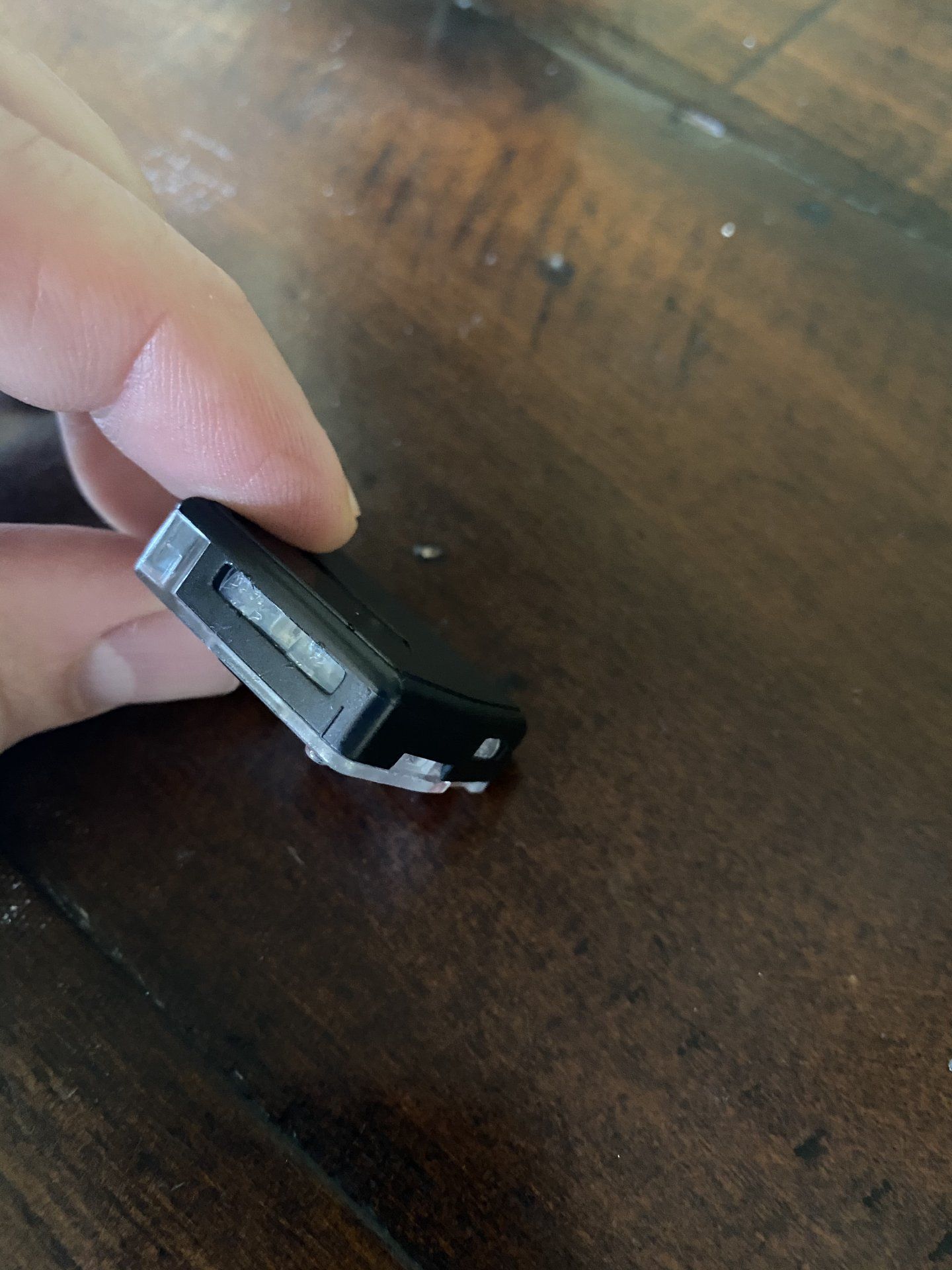

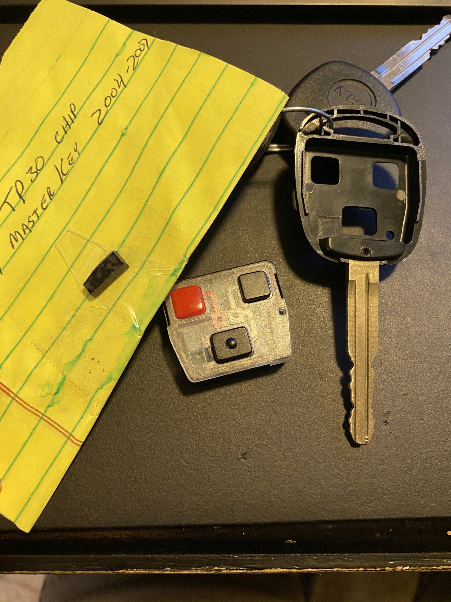

Hey Mauser,
trying to switch the chip out in the amazon replacement key I bought. But it looks like this opened up. Is the chip in the electronics?
Hey Mauser,
Yes. Open it up like you are changing the battery. There os a pocket for the chip.
Sorry I can’t seem to figure out how to open it. No tabs that’s I can see just indentations.. Is there a trick?
Few more pics
Just an update for anyone having trouble getting keys for their LX's. I ordered These keys from Amazon and the remotes programmed no problem. The transponder chips in these keys are for Toyota, not Lexus, and I was not able to get them to start the vehicle. @Mauser was able to send me the correct chips for Lexus (Big Thank you very much!) and now they both keys work perfectly. Just wanna thank everyone on the thread that was able to put in their $.02 and help me key spare keys for a fraction of the cost the stealership would have charged me.
