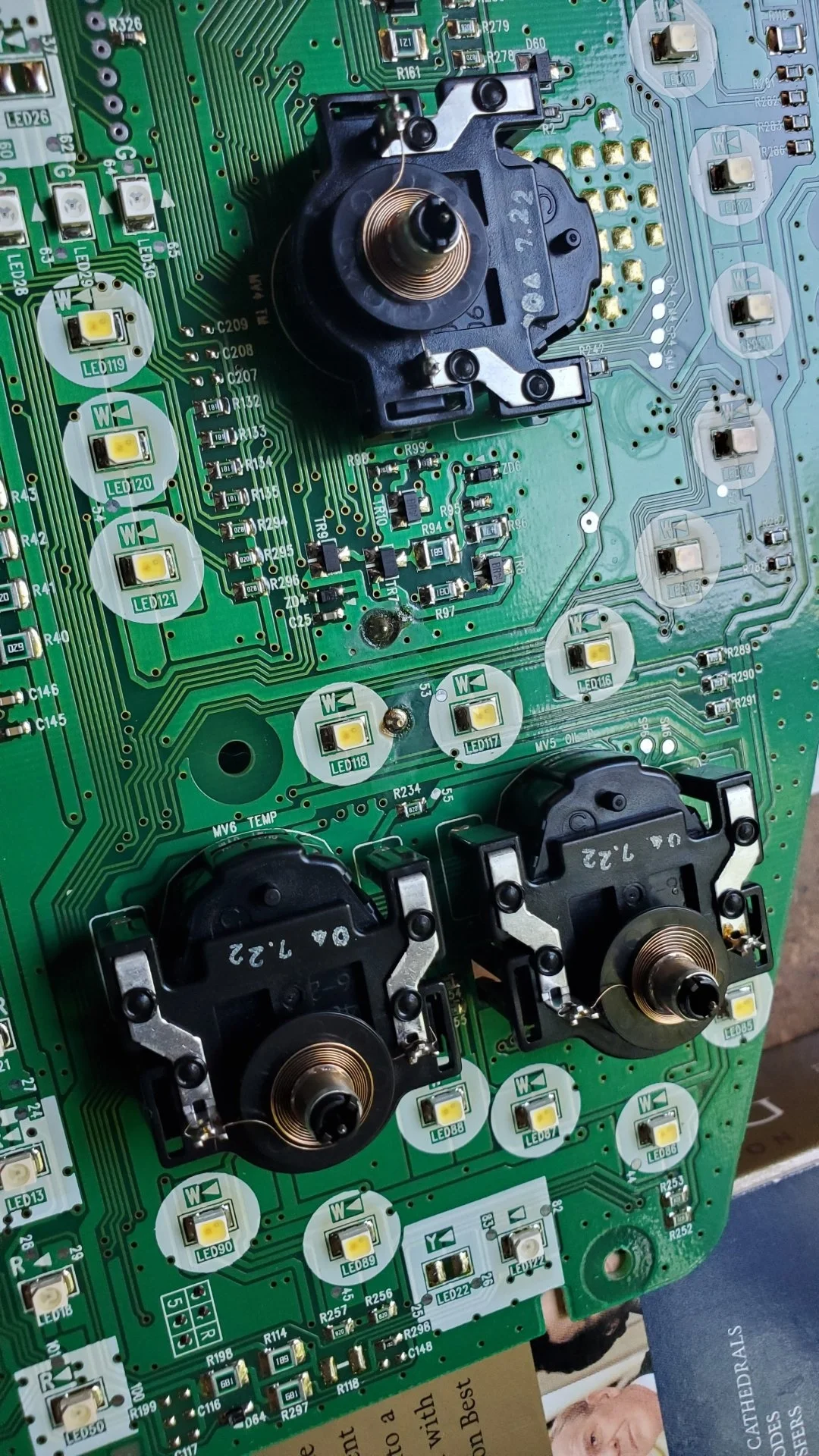

Does anyone know where I can get a stepper motor for a 05 LX470? See attached picture.
If you have read through the threads, you will find the answer: impossible! Unless you can find/buy a used instrument cluster from a junk yard I guess.
Also, there were several motor swap cases for LX470 which confirmed the motor is not the culprit. You can confirm this by swapping a "good" and a "bad" motor.
