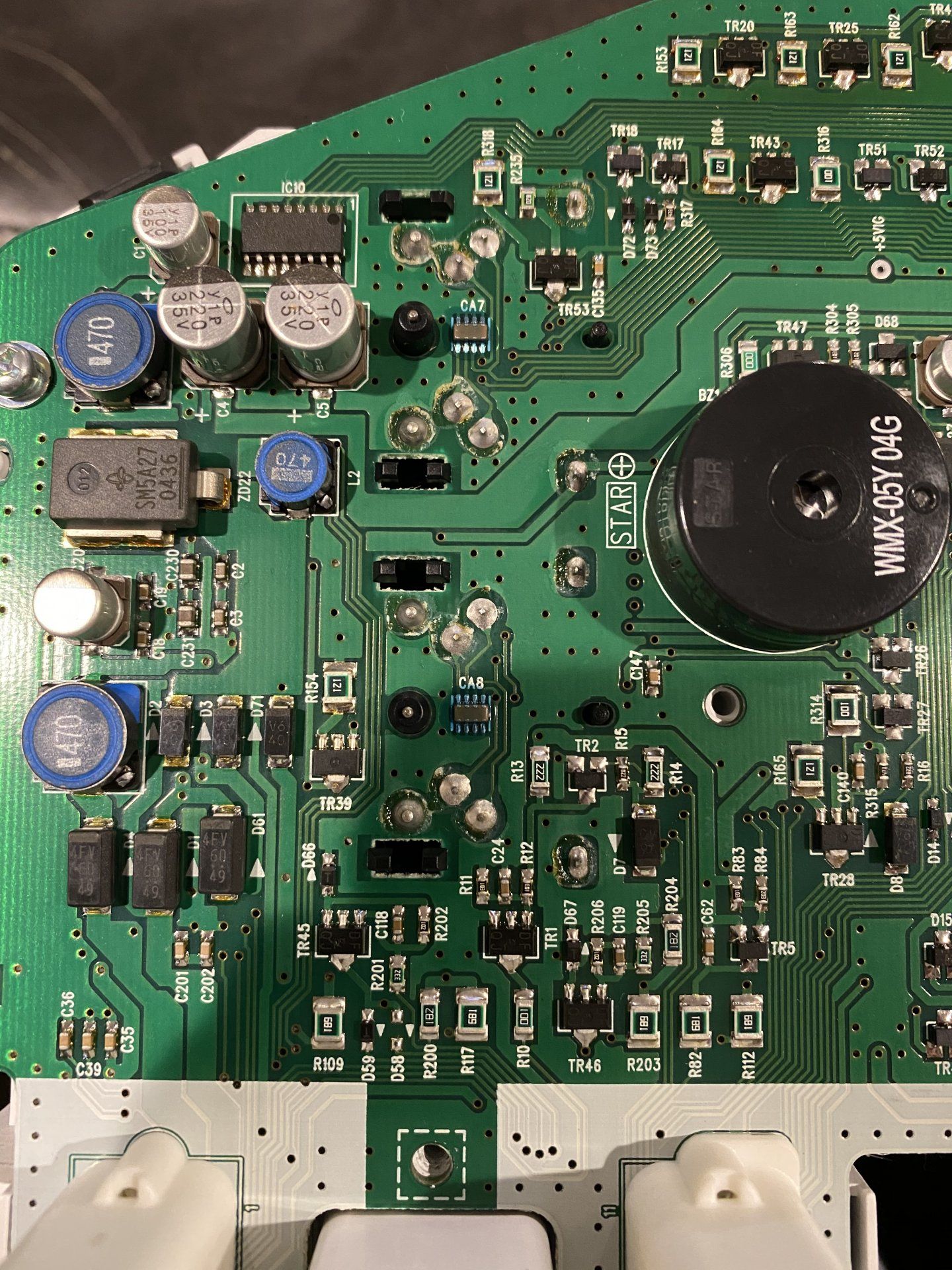

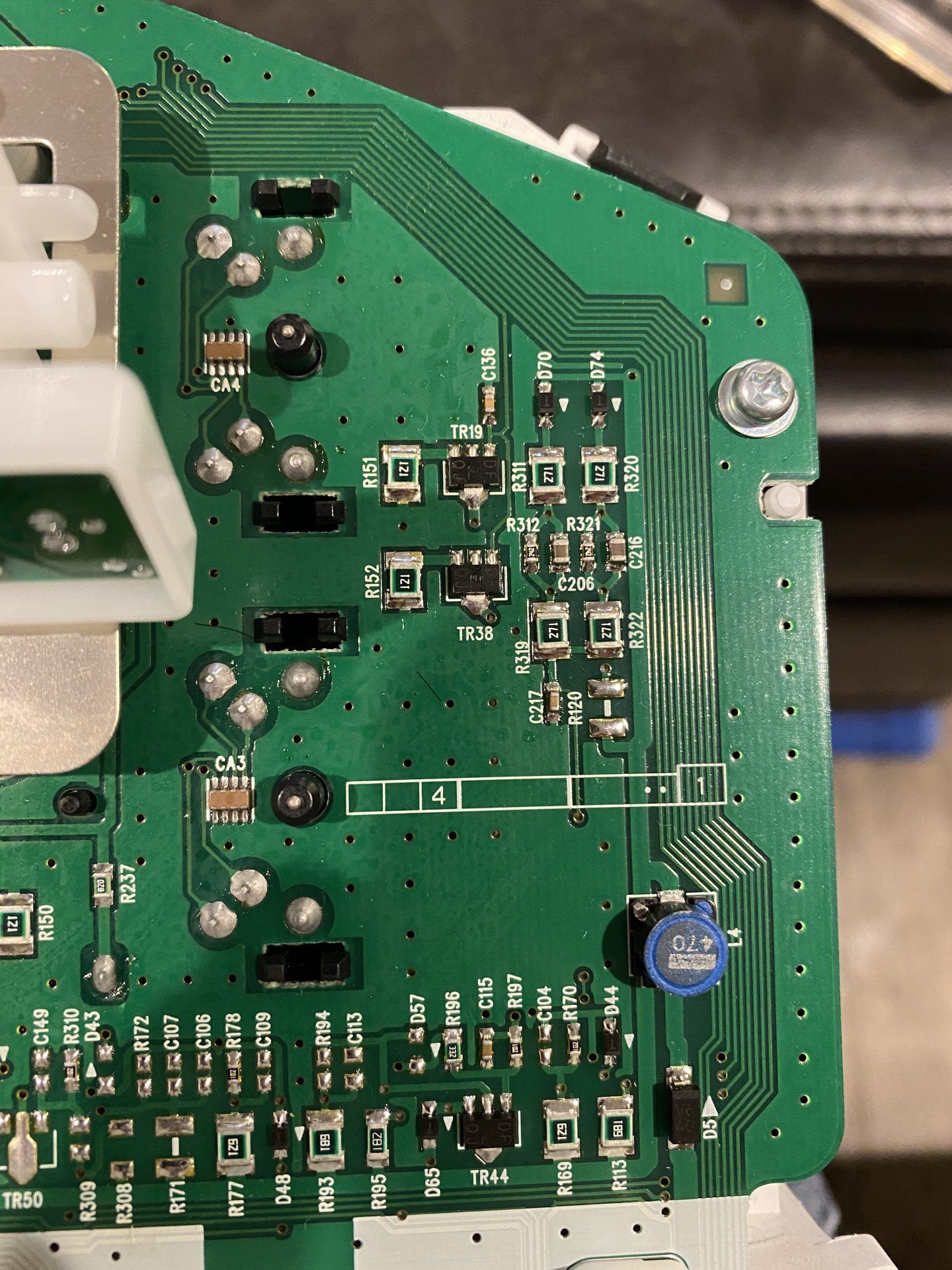

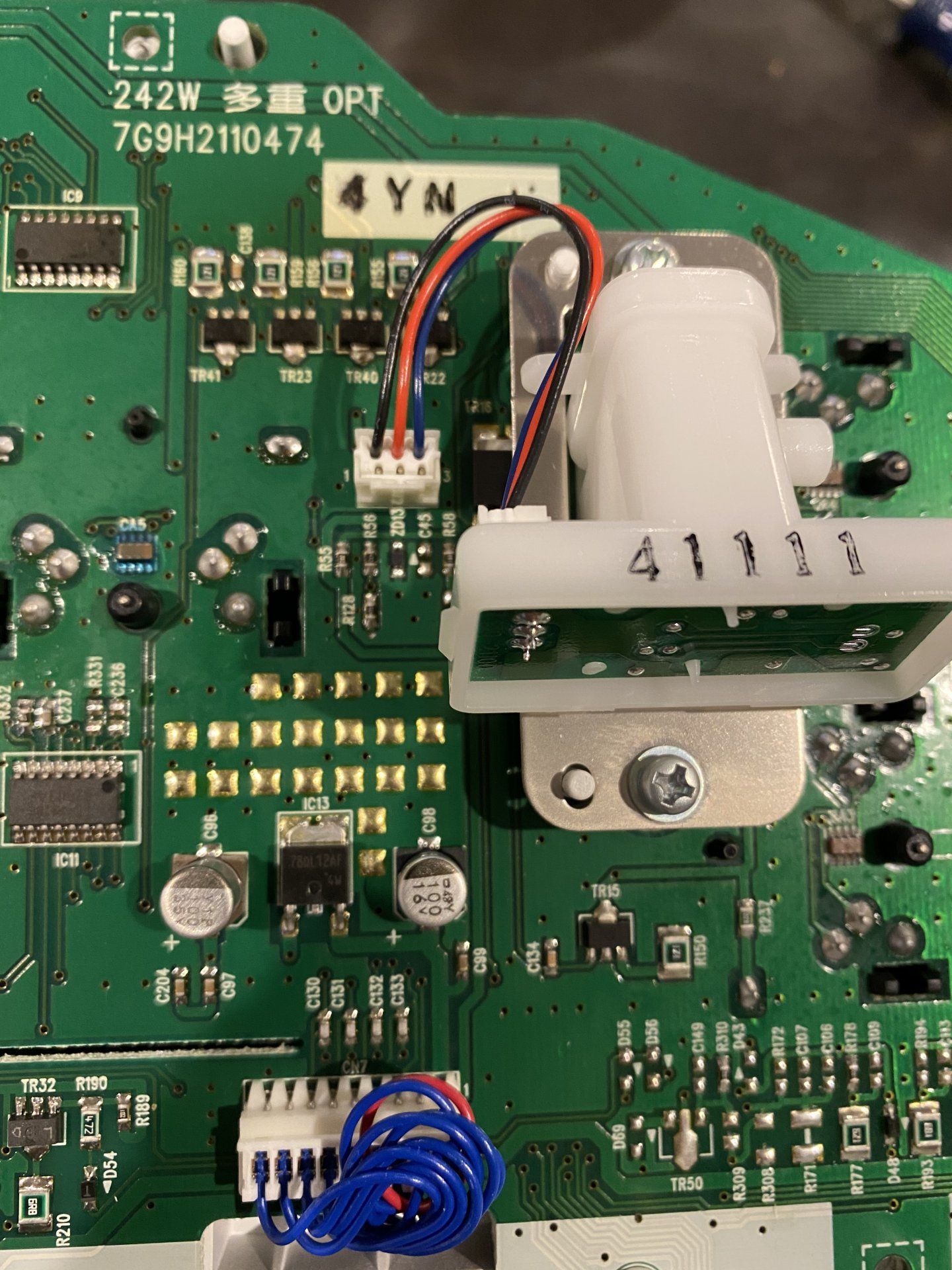

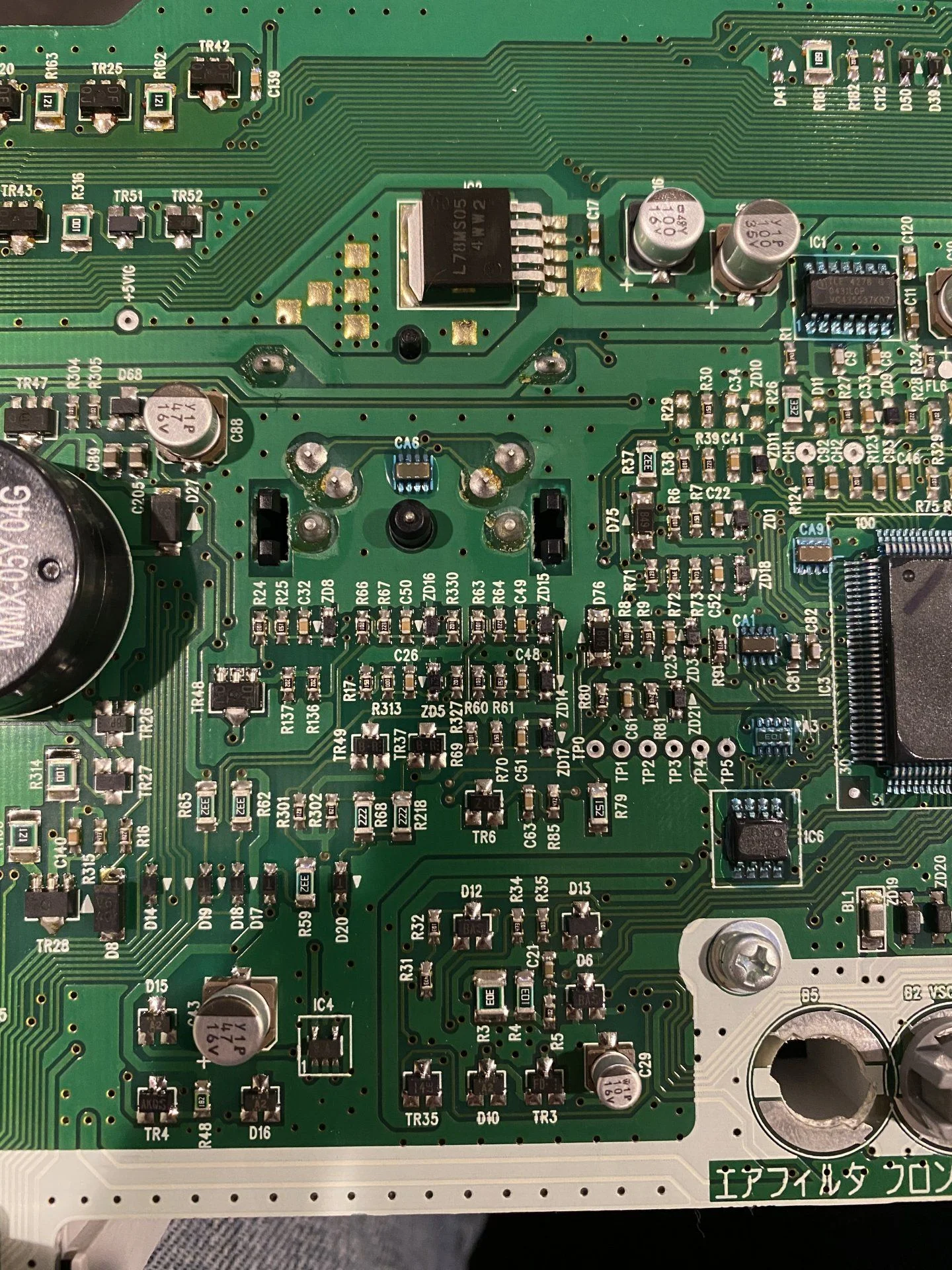

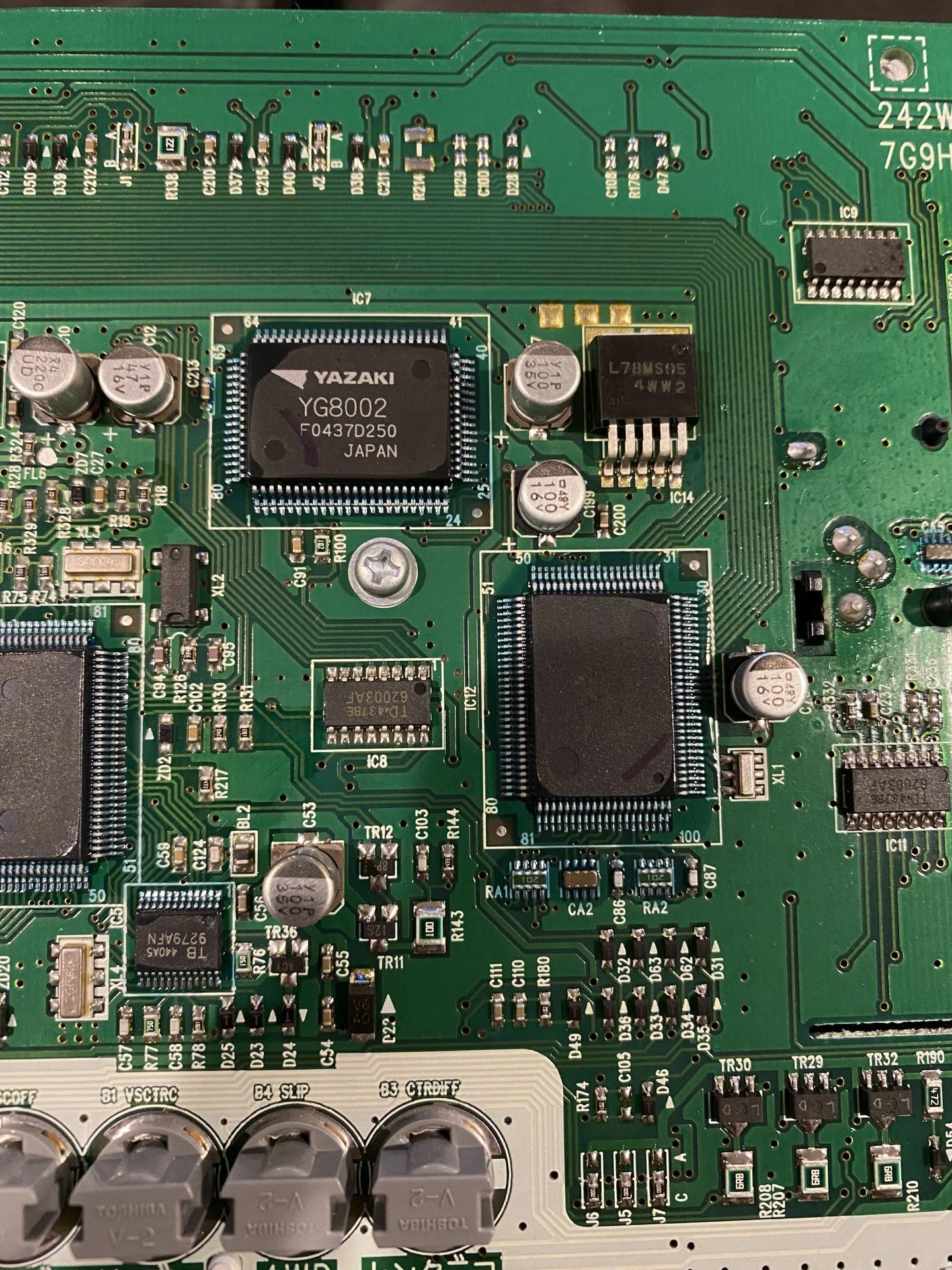

Okay, so got the cluster back from the shop and here are pictures of the back side of it. The order of the photos would be the first photo is the back of temp and oil pressure gauges and they work their way across the back ending with the battery/fuel gauges. I took close up pics so everyone could see the soldering incase there is something I missed.
He did not specify in the notes which spots he resoldered but it looks like the spots where the stepper motors are soldered. Like I said in my previous post, he mentions again check all grounds on vehicle but since Tannin Auto
can fix this with just the cluster I don’t see how a grounding issue could be our problem.
Anyway, I put everything back together and all gauges are working (but it seems they do for a little while every time I have pulled it).
I will update in a few days and let you guys know if anything has changed.

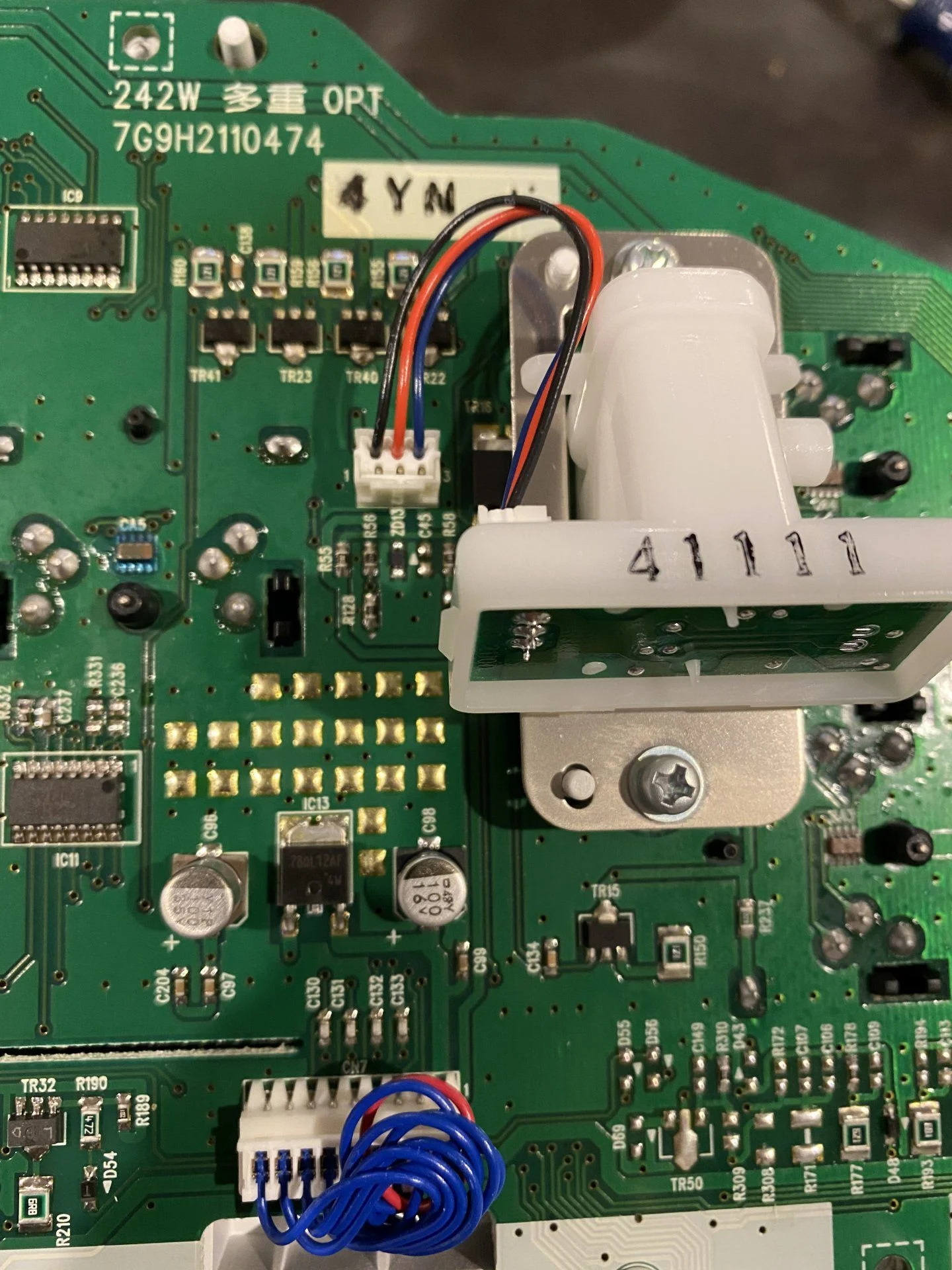

Indeed the stepper motors are not the root cause at all, at least in my case. In fact, all stepper motors are actually good and working, and this was proved by swapping them back and forth between good and bad "spots", ie between speedo (good) and tach (bad). The actual problem is the "spot", not the motor.

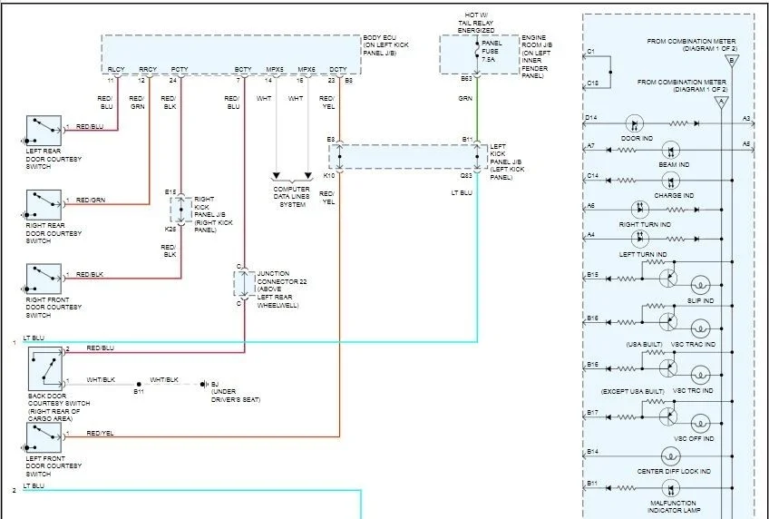

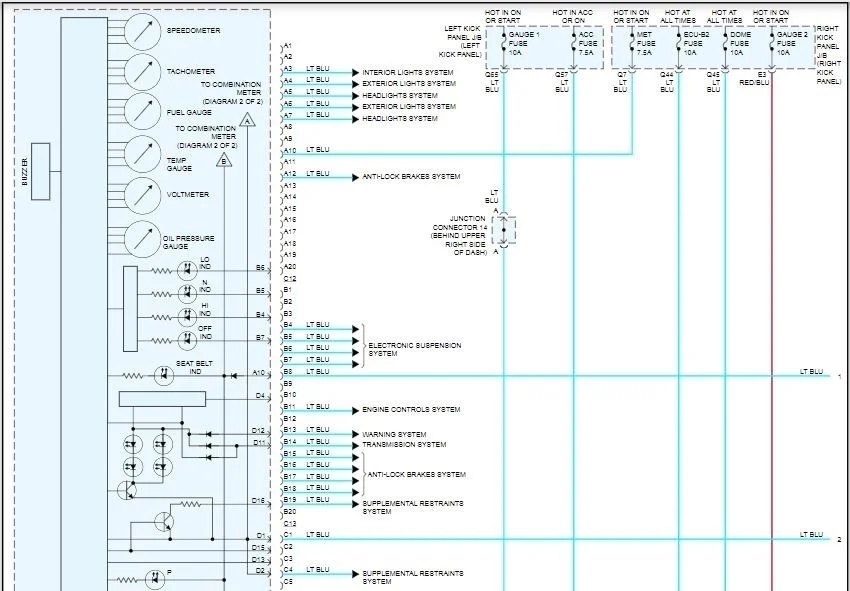

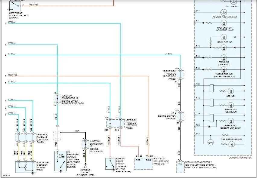

Very interested in this thread, I love a good detective story. My LX is a 2000 model with nearly 3k on it, with no combinaiton meter problems whatsoever (knock on wood). I thought I'd post the 2000 EWD info, for the sake of completeness.
Very nice @Myers thank you.
Interesting.... it is just me or the solder joints on CA7 and CA8, and to a lesser degree CA6 look suspect? By comparison CA3 and CA4 look a lot better.
@AFei - I assume your swapping involved desoldering and resoldering?
@Myers - Thanks for the photos. I can't see any caps swollen or leaking, but I'm still having a hard time not being suspicious of them. This will be interesting.
if I was guessing, c3 and 4 weren't replaced. OR he got better at it by then. But the rest were replaced or re flowed.
There are better experts on here that know all about that though hole and smd stuff.
Why is the STAR+ right of C7 so burned looking? That right there is why I wouldn't take money for fixing through hole mount stuff on boards. I cannot solder like that consistently. His doesn't look so consistent. Who am I to judge any of that. IF it works, it works I suppose.
I wash I had better pics of my 2006 board.
Update:
Well, as expected, tach went out again. Resolder didn’t work.
Just to be clear, nothing was replaced on my gauge, only resoldering on some places.
