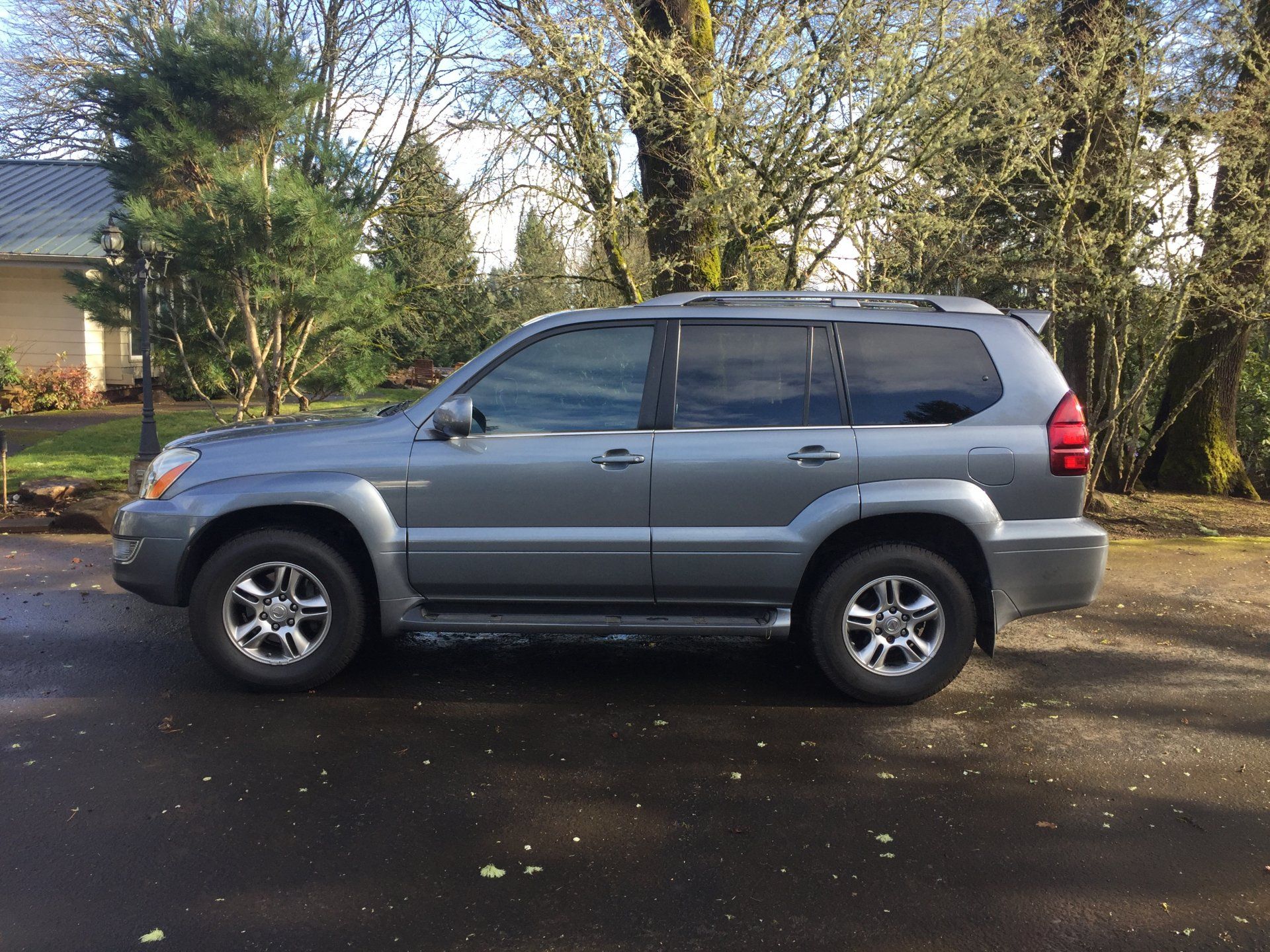

So I'm ~$435 in on these and the ride is awesome. Been in the GX for a couple weeks now and it's fantastic. They haven't bottomed out a single time, that I've felt. If you look at the profile of the GX, the rear appears to be slightly taller than the front, but you have to be looking. Not a big deal: I don't tow or haul huge loads.
I do feel like there is more roll (I think that's the term?) when cornering. It feels like there is a bit more lean when cornering. But nothing huge.
I can't tell if the Lexus lean is in play. I suspect the SSO kit helps with that. The mechanic mentioned that it may happen after driving\settling occurs, but I haven't noticed it. And I kept the spacers so we can remedy that pretty quickly.
At any rate....just wanted to get a simple write up with every purchased part out on the interwebs. If this helps one person save money trying to replace that crazy airbag spring system...totally worth it.
After a few months on the FJ rear springs, and the SSO kit (mentioned just above)....I love it.
While I'm still bugged that I blew >$4k trying to replace the stock system last year. But
I'm happy with the results and I'm looking forward to replacing the electronic shocks with a proper conventional solution.
You'll notice the rear end appears to be on the high side, but it rides great!
