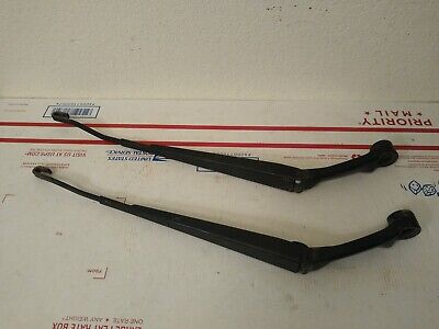

I bought this item on ebay
2003-2009 Toyota 4Runner Windshild Wiper ARM ARMS​
When I tried to put them on my fj60, the base where the bolt and the cap goes was too wide to fit. It caught on the black bezel around the wiper arm bolt.
Did I order the wrong ones? Did I not get the part I ordered?

View attachment 3114343View attachment 3114341View attachment 3114343View attachment 3114346
Yes they’re wrong. You need 3rd gen arms. 96-02. 03-09 is 4th gen.
Whenever I see a 4Runner wiper arm thread, I can't help but mention that I went to the wrecker and grabbed a set of wiper arms from a 1st gen Nissan X-Terra for $15. They work great on my FJ62.
