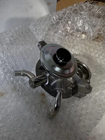

With the colder weather, I am also noticing that I am getting air into the fuel... and the likely culprit is the fuel filter housing with the primer pump. The original with the heater attachment is no longer available, so I settled for the new replacement without the heater as there is no other choice. I did hit Dave Stedman up to see what he could find and if there was anyone selling reseal kits for the older ones. He found NADA.... :(
So I now have one of these on the way in case anyone else comes across this issue on their machine:
Great write up on the install. Did mine when I got the bumper on and did nearly the same though I think I ran mine through the rubber grommet.
The heated primer is still available actually as I just received two in the mail this past week. Part number: 23380-17461
